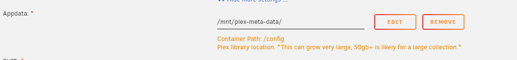

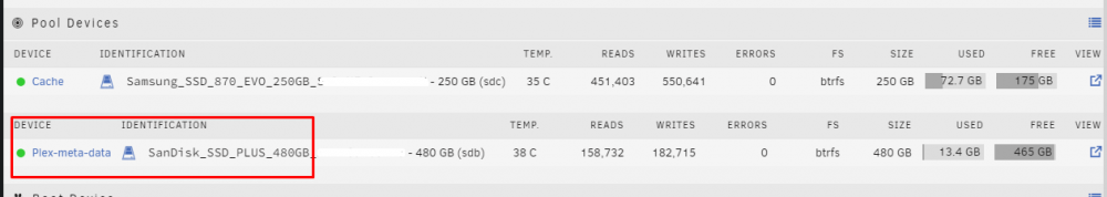

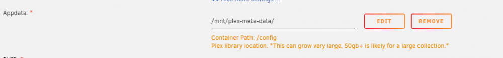

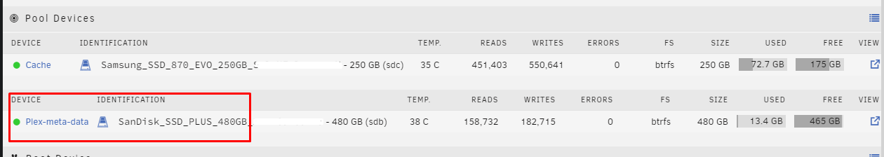

i think i got it is that it? (im using this SSD Drive in a pool for my plex mata data)
if that is the problem how do i use this pool for the mata data without this problem happening any more?
and thanks for the help :D
Quickest way would be to change /mnt/plex-meta-data/ to /mnt/plex-meta-data/appdata/plex/ , assuming your appdata share is not set to move or overflow to the array. Attach diagnostics if you want better advice.

Yep, /mnt/plex-meta-data/appdata/plex/ should work fine.
Before you change it though, you should probably go to the shares page, and click compute on the appdata share. Apparently there is some data from that share on disk1, it should probably be moved to the cache pool if there is room. You should look on disk1 in the appdata folder to see what's there.

16 hours ago, JonathanM said:
FTFY
Yes, should have called out pools specifically as well.  Thanks for the correction.
3 hours ago, EnderDeath said:
 there is 6B of data how do i find it?
6 Bytes is probably not consequential, but if you click on the view button to the right of Disk1 on the main GUI page, you can browse what exactly is in the appdata folder and make a decision on whether it seems important or not.
how can i configure /mnt/plex-meta-data/appdata/plex/ without bricking plex?
Short answer, stop the plex container, move all the files and folders that are currently in /mnt/plex-meta-data into a newly created /mnt/plex-meta-data/appdata/plex/ folder, change the host mapping on the plex container, start it back up.
There are many different ways to move data around on the server, are you familiar / comfortable with one in particular? mc at the console would be my pick, there is a newly launched plugin that adds file management into the main GUI view buttons, and there are ways to move data directly over network shares as well, but that could possibly cause other issues.

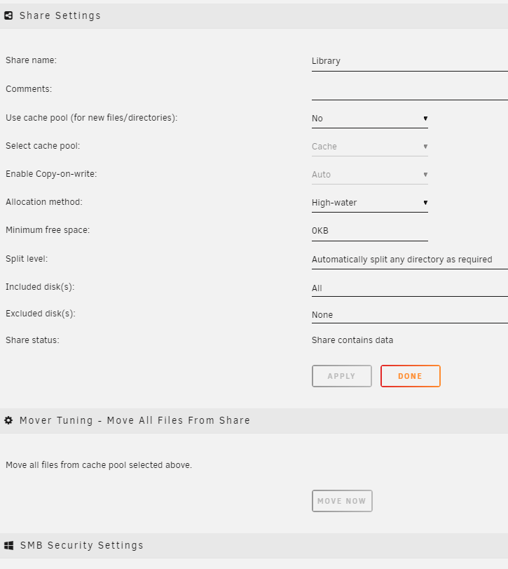

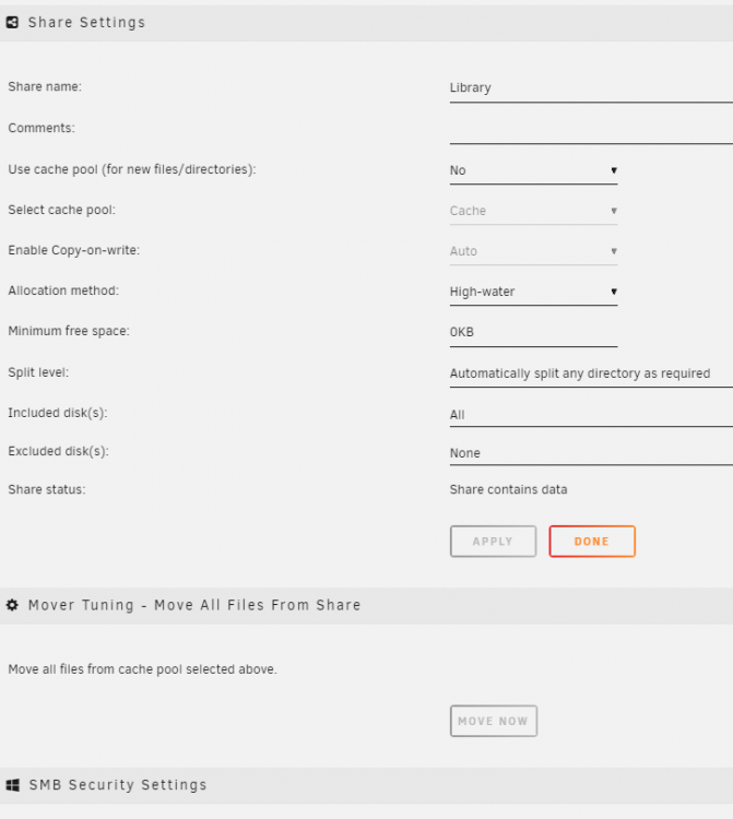

Go to the shares tab, click on the Library share, and verify the settings are correct.
i think its ok
14 minutes ago, EnderDeath said:
i think its ok
It will work that way because you are writing specifically to /mnt/plex-meta-data/Library/appdata/plex/, but if you or an app writes to /mnt/user/Library/appdata/plex/ it will go on the array and stay there. Turn on help and read the description for "Use cache pool".
You really need to work through how this stuff works so you can understand what went wrong originally, and how Unraid decides where files written to user shares are sent, and how user shares and disks / pools interact. I recommend watching Spaceinvader One's youtube on Unraid shares.
i think its ok
No, you have it configured to write files to the array. (no use pool). You want it prefer (or only) plex-meta-data pool

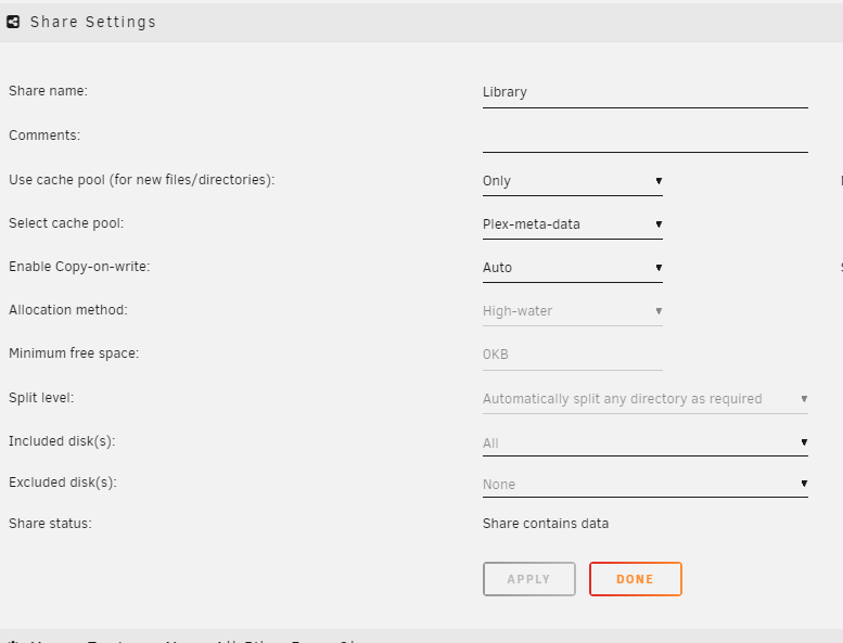

ok I watched the video so I think I know what I set up wrong ( I'll leave a link incase someone who is looking at this in the future wanna see the video )
I hope how its configured is ok now
tnx for the feedback
