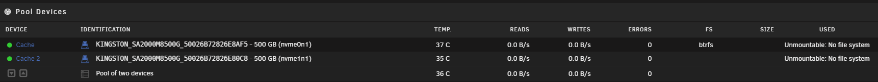

Woke-up in the morning to find my cache pool offline.
upon checking found that the system is showing under fs "btrfs" and also "Unmountable: No file system".
Attached is a screenshot along with the diagnostics file.
Since I have Company data, have not done anything to the system as yet.
Any Help would be appreciated, Thx.

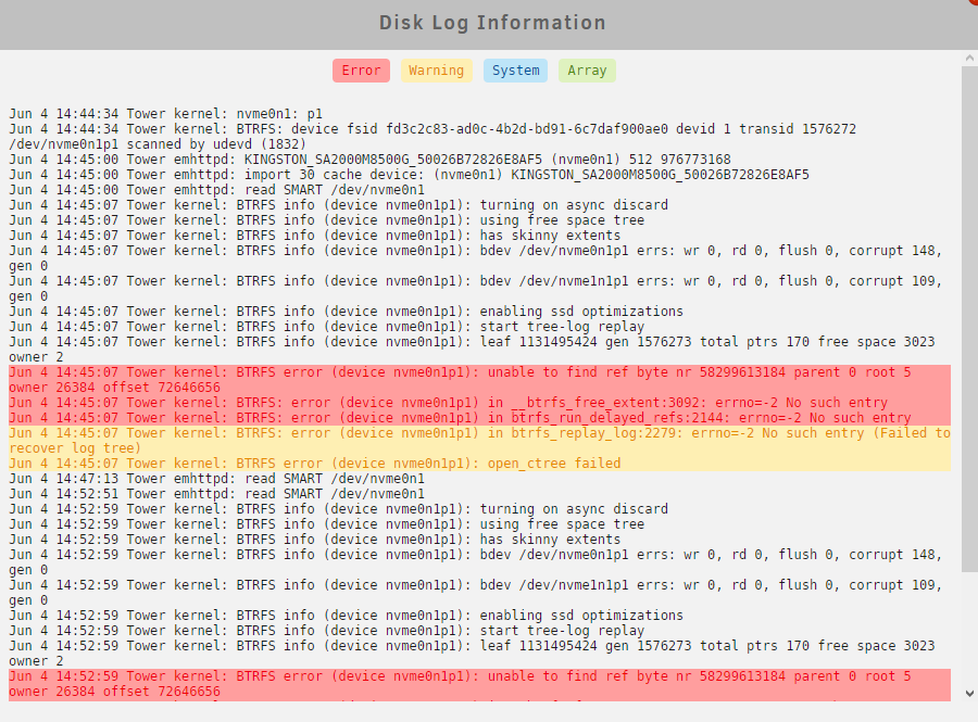

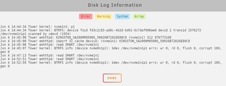

attaching 2 more files cache log info for main and mirror drive
First thing you should do is set the RAM to the max officially supported speed for your config, which is 1866MT/s, not 2400MT/s, Ryzen with overclocked RAM is known to in some cases cause data corruption, and btrfs was detecting some, after that still a good idea to run memtest, then there are some recovery options here.
