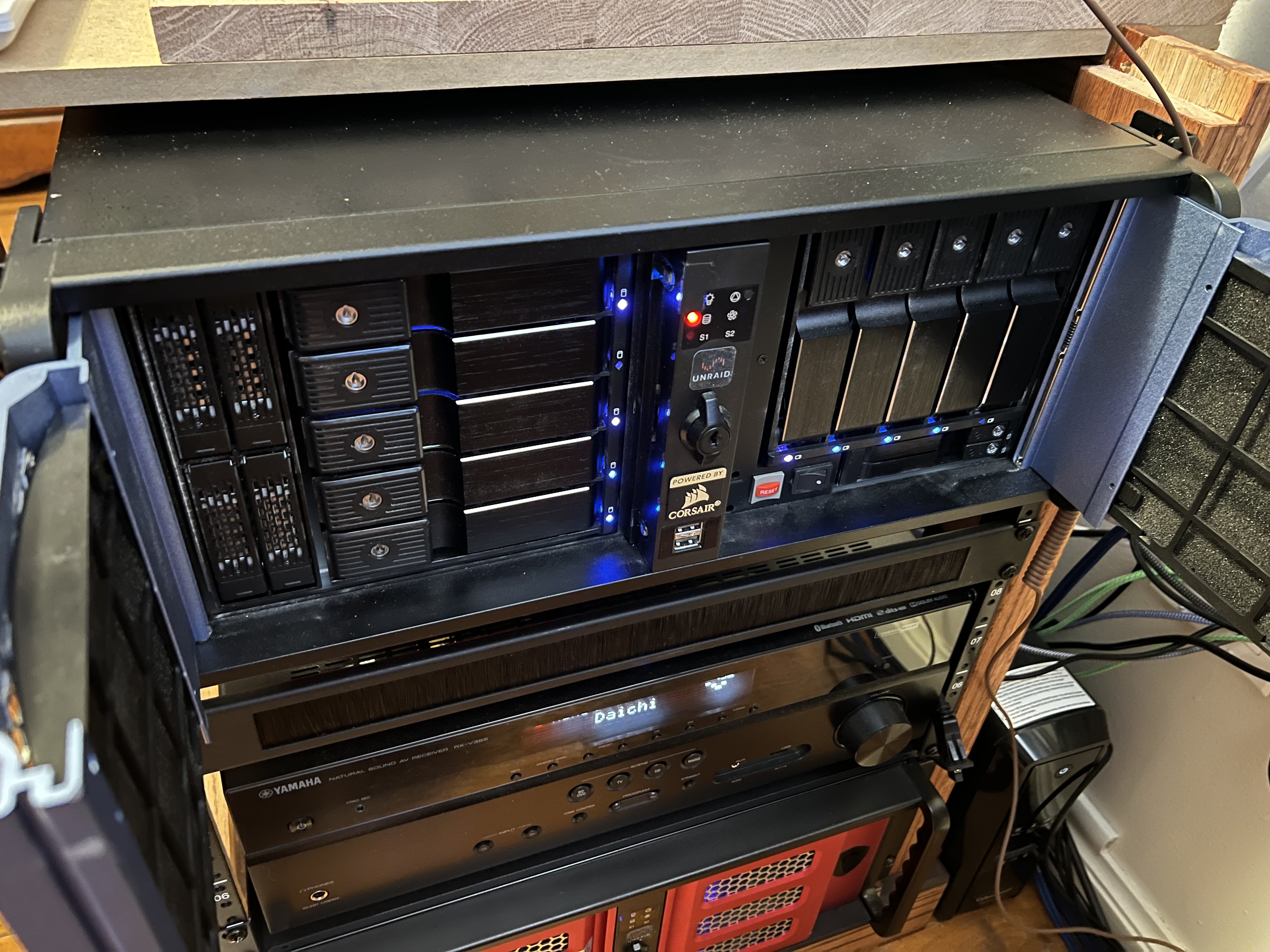

  1. MiniSAS cable replaced.
  2. New 16TB drive put in to replace the parity drive in my primary server.
  3. Old 16TB drive put into my backup server, precleared, then added as a second parity drive.  No new CRC errors, parity building.
  4. My second new 16TB drive added to the primary server to expand storage space, taking place of an aging 4TB drive.
  5. Data moved from three other 4TB drives onto the new drive and some data being moved from three other 16TB drives to balance them out a bit.
I then have one 4TB drive unused at the moment.  I plan to buy an external trayless enclosure to attach to my backup UnRaid server via 8088 cables, so that when drives are taken out of my primary, they help to expand the storage pool on my backup server.  I have a Pro license on my backup server and the Plus license on my primary server.  I'll upgrade it to Pro at some point, but I don't need to do that for a while.  I have 10 drives total in that server, so I have three 4TB drives to eventually replace and room for a couple more drives before I upgrade.  Growth beyond the 10 will probably be 2.5" SSDs.
