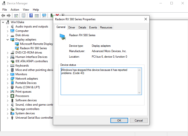

July 15, 20224 yr Author Hi again ChatNoir, since adjusting the RAM speed, my server uptime is ~29 days 14 hours now. ~2 days ago, the GPU passed through to a VM stopped working. I kinda suspected that my system crashes were related to the GPU (RX580) somehow, but cannot confirm. I've attached the syslog here, don't think there's anything about the GPU. So the current situation is that, the VM (with the GPU passed through) is still running, I can RDC into it and everything work, just that the screen attached to the Unraid server is not showing anything. But Win10 is reporting issues (see screenshot). In the past, I have used SpaceInvaderOne's script to reset the GPU, and more recently I tend to just shut down the server and restart it. I have left the server running for 2 days now since the GPU "crash", and it appears to be stable. Regarding the GPU, I followed SpaceInvaderOne's video on dumping vbios, and passing it through. I don't think there's much of an issue there, plus if I were to restart the server, the GPU would be working again. So my question is, what should I do to further diagnose the problem here? ~3-4 weeks seems to be the magical timeframe when the GPU experiences issues, and that's also the timeframe past unraid reboots have happened. Should I keep the server running for another month and see if it crashes? unraid syslog 20220715.log
July 15, 20224 yr Can't help you for that as I do not use VMs. But hopefully someone has something to say.
July 16, 20224 yr Author Hi again, Thought I'd give an update and close this thread. Thx again ChatNoir, I think it helped a lot with the RAM speed dialed back, resolving that instability issue. Since then, the Unraid server crash problem feels more like 2 separate issues compounded together. It was very telling when the GPU crashes, and the VM and the Unraid server remained operational. I found this thread, https://www.reddit.com/r/Amd/comments/pf4ebr/figured_out_a_fix_for_the_rx_580_intermittent/, it sounds like the RX580OC crashing is a common problem, and coincidentally also relates to the OC clock speed (similar to the RAM speed issue). So since my last post couple days ago, I went ahead and rebooted the server. I followed the instructions in that thread above, installed Adrenalin (the install required many reboots, and RX580 kept crashing, and install wouldn't progress unless it detects a valid GPU... so had to reboot the server quite a few times...). Anyhow, it's now installed, and I used it to manually tune the GPU clock to the base speed of 1257MHz, did a stress test, and nothing crashed, phew. So that's where I am now. Let's see how long the server can run this time without issues (I'm quite hopeful actually).
