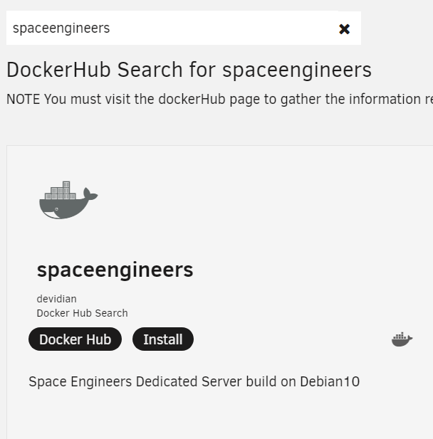

Hit Install and then have CA attempt to determine as best it can the paths / ports / variables it uses as a starting point.  Then add in anything else (Add another path, port, variable on the template page) for whatever it couldn't determine based upon the instructions on dockerHub / GitHub etc.

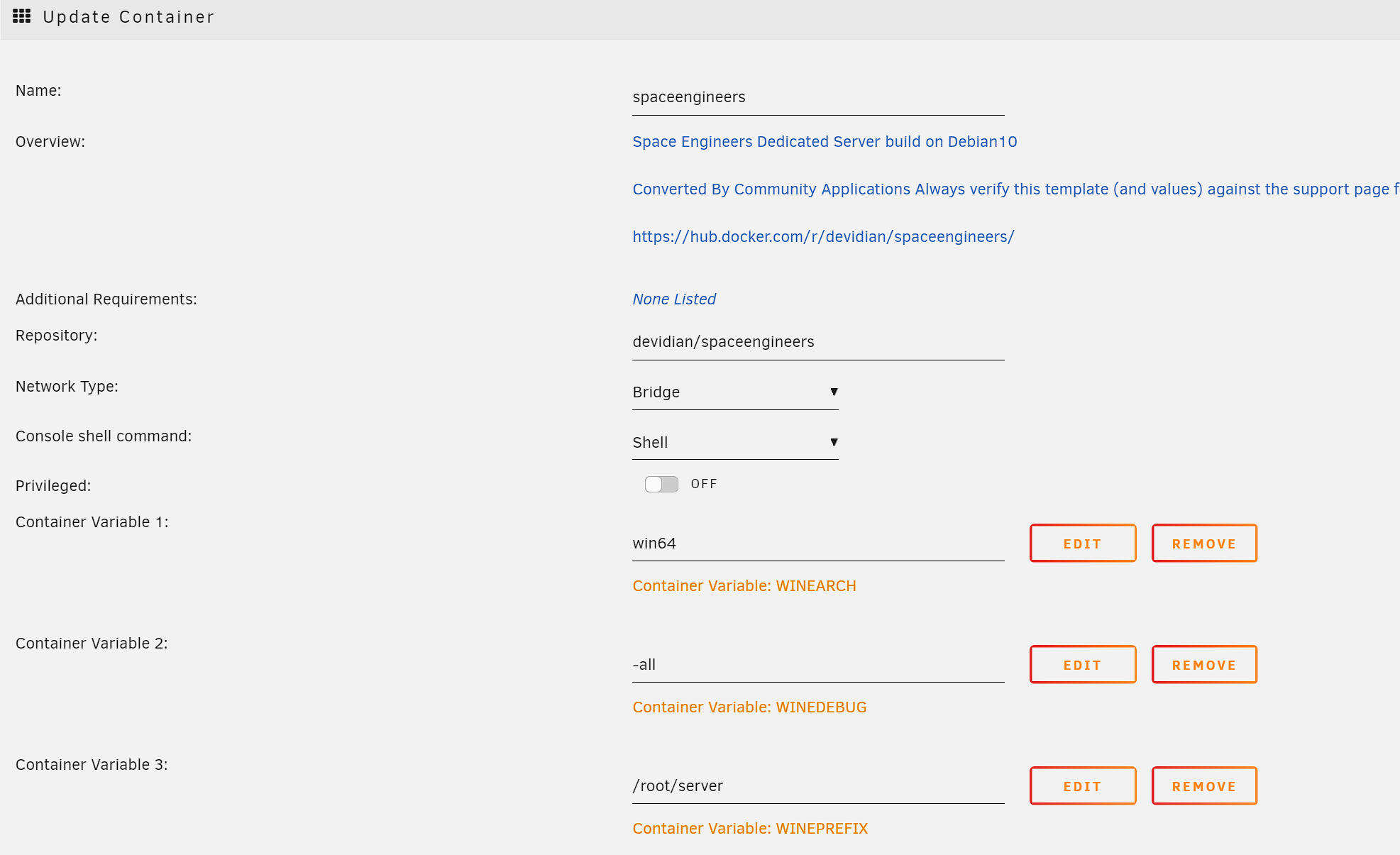

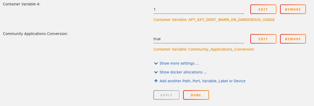

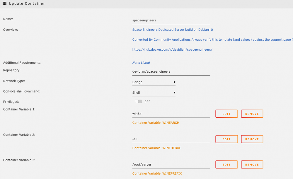

I have installed the container and let Unraid see what it could find in terms of paths. Here is the install that it made
I now have it installed somewhere, but do not know where. Other containers show me that they are installed in the appdata share.

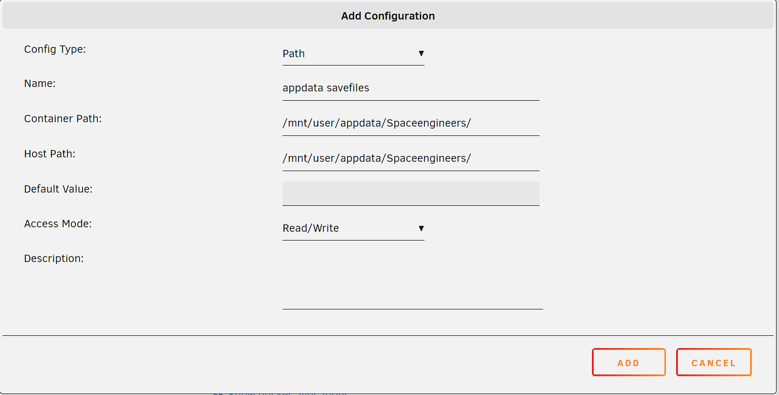

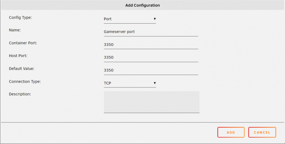

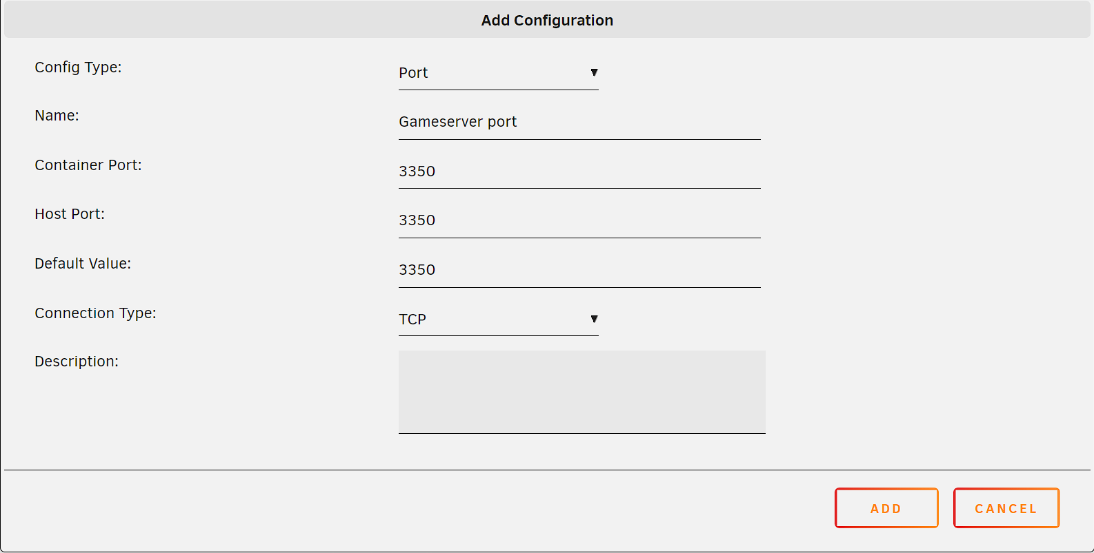

Anyway I am adding a path to the appdata share and adding a port that I want it to run on

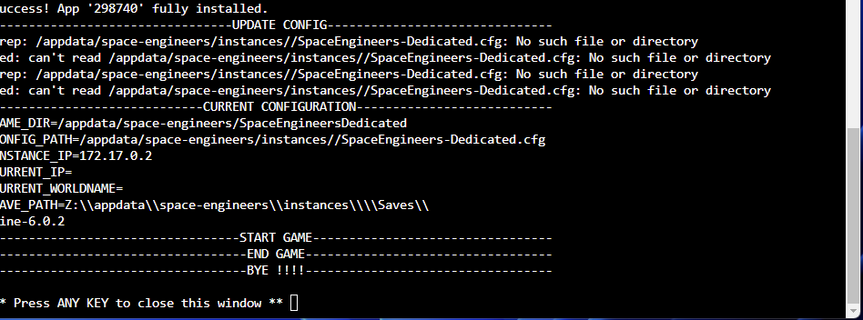

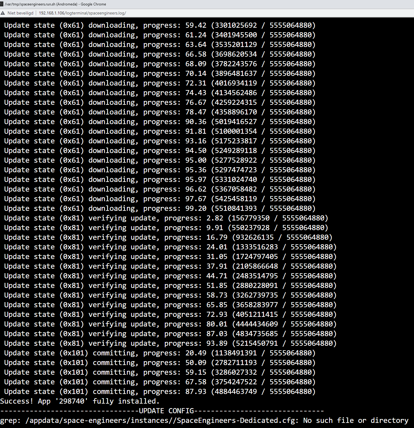

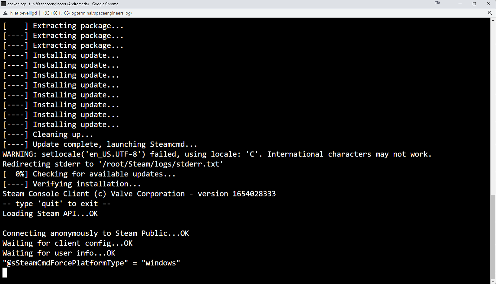

Then I restarted the container and looked at the logs.
I see that the container is looking for a path in Windows, but that doesn't exist on Unrai.d Does this mean that the container has to be modified to work on Unraid? I don't know how to do any of that, so that would make this a lot harder for me (and many others that want Space engineers running in a container on Linux)

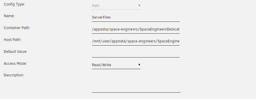

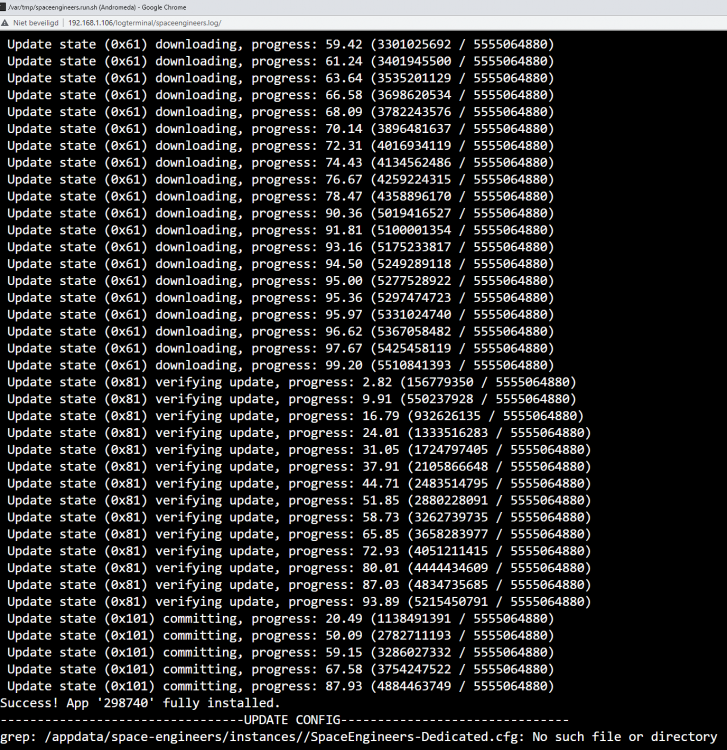

I tryed the same, and now im stuck. I managed it to get installed in the right folder. Now under /mnt/user/appdata/space-engineers is full with the Serverfiles.
But a that point it should start the Server i got this.
Edited by fiR3W4LL

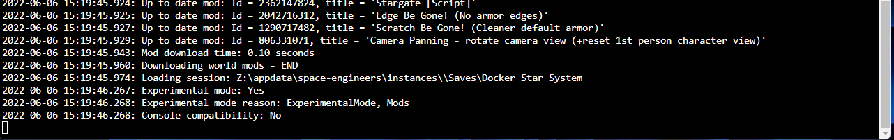

Could manage it to start, but only until this point.
The server should be done when it promts Game ready..... but after a while..... this wont happen :/

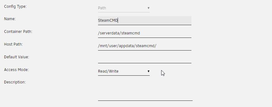

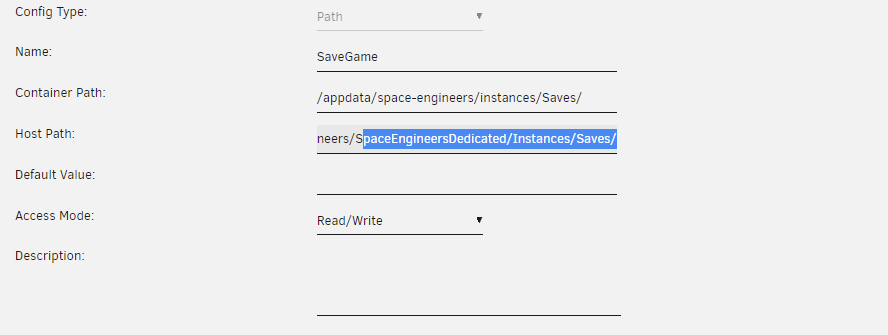

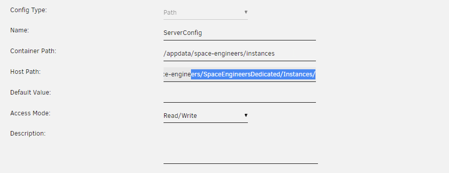

How did you get it to look at a different save path?
Here are the Paths

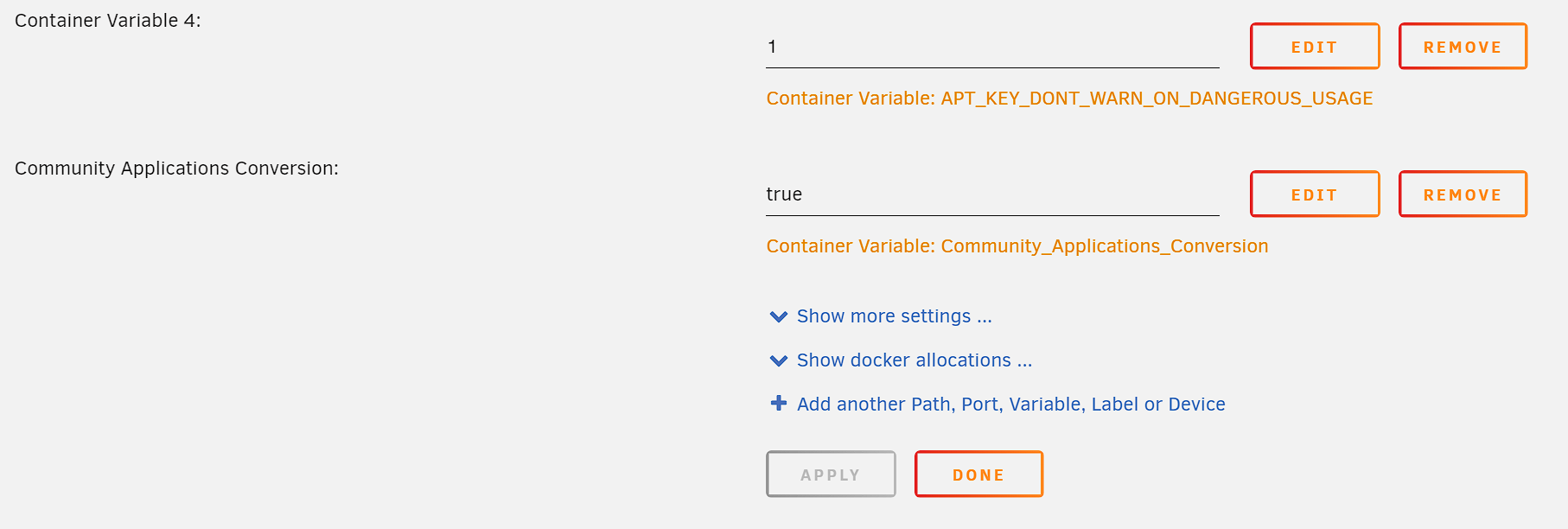

1224637675_2022-06-0721_42_20-UNRAIDVM2_UpdateContainer-Vivaldi.png.f68d4a8f6c14a896dbb64baf640575be.png1628847149_2022-06-0721_42_03-UNRAIDVM2_UpdateContainer-Vivaldi.png.d78a559b79b82649fc85ce752586310e.png1860770878_2022-06-0721_41_48-UNRAIDVM2_UpdateContainer-Vivaldi.png.67c3cb9d95b6e91eb1a618e59e0e80c6.png166658655_2022-06-0721_42_29-UNRAIDVM2_UpdateContainer-Vivaldi.png.f1f64e739330299b16c1a5acff4000d2.png
GOT IT :D
