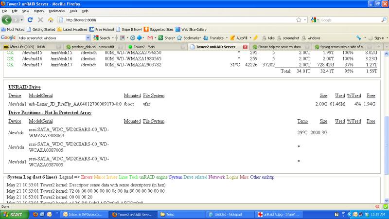

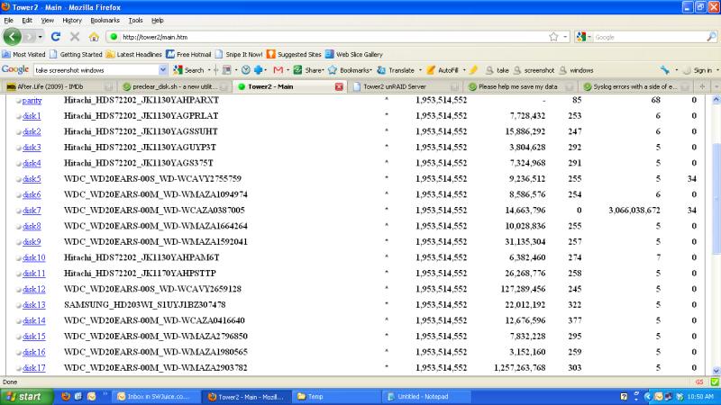

Tried to preclear a drive yesterday and it failed, it tried to run and went through all the steps but the disk failed to pass. OK, maybe the drive, so I popped another in and preclear would not run due to invalid partition or something. Did another and preclear just hung there and would not run at all. So I reboot my system and go back to it this morning. I see over 3 million writes on disk 7. I bring up unmenu and now see I have 2 more partitions on disk 7 that weren't there before.
So now I have 2 unknown partitions for no reason and I still can't preclear a drive on the 5th row of drives. That row contains my parity drive and drive 17 which both seem to be fine. I can write to drive 17 but it is slower than what it should be but not too bad. I get speeds from 25 to 30 MB/s where I would expect slightly over 30 for the other drives in that system.

It appears disk7 is not in the array anymore. Maybe it got dropped-out due to write errors. A syslog might give more info.
sdu refers to the drive and sdu1 is the partition on the drive.
It appears dis5 is also having issues of some sort, with 34 write errors on it too.

Now no more extra partitions on disk 7 either.
I have no idea as to what is going on.
