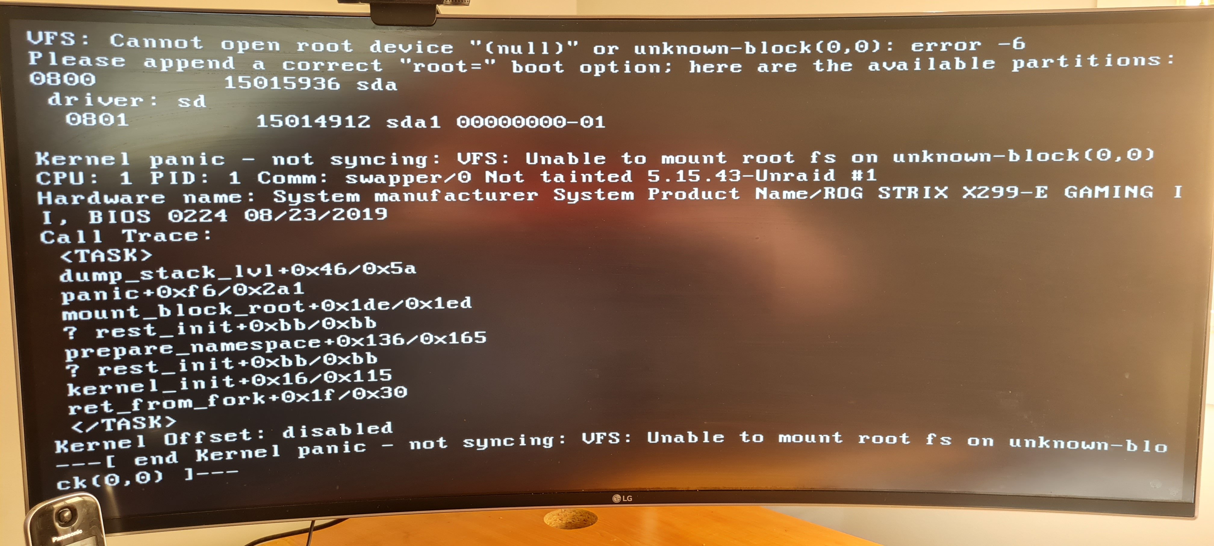

OK. Deleted pcie acs override=multifunction and when I boot I get the attached screen
UPDATE:
In the last couple of days I've had trouble expanding the iso directory tree to select the vbios, sometimes it wont boot, I wonder if my Sandisk is on the way out?. Replacement is on my To Do list, so I guess I better Do sooner rather than later?. I live in Australia, everything takes forever to get delivered, so it might be a while before I get my new USB and continue with my trouble shooting.
It seems so. Kernel panic refers to the flash drive.
