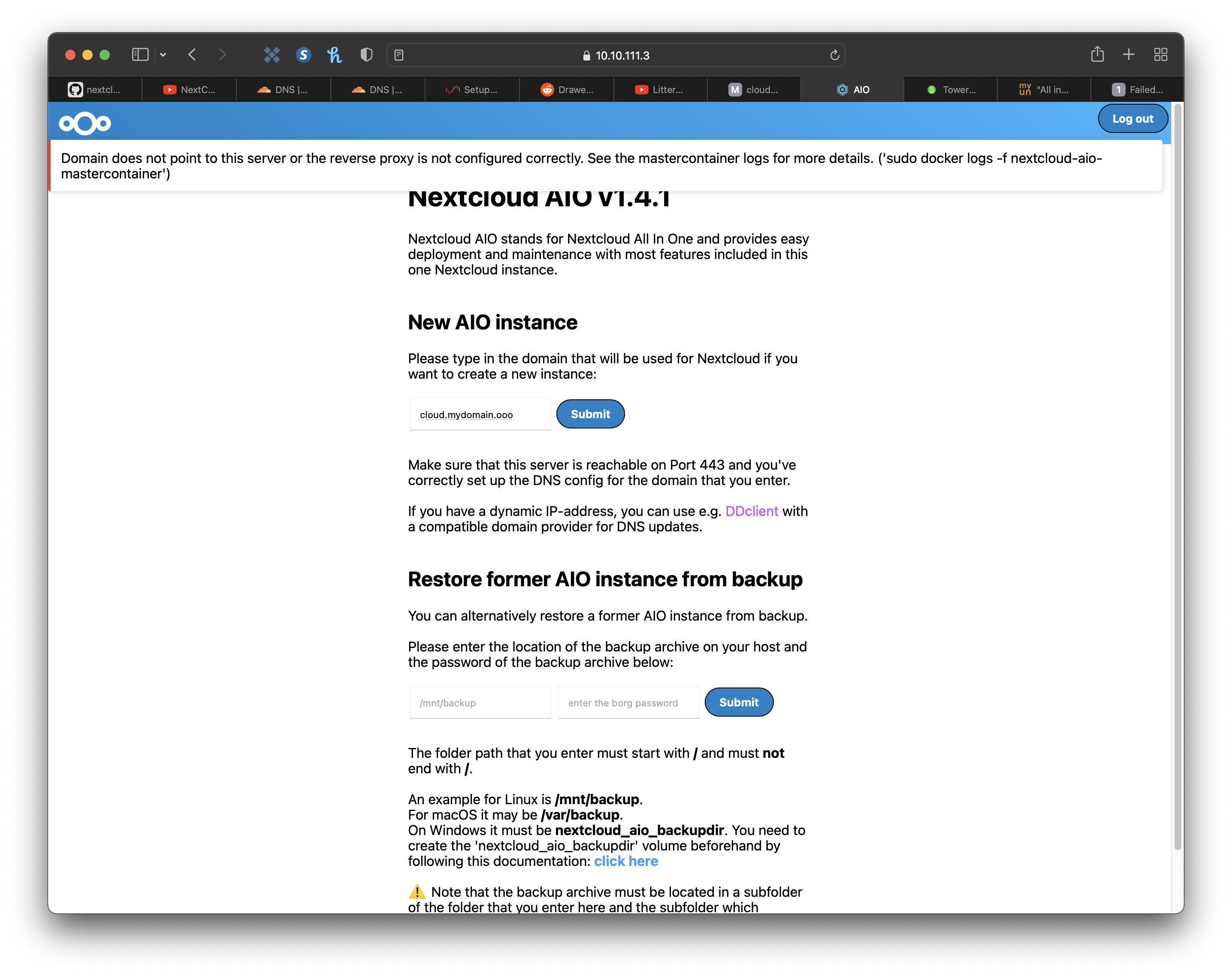

I have been trying to setup nextcloud AIO for weeks now but I am unable to get it working.

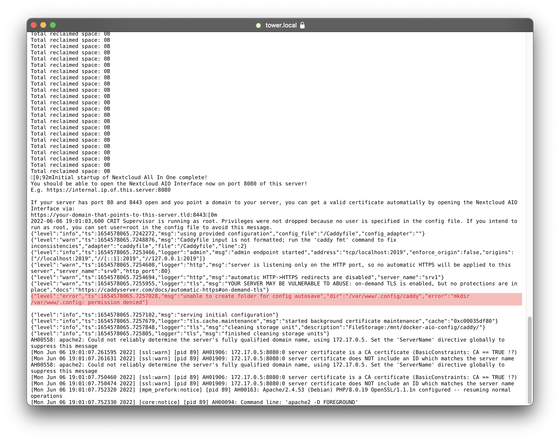

Looking at the logs it see :
I'm not sure how to fix this and I'm not sure if it causing my issue.
I get a error, DNS does not point to this server error.
If you are getting a DNS does not point to this server error you have issues resolving the domain you have entered.
So either port forwarding is incorrect, or DNS is not configured correctly.
Unfortunately that was as far as I got with this app... The created container nextcloud-aio-nextcloud is complaining that the AppData folder has moved since the installation (I'm sure I didn't as I didn't have it running in the first place..

Thank you. That document really helped out. I changed the folder rights before starting the installation and everything is running fine now.

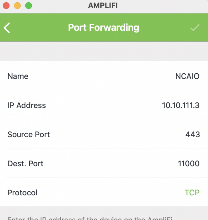

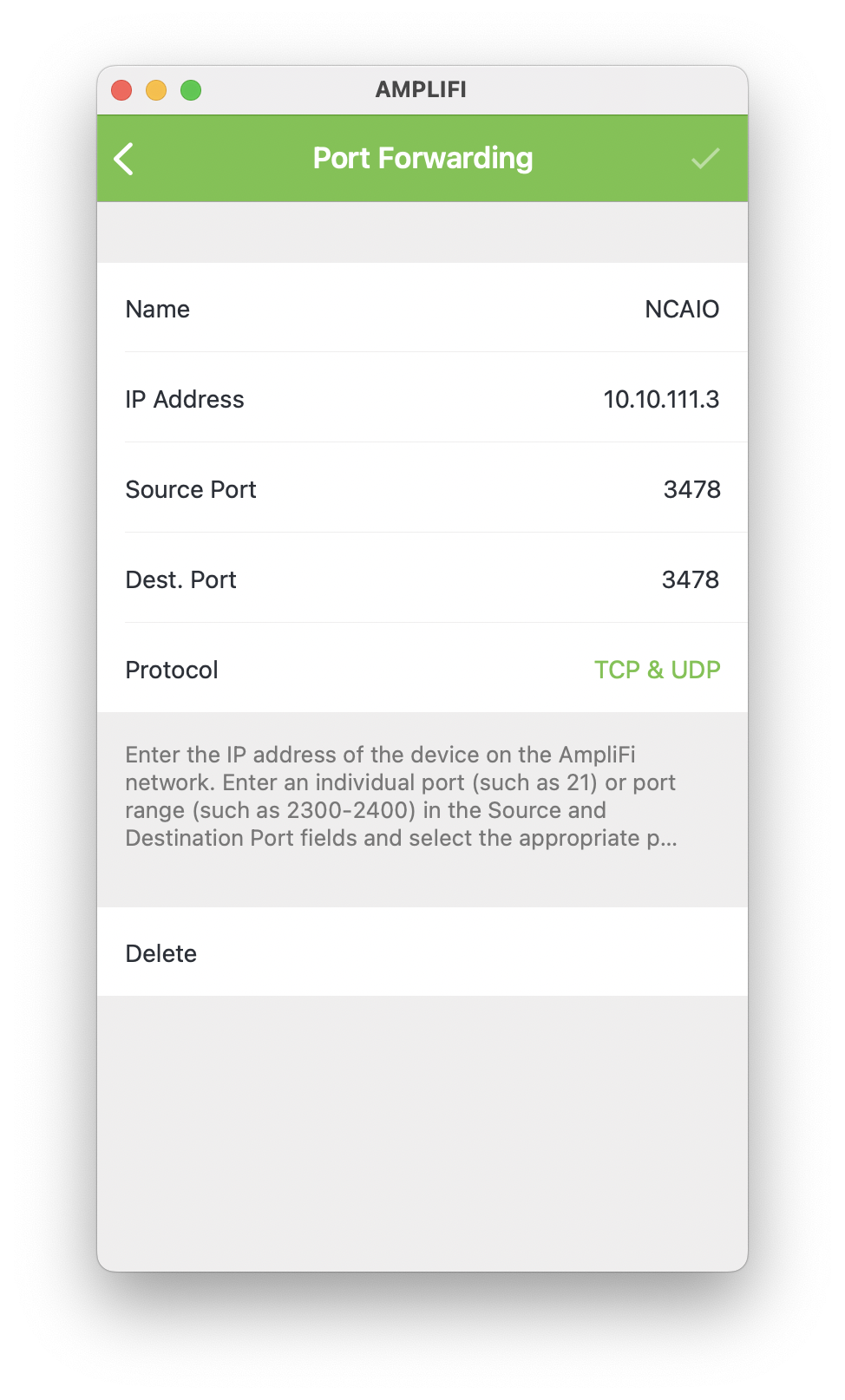

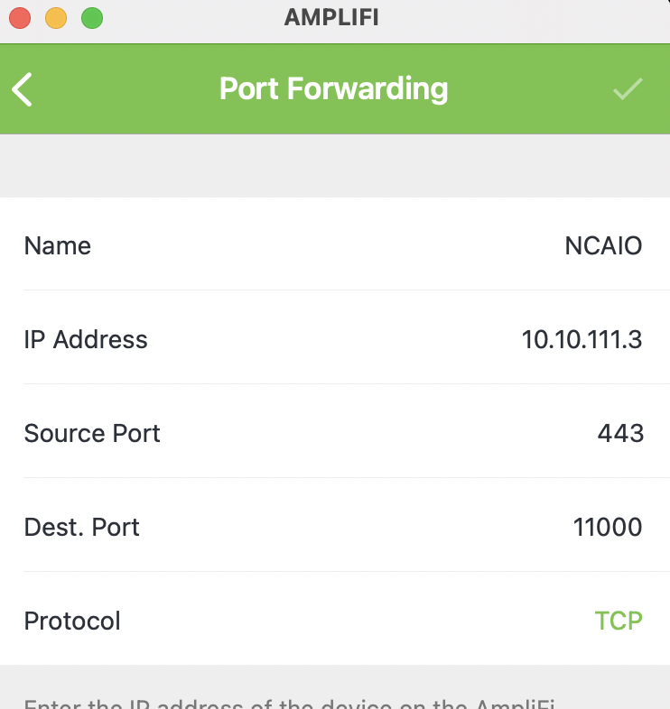

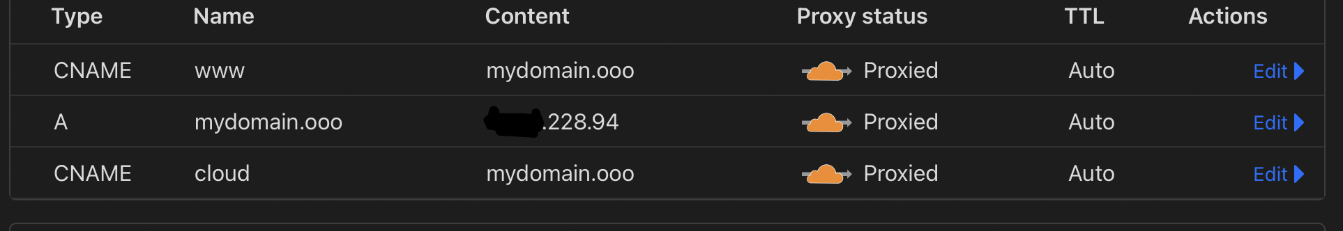

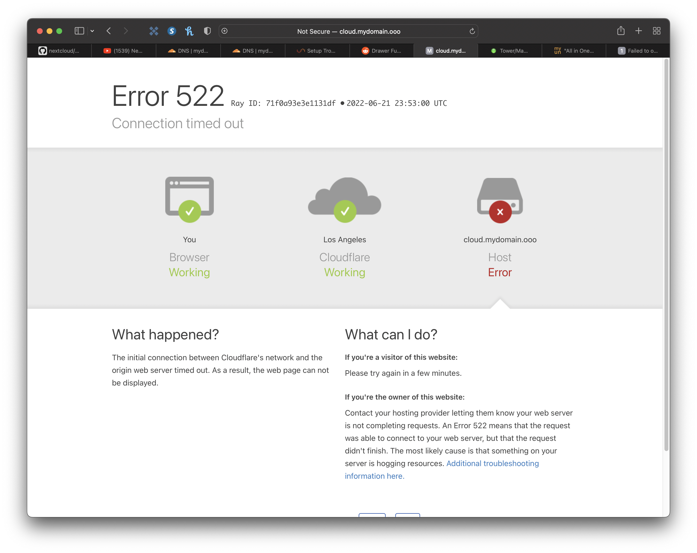

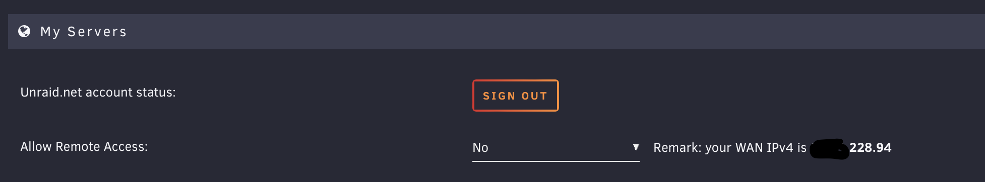

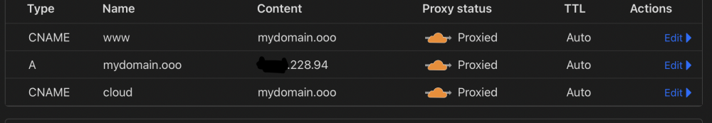

When you get to the setup page, after initial login, do I put "CNAME.domainIown.com" or "CNAME.ddnsdomain.com"?

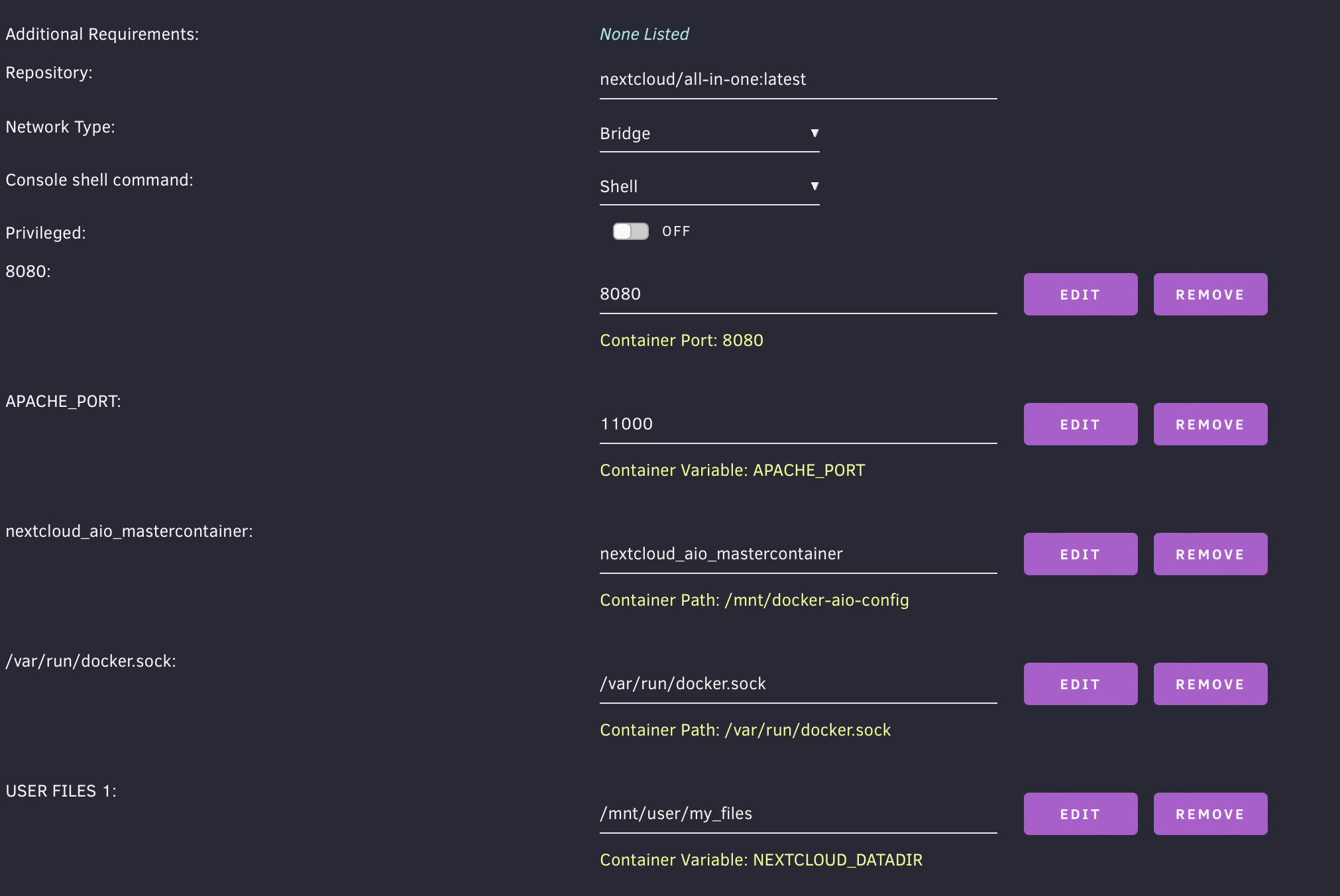

I must be missing something. I attached all that I can think of that might be helpful as to what the problem could be. Since you have yours up and running, many you could identify what's different?
image.thumb.png.ed21cd0a355b8ebc9ad71ca5a6283386.pngimage.thumb.png.ba89a11587db6d1302ff28fea74c1a9a.png
I figured out what my issue was. I have been using NginxProxyManager for other Nextcloud containers but nice I was having issue getting my AIO working, I removed the containers and I forgot SWAG was required to also be installed. Long story short, I installed SWAG and was able to get a SSL certificate and then the AIO install went smoothly.
