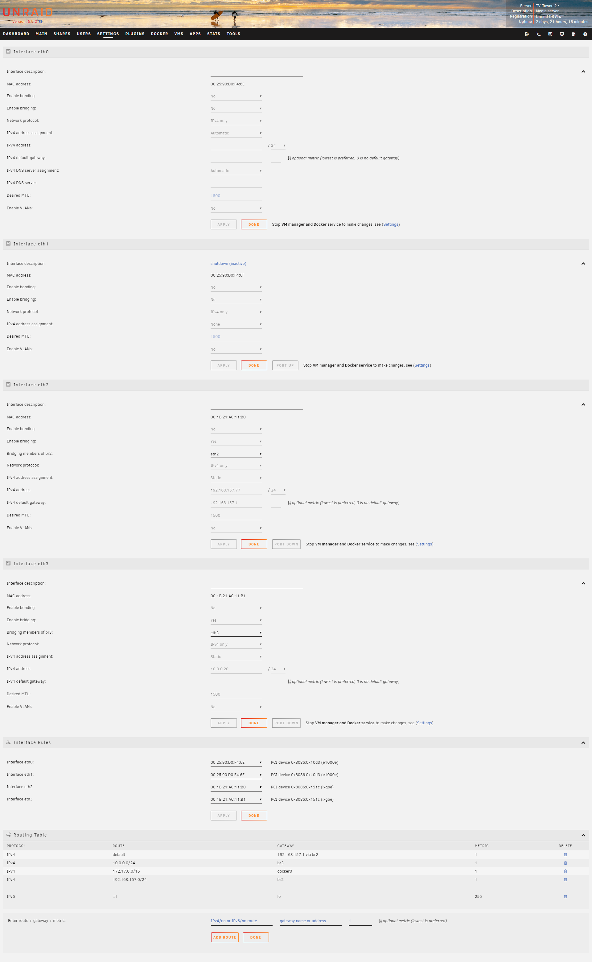

What does not work: I can't seem to give eth2 a DNS server, this appears to be only possible to eth0
675827071_TV-Tower-2_NetworkSettings-192_168_157_77.thumb.png.69794453416159d52828110e5f5a1bac.png
How do I do this?

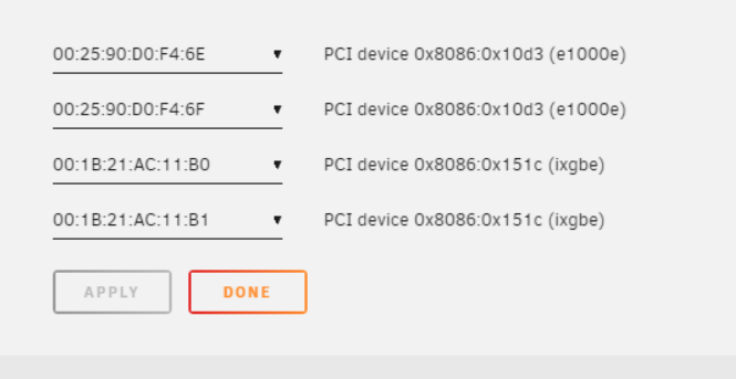

You can change the eth assignments in the interface rules, set the main NIC as eth0:
Reboot required to take effect.
JorgeB, Thanks.
That did it. Didn't know it was so simple...
