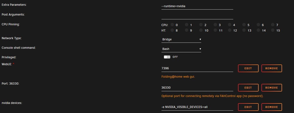

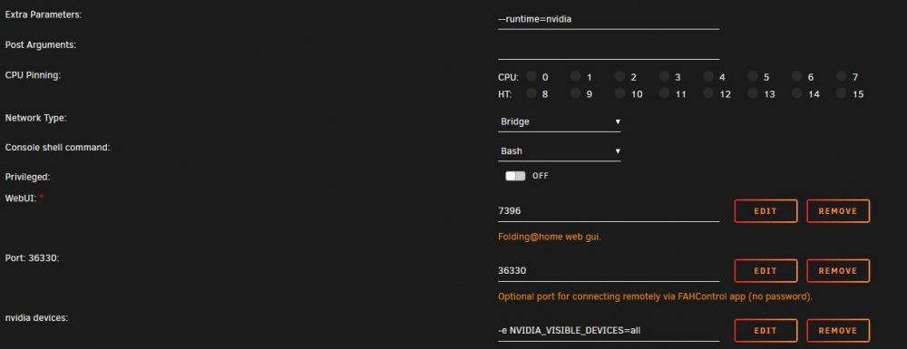

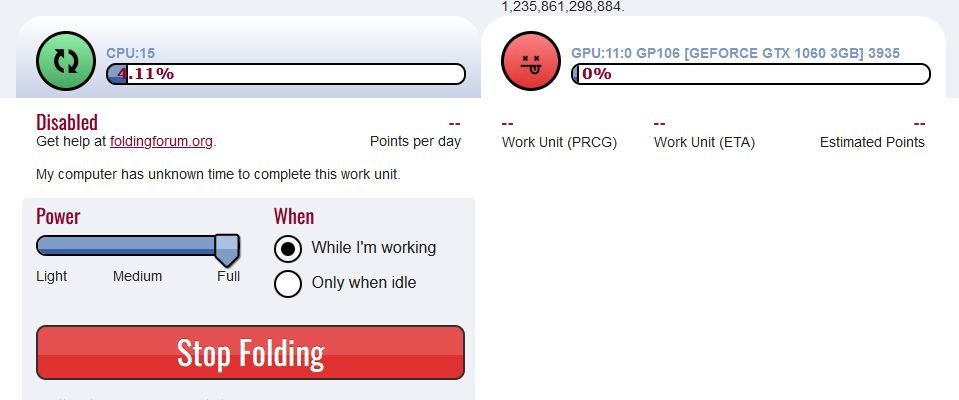

Again, I followed SpaceInvader One's guide to setting up F@H but the GPU is showing as disabled. I've attached screenshot 1 and 2 for reference. Checked my settings and they seem OK, but I can't enable the GPU, even via FAHControl.

Quick update on the Folding @ home settings, I was seeing this in the logs which relates to GPU drivers not being passed through to the container.
01:16:21:FS00:Initialized folding slot 00: cpu:14
[93m01:16:21:WARNING:FS01:No CUDA or OpenCL 1.2+ support detected for GPU slot 01: gpu:11:0 GP106 [GeForce GTX 1060 3GB] 3935. Disabling.[0m
This was using the linuxserver build. I've since switched to the mobiusnine version and that seems to be working properly. Now I'm only left with the question of the VM passthrough...
