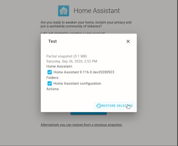

This is how HA says you can do it that it doesn't show for me
You need install HA first, i.e. download QCOW2 image from official then restore the backup.

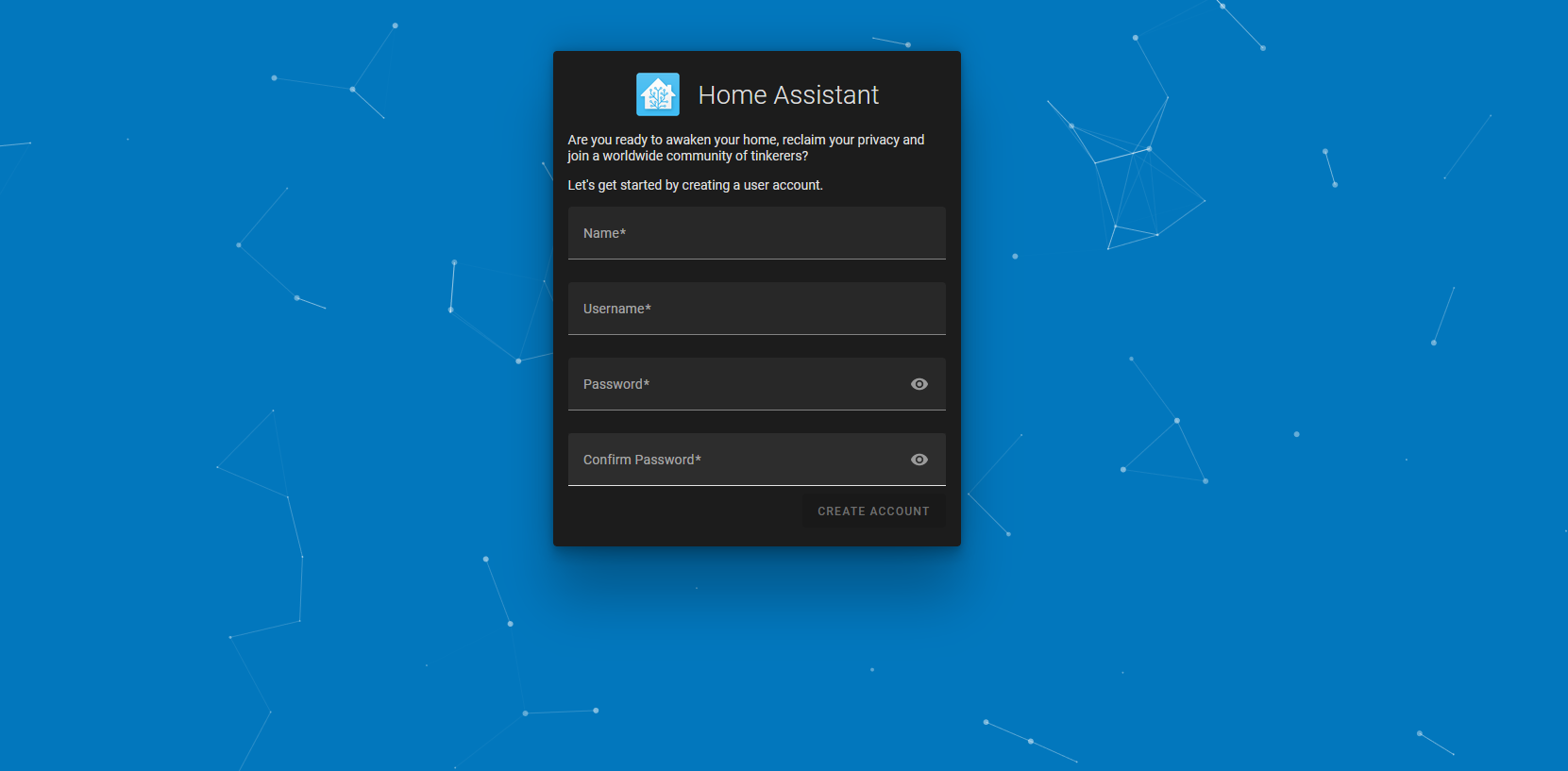

19 hours ago, Vr2Io said:
After you install Apps ( docker ) what have you see in welcome page ??
I see this on the welcome page right after install of the docker:
it just tries to take you though making an account and setting your timezone, no botton to upload a backup .tar file or anything like that sadly.

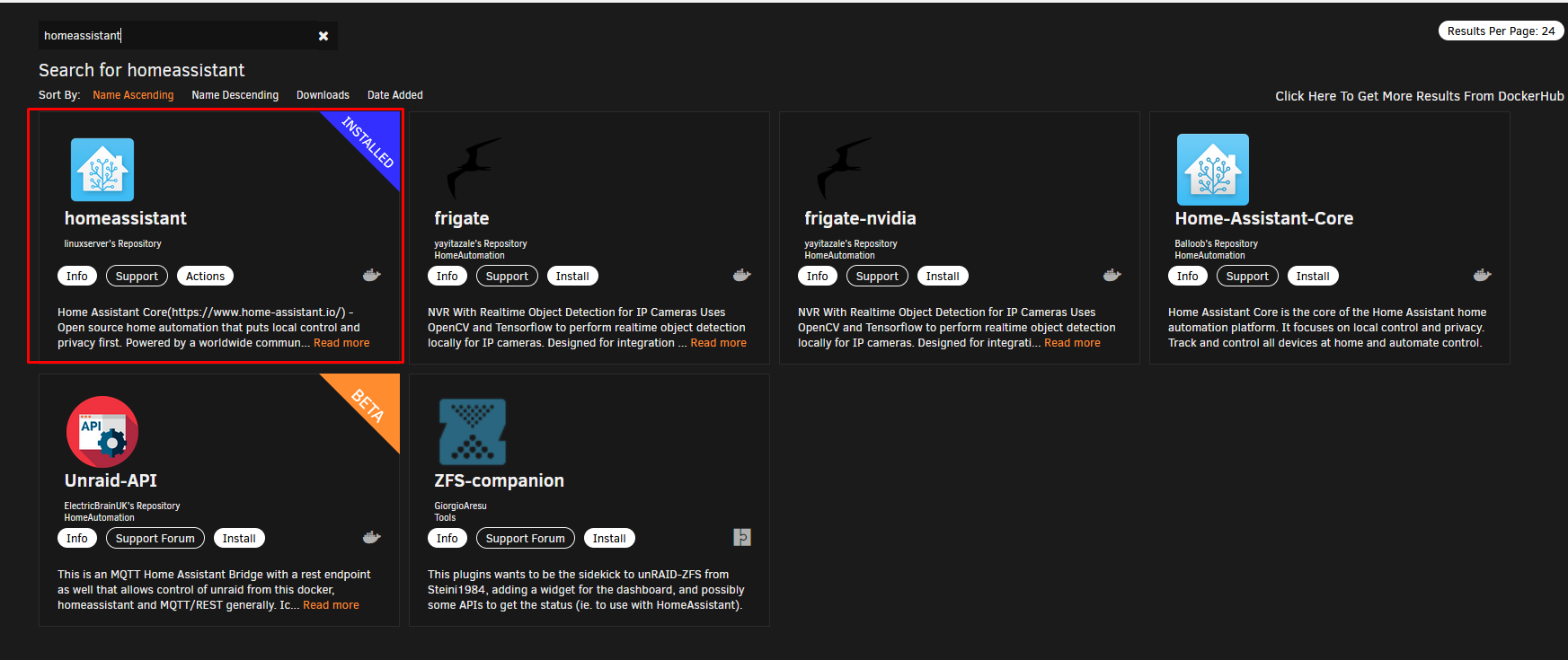

This is the install I have used on the apps page in unraid - image.thumb.png.54b801361200030f58e9e457799775ca.png
5 hours ago, ArxKnight said:
It just tries to take you though making an account and setting your timezone, no botton to upload a backup .tar file or anything like that sadly.

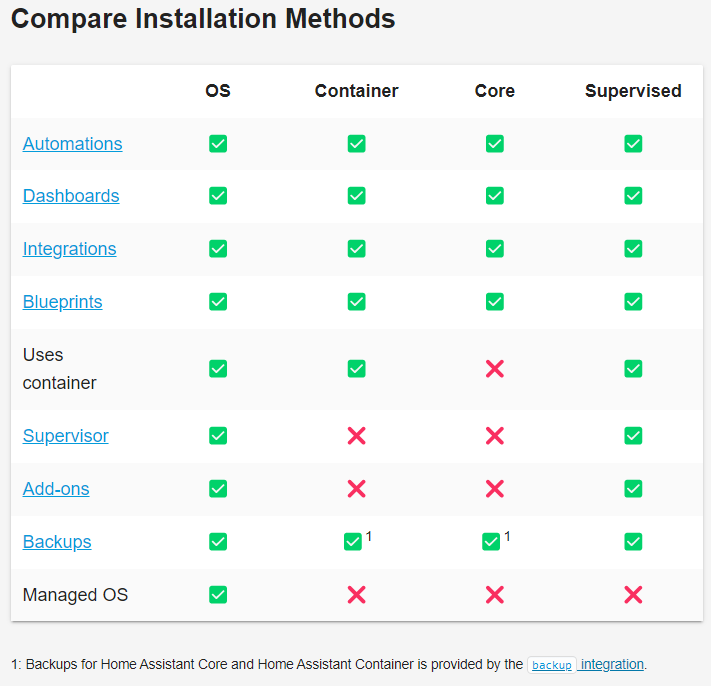

BTW, it look like normal as below post, seems you need Supervisor for backup/restore function ( but your backup content still look different, current Unraid APPS seems not exist anymore )
Pls also ref. below info.
https://www.home-assistant.io/common-tasks/os/#backups
https://community.home-assistant.io/t/supervised-on-docker/425635
I haven't much idea about HA docker,  large different vs HA VM.
