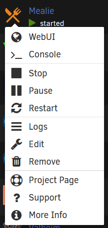

I used to be able to click a docker icon, get a dropdown, and from that dropdown, i could click the web gui link to open the docker's web site.
That doesn't appear anymore. Is there a place to enable that or is this an isolated issue for me?
I've attached an image of what I now see.no-web-gui.png.cef0f1e3097c30926a17f0f607c86793.png
That's weird, I just installed the container, changed no options and I do have the webui option.
Your diagnostics might show something, even if I am not sure.
Any error on the container's log ?
Are you using the stock bridge network for your containers?

On 6/9/2022 at 3:14 PM, JonathanM said:
Depends on how you have the container configured.
Any tip(s) on how to configure them?
If the network type is set to bridge, I've never had any issues with the WebUI link showing up, as long as it's formatted correctly.

This is how they are formatted:
http://[IP]:[PORT]
Is that correct?

You appear to be missing the container port number http://[IP]:[PORT:XXXX] where XXXX is the port the container is listening on, regardless of which port on the host is mapped.

This is also for every container, not just that one.
I think I messed that one up. When I look at the other containers, they have the port set correctly.
