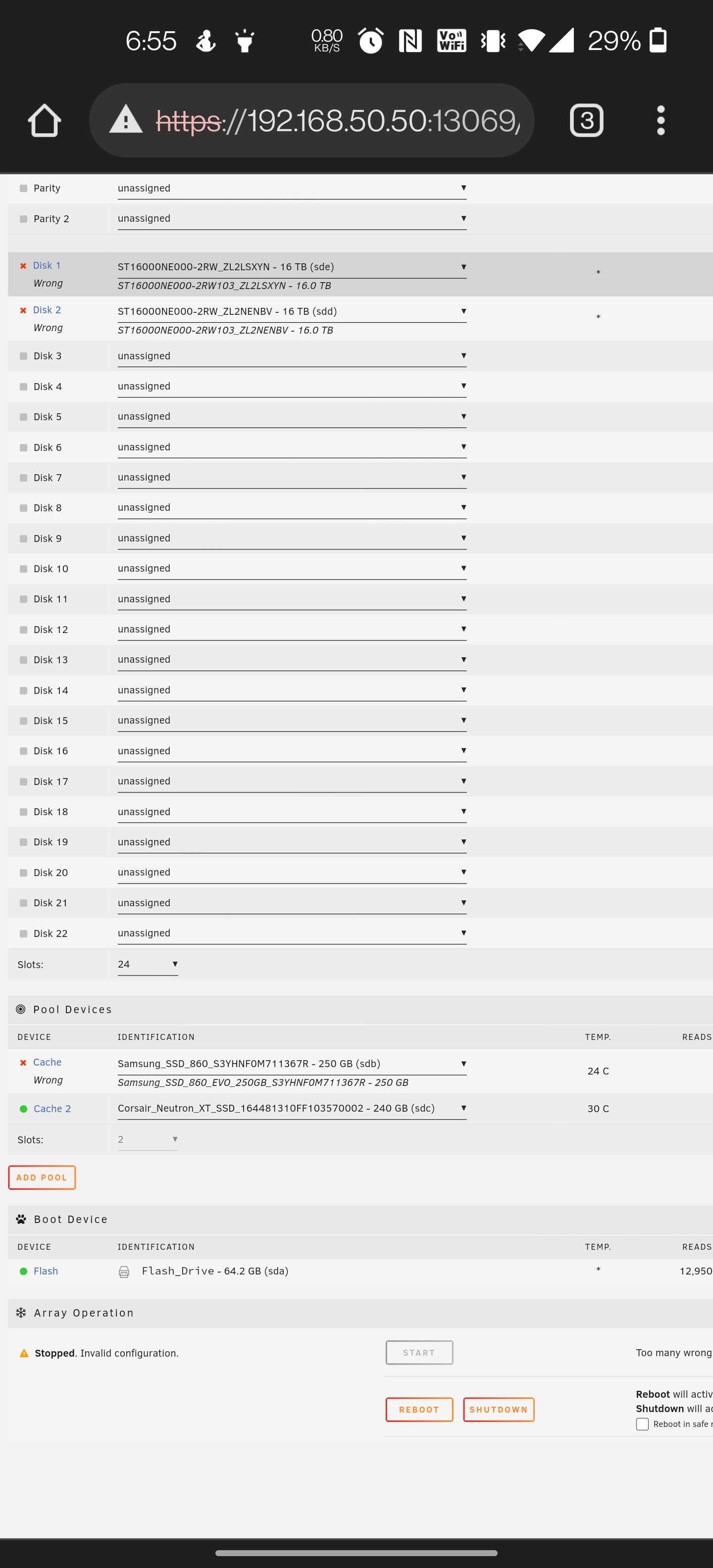

I am having an issue of the array not being able to start due to the names of the hard drives being slightly different after installing the below SAS/SATA Controller.
IBM Serveraid M1015 SAS/SATA Controller 46M0831 https://a.co/e2Ibqzj
Previously the disks were mounted using the SATA ports on the motherboard while I waited for the controller to arrive.

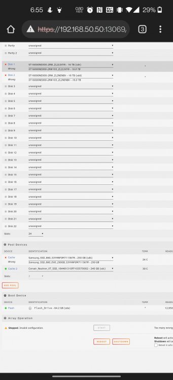

Attached is a picture of the devices not wanting to mount. It looks like the names changed just
Is there a way to resolve the issue or do I just need to get a different controller?
