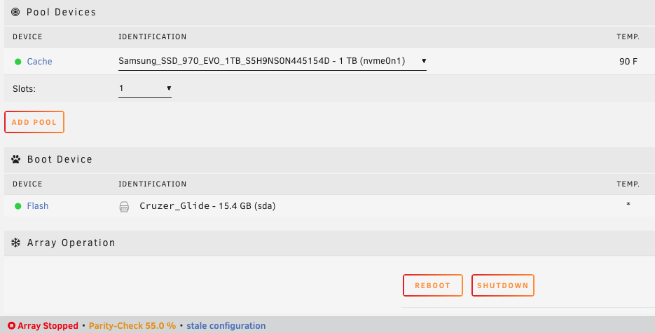

Post a screenshot of Main - Array Operation

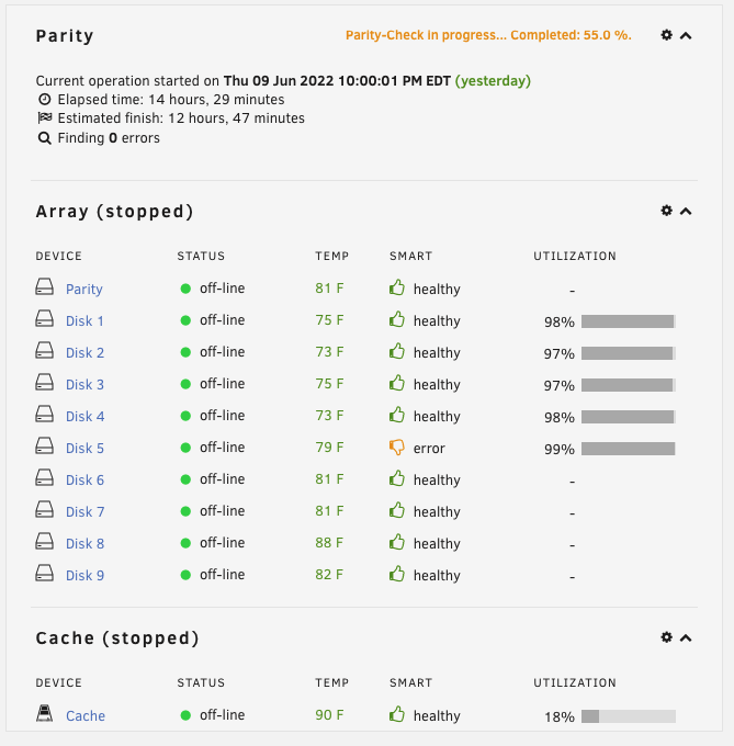

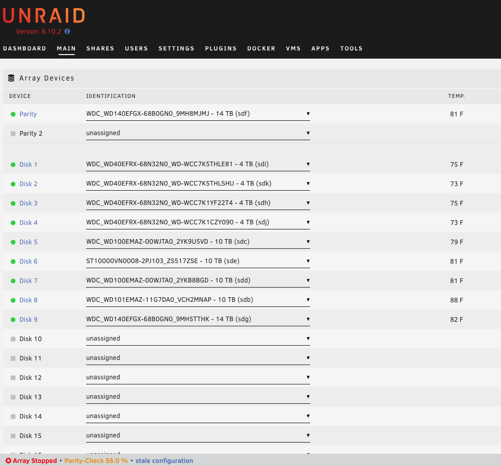

I’ve refreshed the GUI a couple times on the machine itself (hooked up to a screen with a keyboard) and on multiple of my computers on my network. There is no Stop button that I can find. Main just shows “Reboot” / “Shutdown” at the bottom of the array list. On the Dashboard it just tells me the progress of the Parity-Check but gives me no options.
Here are some screenshots demonstrating what I'm seeing.  As for the "new config" thing, I hadn't seen reference to that when looking up assigning new drives, so I didn't look at it until just now.  Seems like maybe the way I should have gone.

Those screen shots are weird - I would not have thought a parity check could be started until the array is started..    maybe you have managed to trigger some unexpected edge case (and if so it would be nice if we could work out how to reproduce it) so it could be fixed).

Not sure what the state is anyway since the screenshots indicate the array is stopped.
Also, df in diagnostics shows disks 1-5 mounted and vars shows those, none disabled, plus 6-9 unmountable I assume because not yet formatted.

Disk 5 that is in "error"
I assume you are talking about that SMART warning on the Dashboard. The only thing I see in SMART attributes for that disk that would cause a warning is a single CRC. Usually we just acknowledge those (click on the icon) since it just means the drive recorded inconsistent data received usually due to connection problem, and the data is resent so nothing to worry about. If they continue to increase you will get warned again and can consider whether to check connections.

Very confusing.
Are you absolutely sure all those screenshots are current? If you close all browsers and open a new browser to your server, can you reproduce those?

The "stale configuration" is the problem, browser is not showing actual status, make sure all browsers are closed, but I believe this is known to happen sometimes without a clear reason.
