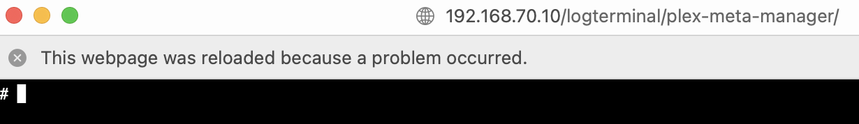

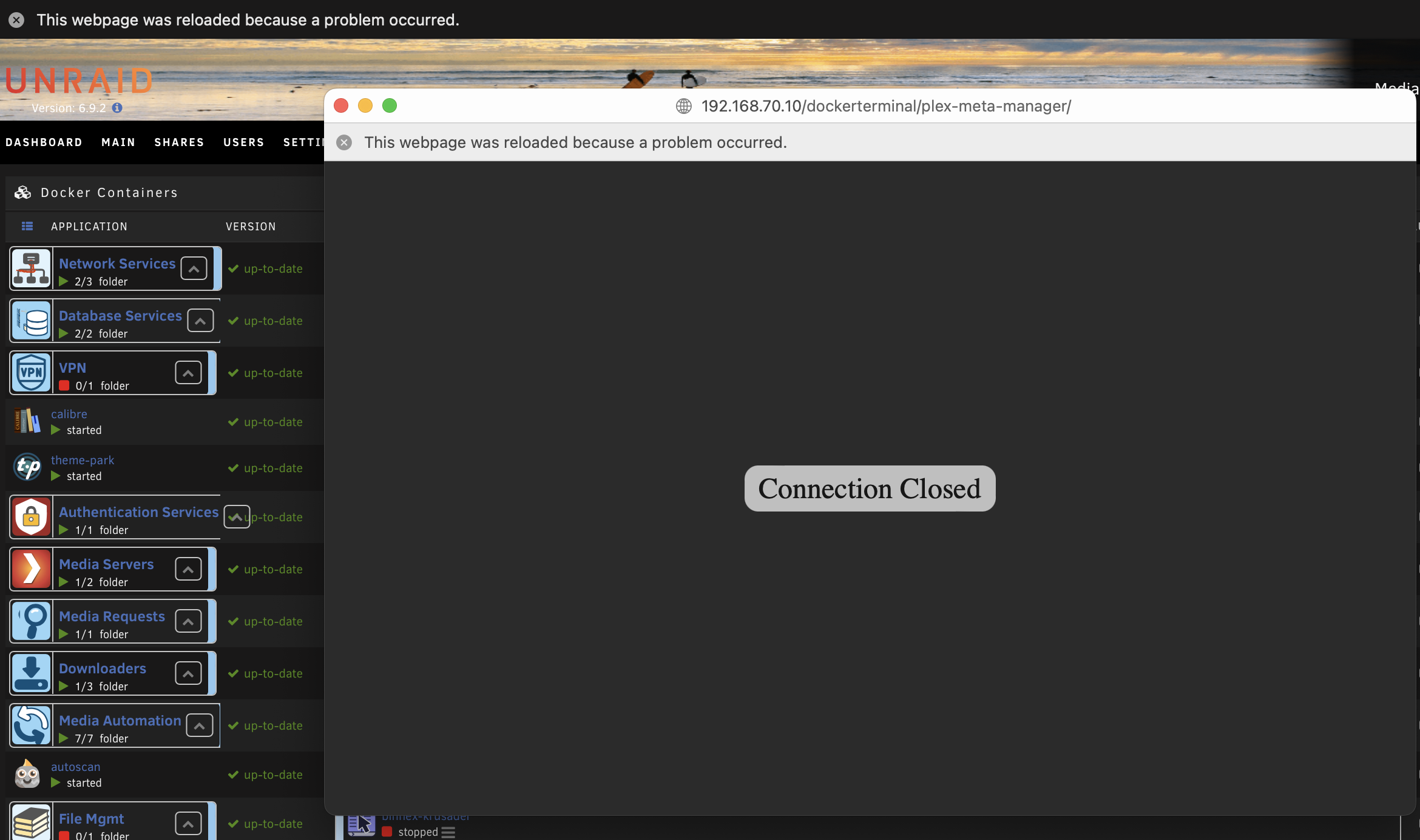

Launching the console for a docker container (Plex Meta Manager) to run a script manually, and often I get the following happen "Connection Closed" while it's running, or sometimes even when the console is just sitting there. The main page of Unraid then resets and says "This webpage was reloaded because a problem occurred."
I generally then have to close the console of the docker I was trying to interact with and the main page of Unraid and launch it again.

On 6.10.3 and it just happened.

Edited by unRAIDuser7
added image
Try clearing out the history, cookies etc.  If that's Safari and still have problems, then try Firefox / Chrome and see if there's any change (not a solution, but would be a data point for the devs)
Will try those suggestions. Yes, it is Safari.

Have not had the issue since clearing the cache, history, cookies on Safari. If it does happen again, I'll just use Firefox for this specific task.
