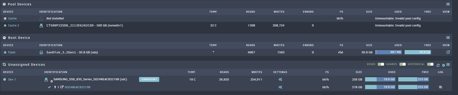

I have an existing Samsung 830 SSD that I'm using as a cache drive.
I want to replace it with my Crucial P2 500Gb M.2 SSD. It is already in my unassigned devices (see attached image).
I found SpaceInvaderOne's video for doing this. It is from 2017. Is it still valid?
Should I just follow his instructions or do the more recent versions of Unraid require a different procedure?

Thanks for the quick response!
I do have Unraid V6.10.2.
I stopped the array, swapped out the 250GB SSD with my new 500GB one and started up the array and got the error "Unmountable: Invalid pool config" (see attachment #2).

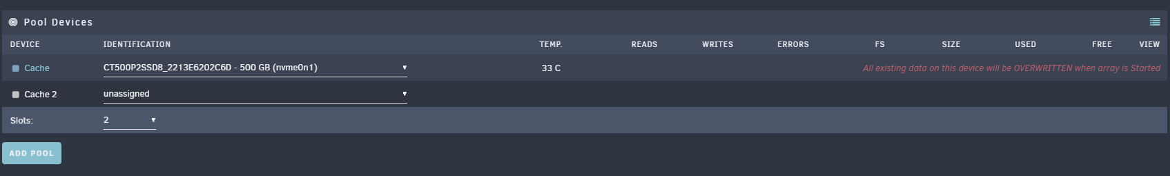

I do have 2 slots in my pool. See attachment.

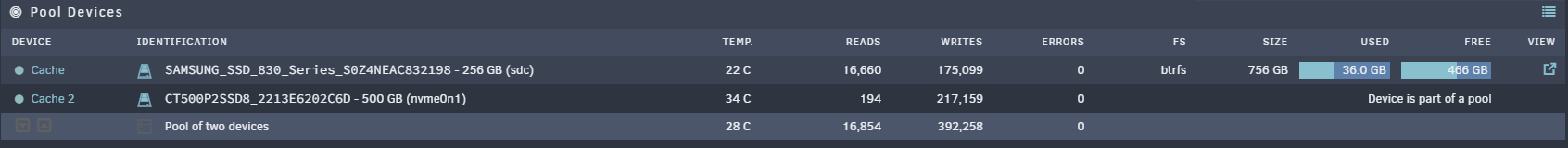

I mounted my original SSD and added my new SSD to the pool as cache 2.
There is now a message saying:
"Unraid Cache disk message: 14-06-2022 22:38
Warning [TOWER] - pool BTRFS too many profiles (You can ignore this warning when a pool balance operation is in progress)
SAMSUNG_SSD_830_Series_S0Z4NEAC832198 (sdc)"
I'm guessing it is pool balancing now? I'll wait until it is over and then try removing the 250GB SSD. When do you when it is over?
It's normal because of the balance, once it finishes you can remove the other device.
Stop array button should be inhibited while it's running.

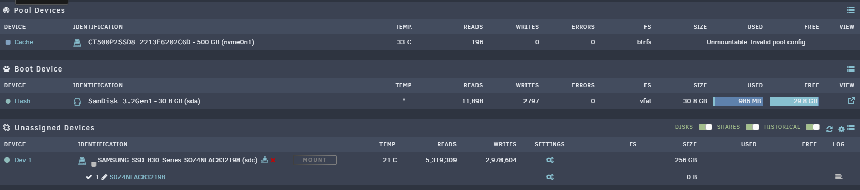

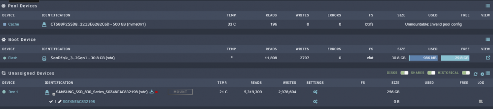

I now have the "Unmountable: Invalid pool config" error.

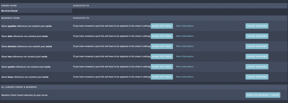

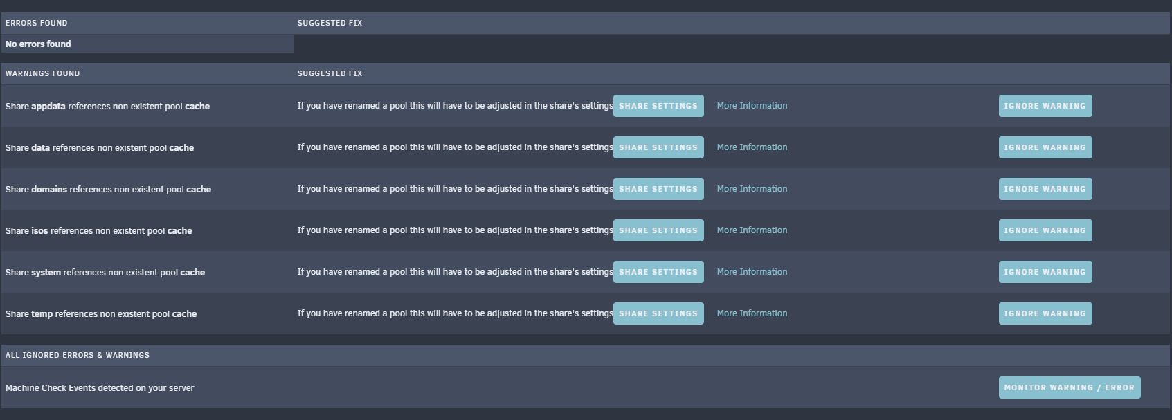

In my Fix Common Problems settings tab, I have these errors (see attached):
WARNINGS FOUND: "Share XXXXXX references non existent pool cache" SUGGESTED FIX:"If you have renamed a pool this will have to be adjusted in the share's settings"
I have attached a diagnostics download.

Jun 15 07:25:22 Tower emhttpd: shcmd (485): /sbin/wipefs -a /dev/sdc1
Jun 15 07:25:22 Tower root: wipefs: error: /dev/sdc1: probing initialization failed: Device or resource busy
Strange, for some reason device failed to wipe due to being busy, with the array still running see if you can do it manually now, by typing:
wipefs -a /dev/sdc1
Then stop the array and start again, if it still shows busy disconnect the device physically and start the array.
wipefs -a /dev/sdc1

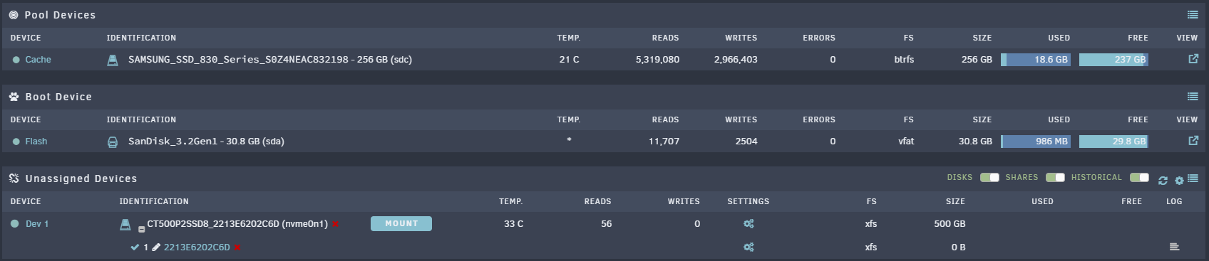

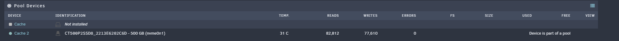

Done. It seems to have fixed the issues in the "Fix Common Problems" settings page. I do get this now (see below). Looks a bit weird, no size or used space is stated.
Edited by bobalot
It is weird, there's no device on slot 1 but it should still show the usage graphs, could be related to the theme you're using, but just assign it to slot 1:
-stop array
-unassign the device from cache2
-re-assign to cache1
-start array
Note that if you ever want to use the old cache device in the same server you need to wipe it before array start, you can use:
blkdiscard -f /dev/sdX
Replace X with correct letter.

It worked!!!
