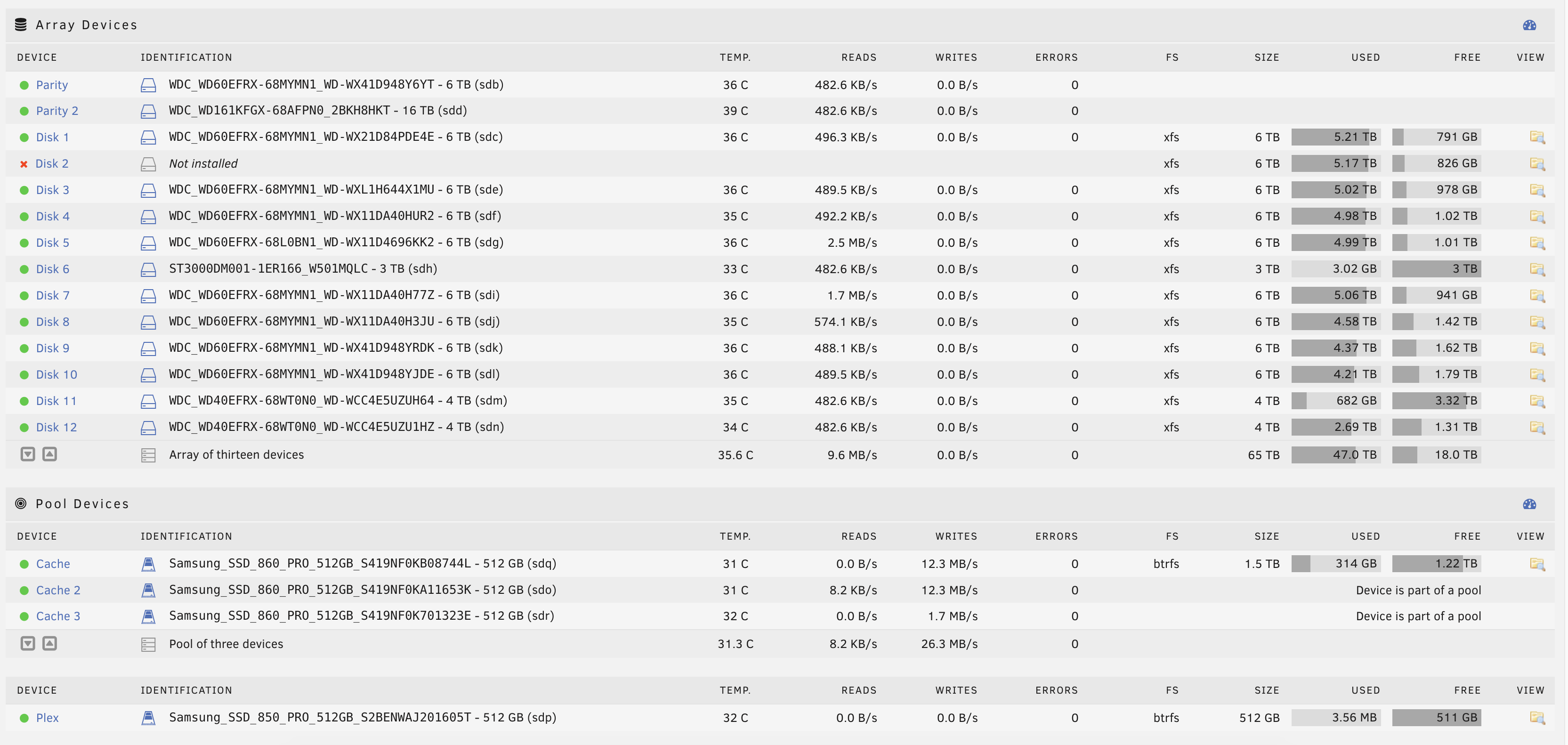

Yes disk2 still seems to be emulating correctly as far as I can tell. If there's any confusion attached a screenshot of how the array is setup RN.
If disk 2 is emulated correctly. Should be okay to proceed replace the failing 6TB drive? I realize nothing is guaranteed with this mess.
781199548_ScreenShot2022-06-13at12_58_27PM.thumb.png.95a7996affa005525dcf5f96b73ec77a.png
