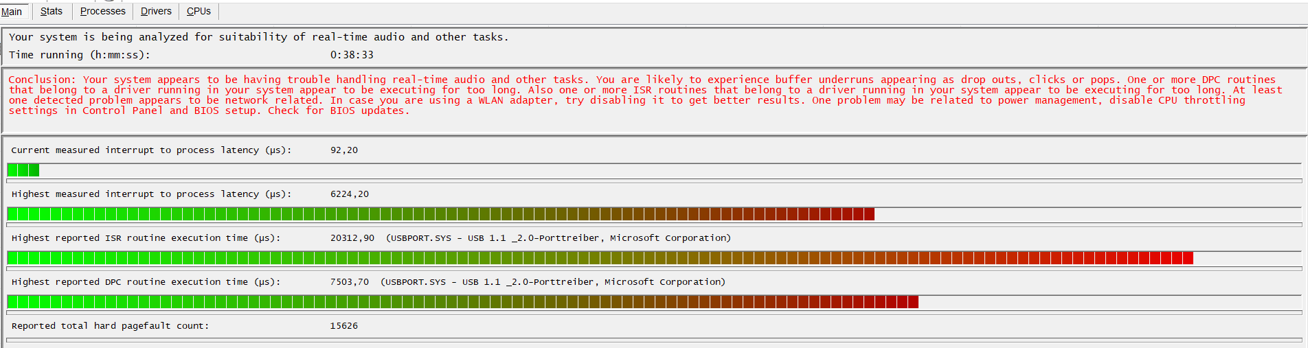

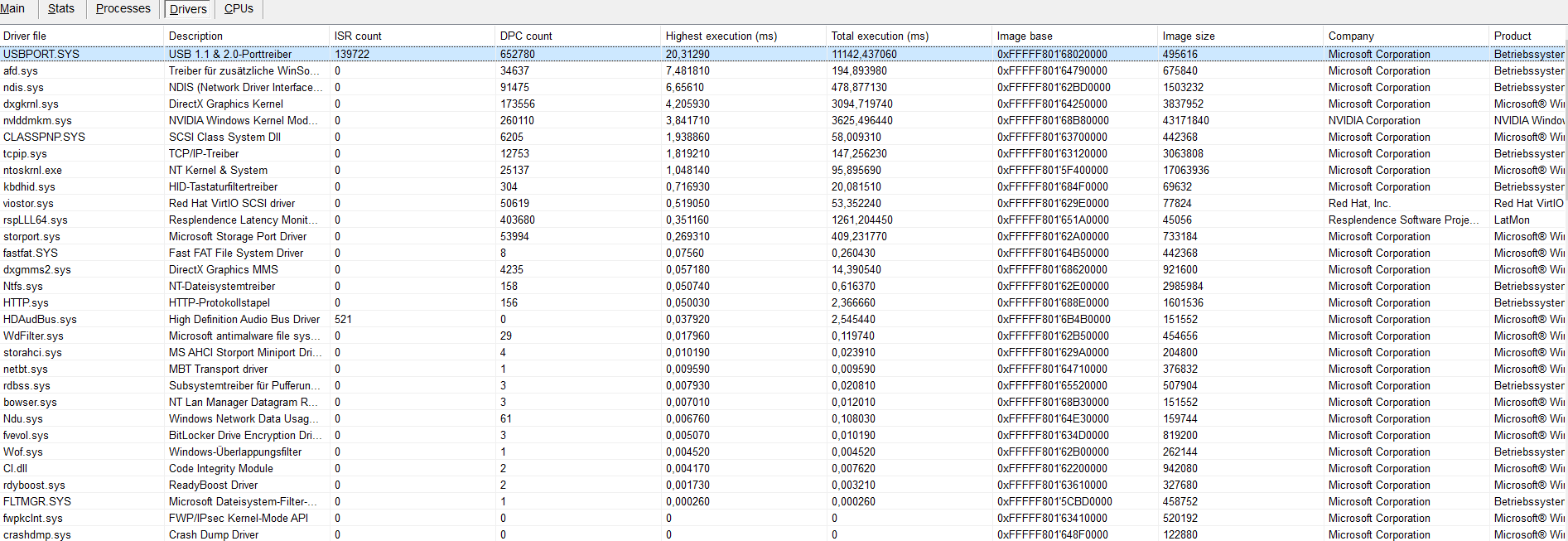

I'm using latencymon:
https://www.resplendence.com/latencymon
https://www.resplendence.com/download/LatencyMon.exe
just run it for some time and it will tell you latencies and drivers which may have issues.
If you find issues, high latency, try the msi utility:
https://forums.unraid.net/topic/76035-help-struggling-with-nvidia-audio-passthrough/?do=findComment&comment=1076592
Choose v3 and run it as admin.
Check if there are any irq conflict and if any, enable msi for one of the conflicting devices.
Edited by ghost82

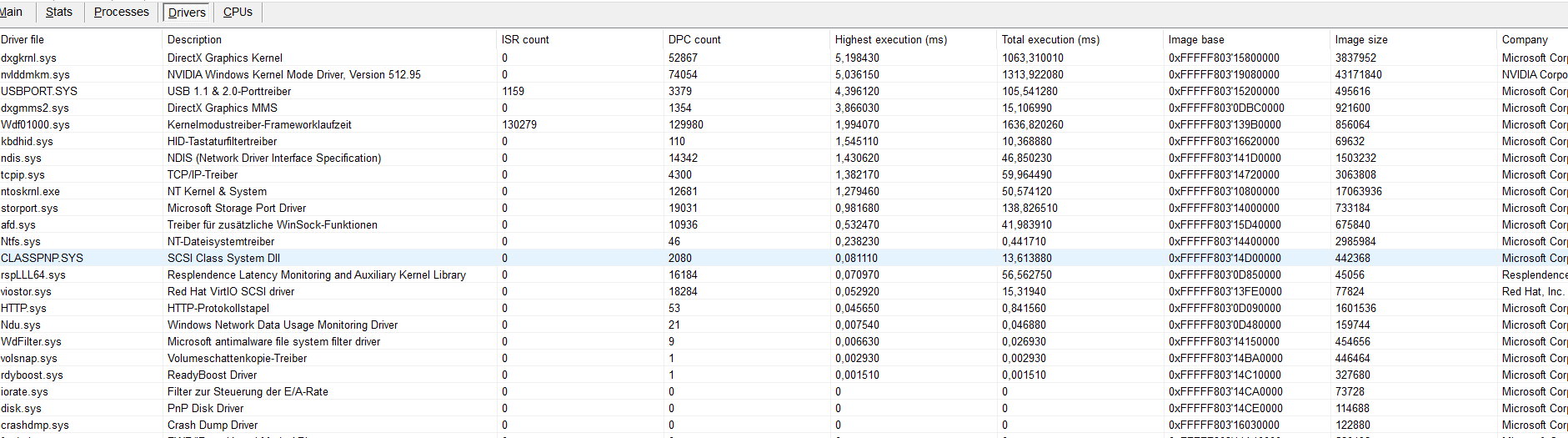

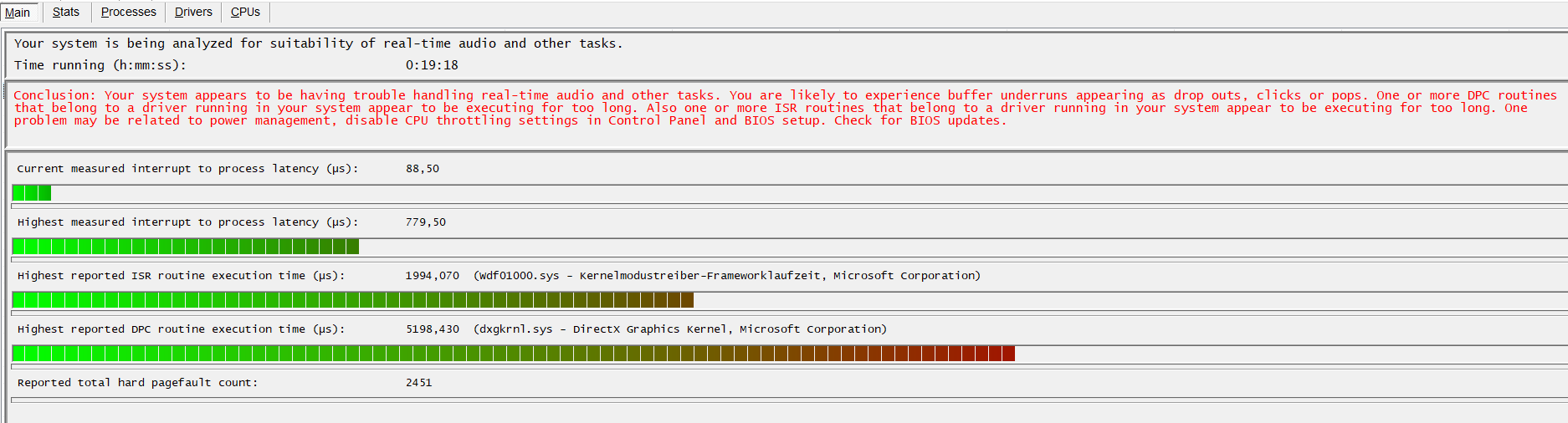

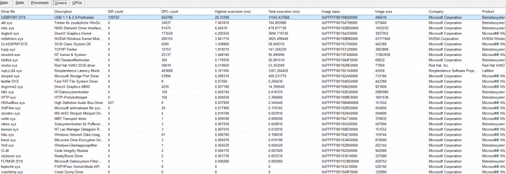

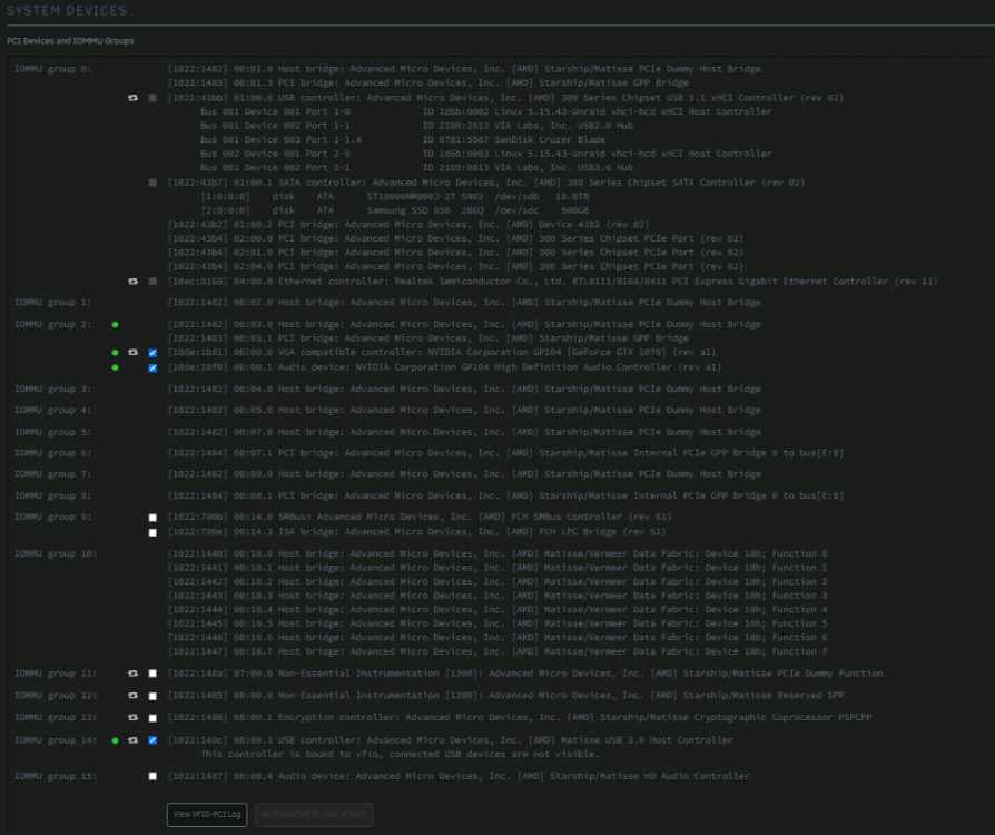

Thank you for the fast reply.
With LatencyMon and the msi utility i was able to fix one of the latency issues which was caused by the dxgkrnl.sys I set the priority to high and checked the msi checkbox for my gpu. After this the ISR Count went to 0 and the Highest execution went to 4,2ms. But the directx drivers were just the second most leaking driver. The USBPORT.SYS is still there with around 20ms at highest execution. I was trying to fix it like the gpu wit the msi utility. I gave all 4 of these usb controllers the msi checkbox and interrupt priority of "Normal" but this didnt help at all. I allso disabled the USB selective suspect setting explained in this post:
But no change ether.
The screenshots were taken after the restart with low loads. Just some browsing.
The next thing what i was thinking to try, is to forward my four usb inputs directly to the vm. Like Spacinvader is telling in this video:
But unfortenetly this guide doesent work with Unraid 6.10.2 any more. When i try to list the input devices by id, my system tells me, that there is no path for "by-id":
root@Bitbunker:~# ls /dev/input/by-id
/bin/ls: cannot access '/dev/input/by-id': No such file or directory
A other thing with this usb issue is, that in the msi mode utility all four controllers translated form german word by word have the name: "Intel(R) ICH9-Fimily USB2 universal Hostcontroller -" with the numbers 2934,2935,2936 and 293A at the end. I don´t think, that i have an Intel controller on my Ryzen Setup.. could this be the issue?
I haven´t been playing long enough to tell if this issue is now gone. But still i am very thankful to you for your fast and constructive response!
~Bekannt
Edited by Mr.Bekannt

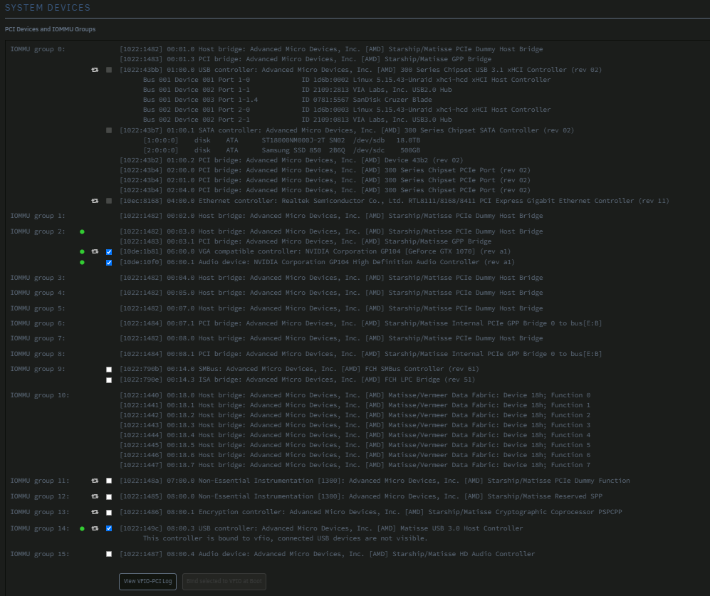

That are the usb emulated controllers you defined in the xml: ehci/uhci.
You still have a shared irq between an emulated usb controller and the high definition audio of your gpu: the audio supports msi so enable it also for the audio, then as far as it concern irq sharing you are good. If it still lags causes are elsewhere...
Emulated usb controllers can be deleted if you are not passing through any single usb device, or you can decrease their number, I don't think you need 2 usb 2.0 (ehci) and 2 usb 1.1 (uhci).
Note that one ehci always needs its companion uhci.
The lags come from the usb, so maybe that setting msi for conflicting audio will solve the lag.
Edited by ghost82
this wont work because they don't support msi: irq line based is defined by "linebased", message signaling interrupts (msi) by "msi" and/or "msix".
I´ve set an checkmark to the msi on the High Definition Audio-Controller. After now 25 mins uptime we are at around 10 ms @ Highest execution for USBPORT.sys. For now i belive this is a improvement. Now i need some friends to come onine and play a bit to get the proof. But im in good spirits about that... this would be great.
About the USB Ports... i am using:
-Mouse (Razer Naga trinity)
-Keyboard (Razer Ornata Chroma)
-Headset (Razer Nari Ultimate)
-Microphone (t.bone)
I don´t know if the Audio-Controller is used by default when i use an wireless usb headset. Nor if the VM setting would change something. I have the options between the GPU/CPU audio controller. I am about to try it our right now.
On my old Proxmox setup i did a pci passthrough for one of two usb controllers from the mobo, because of the native max 4 usb port passthrough setting on their os. I was thinking to get an usb-c controller switch, which i can simply forward as one pci item and have an hotplug usb hub for the gaming guest but sadly i bought a wrong one which was a simple dummy hub.
~Bekannt
If you are not passing through the usb controller directly, you are passing through single devices that attach to emulated usb controller.
For example, in an xml you could have this:
      <address type='pci' domain='0x0000' bus='0x00' slot='0x04' function='0x1'/>

100%! Thats also another reason why i did it on the proxmox system. Now i did the same on Unraid as you said. Again i used the Video of Spacinvader. Very nice guy. :
Instead of doing the exclusion of the controller in the Syslinux config. I used the build in function from unraid in Tools>System Devices>Checking the needed IOMMU group>Bind selected to VFIO at Boot. I had to remove the 4 forwarded usb ports from my VM XML config otherwise the VM Manager won´t accept the new USB controller.
We are now down to 5ms on the USBPORT.sys after 20 mins writing this post and listening to music on the VM. Some Screenshots again:
Spoiler
latencymon_drivers_tab_after_change.thumb.PNG.3b6d29e28ec10fc55b7e7284c1d4c54a.PNGlatencymon_main_tab_after_change.thumb.PNG.e7970c7009ae1d910a3f183f342e4ade.PNGmsi_utility_after_change.PNG.d4c0c70362ce15a8b42d88e501dc9d47.PNGsystem_devices_iommu.thumb.PNG.54688fac9662ce020ac621dbb1b2b6c6.PNG
I finally found the Spoiler button! 😅

5 hours ago, ghost82 said:
Is it not the audio controller of the gpu for digital audio output?
I am using an USB wireless headset. I don´t know if it does access the gpu audio. I thought, that the headset with its dongle is using its own audio drivers. I dont use any kind of hdmi audio source - just the usb headset.
~Bekannt
Correct
No, the usb audio has its own drivers.
The "High definition audio controller" you see in msi utility is that of the gpu, which should be passed through to the vm together with the video component of the gpu (so it's correct what you are doing).
