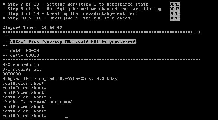

I decided to plug the HD into another slot and plug in a different cable power cable.  Next I tried to run a preclear. (I guess I should have done this before I had a problem)
The HD is WD green 2tb drive.  Stage 1 was showing that it was reading up to 100MB/s but often slowed down..  towards the end it was slowing down a lot.  When I went to bed it was up to 95% and had taken about 13hrs....
When I woke up I have the following results in the attached file...
I'm not sure why it's scrolled up... maybe my cat walked on the keyboard :(.  But I can't tell from this what has happened... can somebody please help

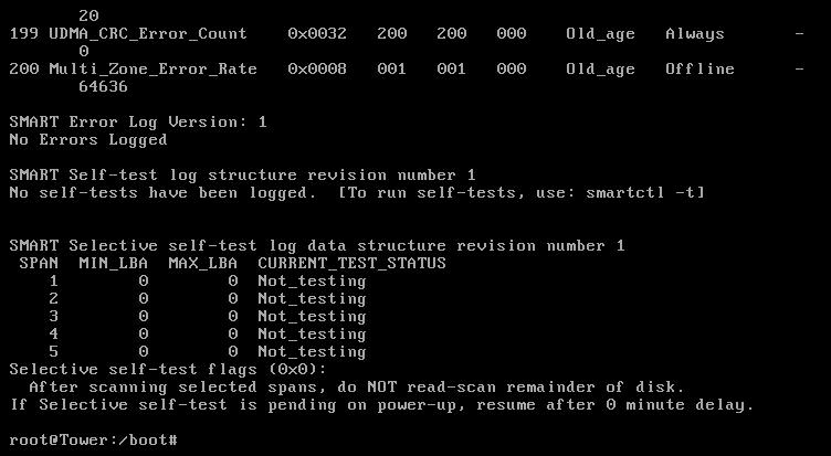

I'm using a Supermicro X7SPA-HF-O board and controlling it remotely wit IPMI.  As you can see from the attachment, once text goes of the top of the screen I can no longer access it....
Can somebody help me interpret this..  or help me see what the rest of the report said??
