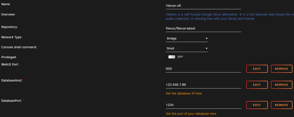

I was playing with NC and FileRun and encoutered the same problem in both those dockers. So i don't think it's NC related.
1217409802_Screenshot2022-07-07at16-28-01NetNas_UpdateContainer.thumb.png.447ae13c054a2daff73b2987e0d16e4a.png
When the network type is changed to custom:br an given a different ip, it cannot connect to the database. Still, the ip's are within the same subnet. It does not matter if the databasehost is changed to localhost or 123.456.7.89 .
To make it more rare, the problem only exists in my backup server. The NC docker on my main server is configured with custom network type. Both servers running unraid 6.9.2.
What am i doing wrong? Please, enlighten me.
Edited by Aran
Found it:
Set 'Host access to custom networks' to 'Enabled' from the docker settings page. When greyed-out, stop the docker service => enable host access to custom network => start docker again.
