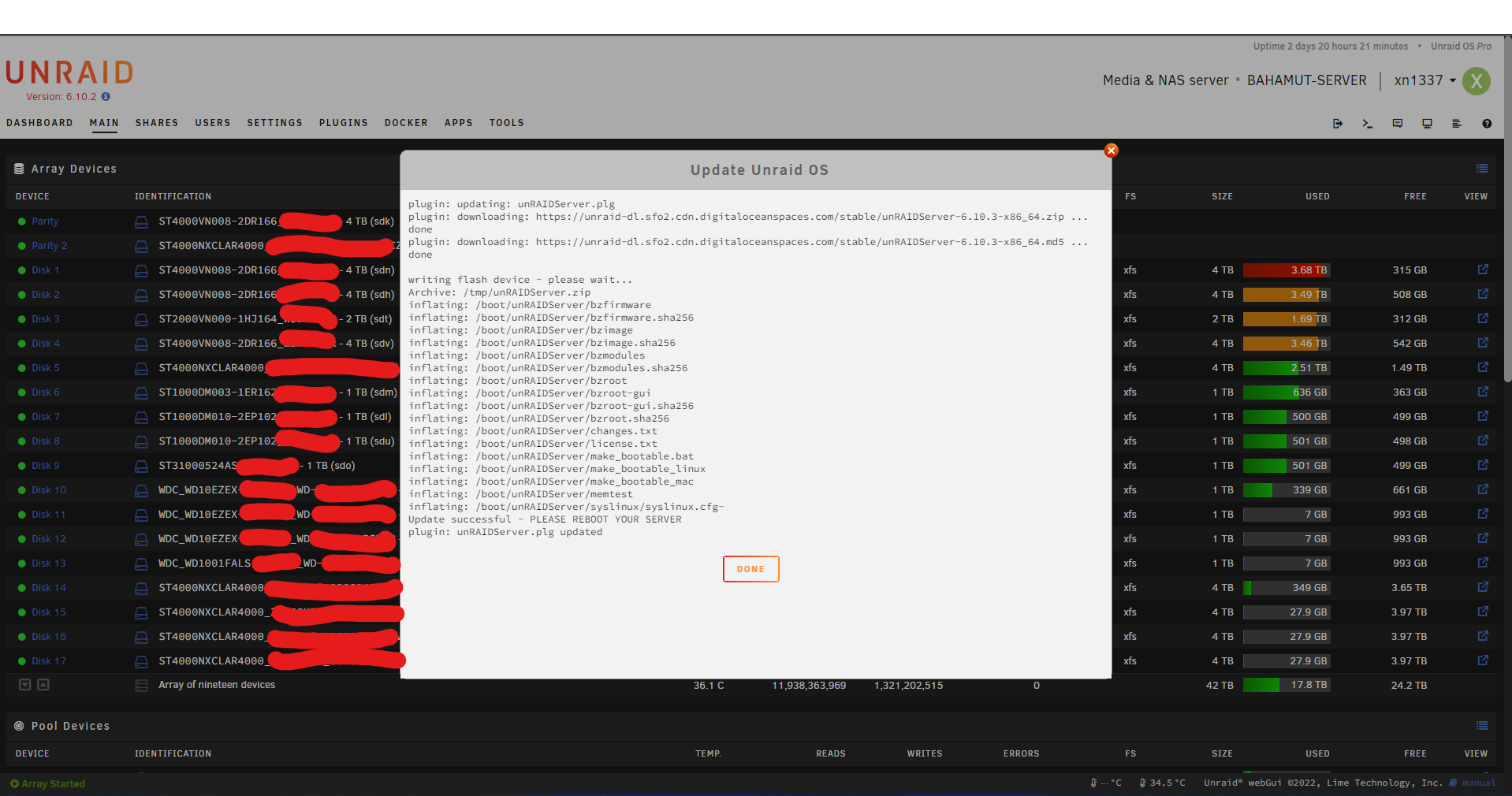

Please post a screenshot of the GUI after the plugin update completes.
Thanks for the reply, ended up spending the afternoon looking into this, we are using HAproxy on Opnsense to supply SSL to local servers,
after removing the server from the proxy to move over to using the new my servers feature, I re ran the update, it worked this time, here is a screenshot anyway of the successful update.
