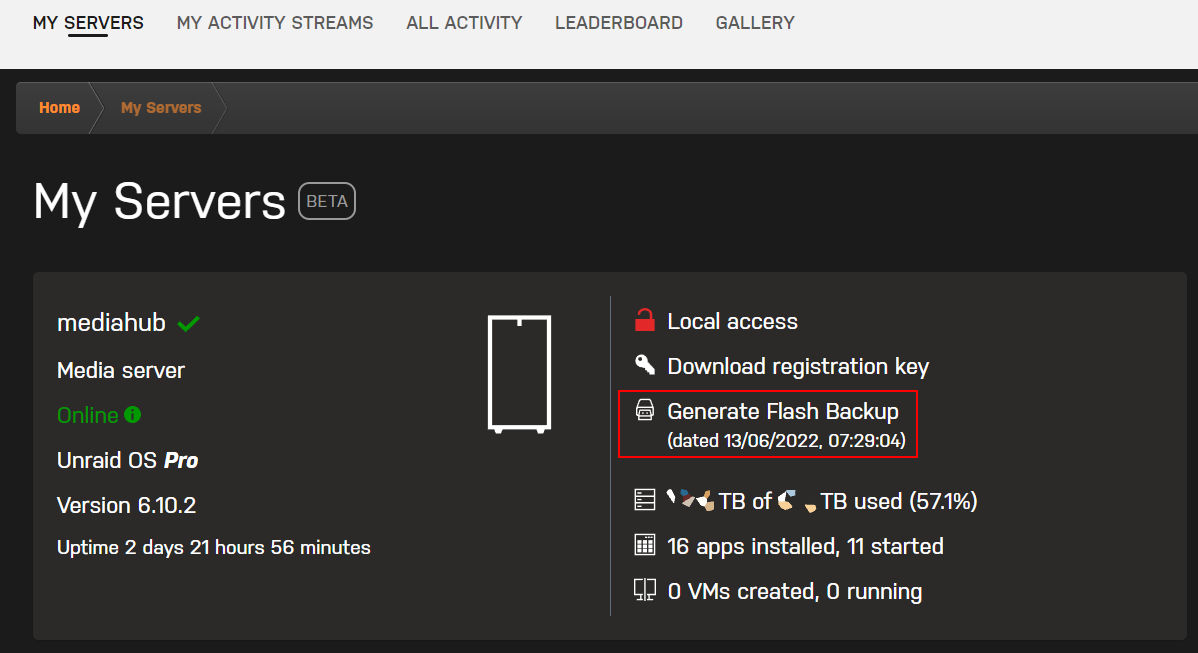

On 6/15/2022 at 5:31 AM, Glonch said:
Thanks - but I had done that process a while back but it appears it didn't take.  So, I had no way of downloading a backup.
Glad your system is back up and running, let's get the backup going too.
Go to Settings -> Management Access -> My Servers and press "Reinitialize". This should give you a fresh backup. Give it a few minutes, then go to the My Servers Dashboard:
   https://forums.unraid.net/my-servers/
and you should be able to "Generate Flash Backup".
If not, send me a PM with the /var/log/gitflash file from your server. The easiest way to get it is to open a web terminal and type:
cp /var/log/gitflash /boot
Then attach the gitflash file from the root of your flash drive.
