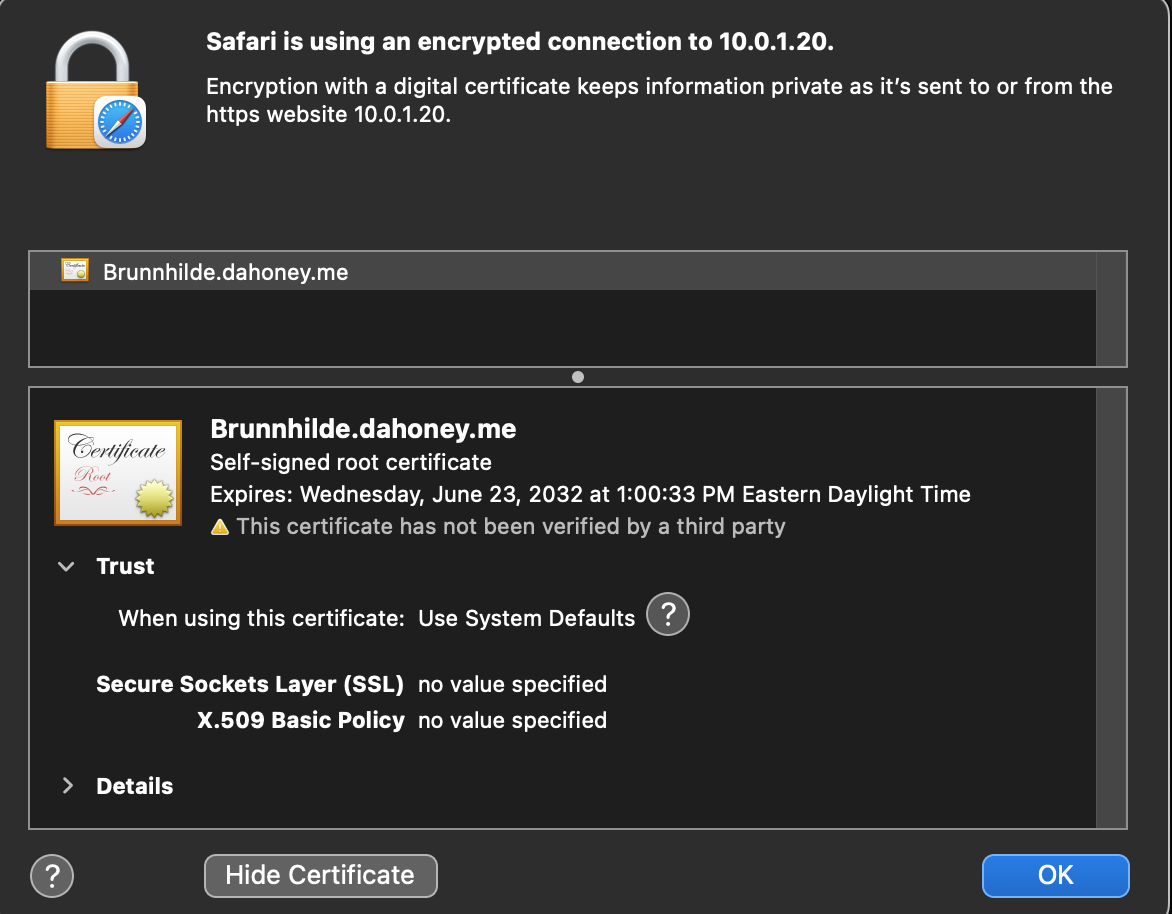

Looks like the same problem with the LE certificate and the details don't look right. Still shows as a self-signed certificate for one thing.
1840118750_ScreenShot2022-06-26at2_27_51PM.thumb.png.f5a0d31f6deb89a9f786cc6a8a480296.png

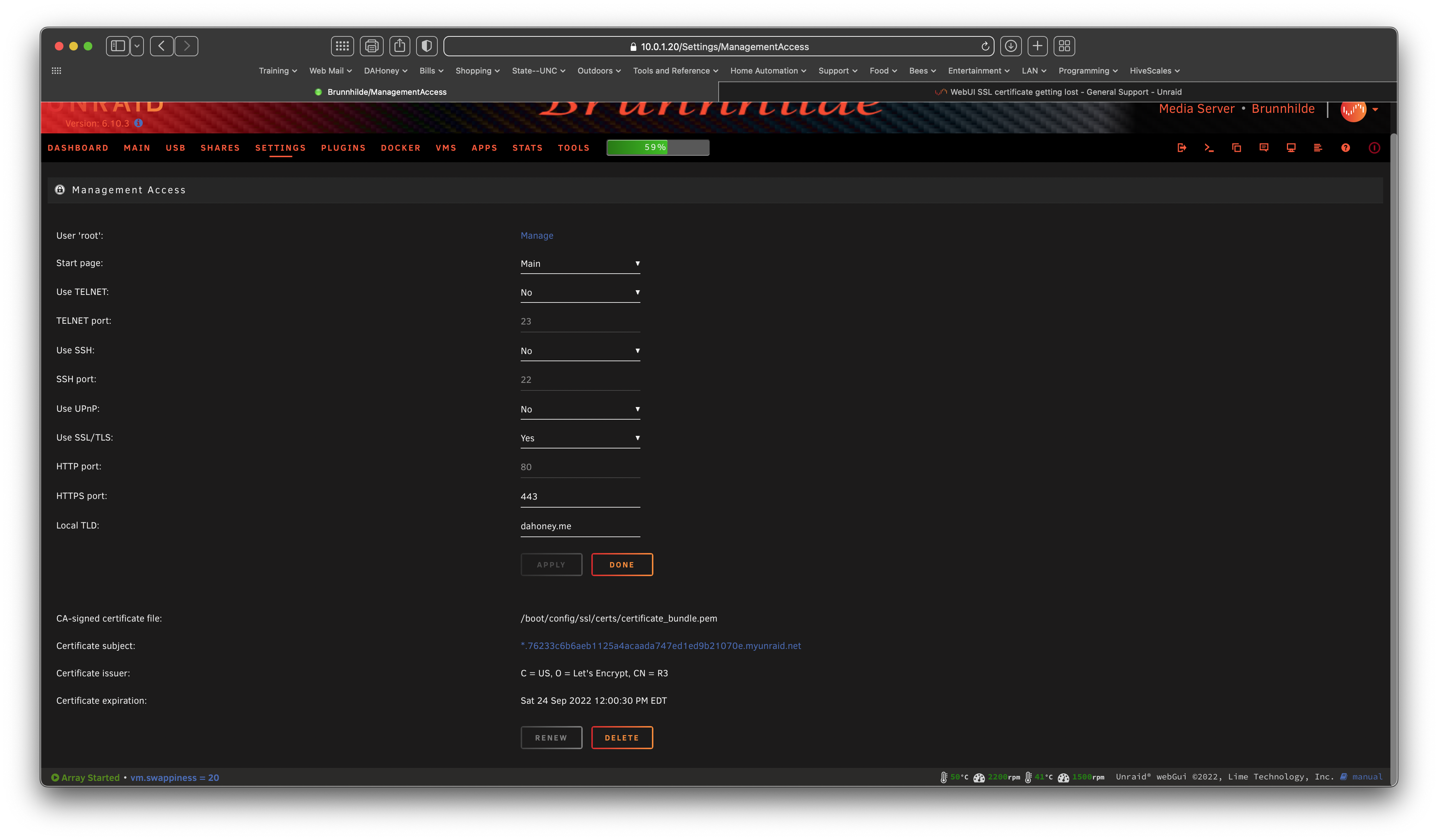

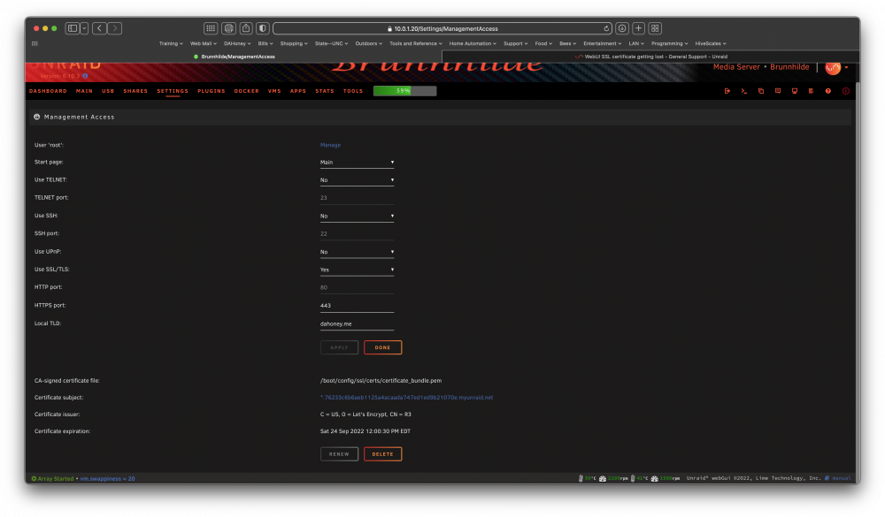

Expiration should be June 26th too since I just installed it a few hours ago. Rebooted the unraid server and checked with Firefox and Chrome as well as Safari. They all show the same details for the certificate. Here's what Management Access shows (I think it's correct)-
1117692690_ScreenShot2022-06-26at2_35_58PM.thumb.png.6ed2b1c2e80e687f86bef84e545cac76.png
brunnhilde-diagnostics-20220626-1437.zip
The LE cert is good only for the myunraid.net url specified in the LE cert. If you are accessing the server via some other url (https://[servername].[localTLD] or https://[ipaddress]) then it will use the self-signed certificate because the LE cert is not valid for those urls.
To find your LE url, go to Settings -> Management Access and click the link in the CA Certificate Subject area.
To change how redirects work, so http://[ipaddress] redirects to https://[ip].[hash].myunraid.net, see: https://wiki.unraid.net/Manual/Security#Redirects
My recommendation is to switch fully to the myunraid.net url.
If you wish to continue using https://[servername].[localTLD] or https://[ipaddress] then you'll need to get your Mac to trust the self-signed certificate. This is discussed more here:
https://forums.unraid.net/topic/124874-unable-to-open-unraid-by-ip-address-since-upgrade-to-610/
