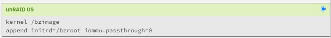

That's a big update, several changes in between, one thing that changed this release is the iommu pass-through mode, unlikely that is the problem but since it's very easy to try, just add iommu.passtrough=0 to syslinux.cfg and reboot:
If it doesn't help recommend removing the line.
Adding that iommu config did not seem to do anything. I've since retried every possible combination of passthrough i can find.

> removing the line
Which line? The whole append? The iommu added bit?

Kind of expected that, but since we mostly tested with Intel and Nvidia it was worth a shot just to make sure, unfortunately I don't have any more ideas, but someone else might.

3 minutes ago, dogmatic69 said:
Which line?
Just iommu.passthrough=0
