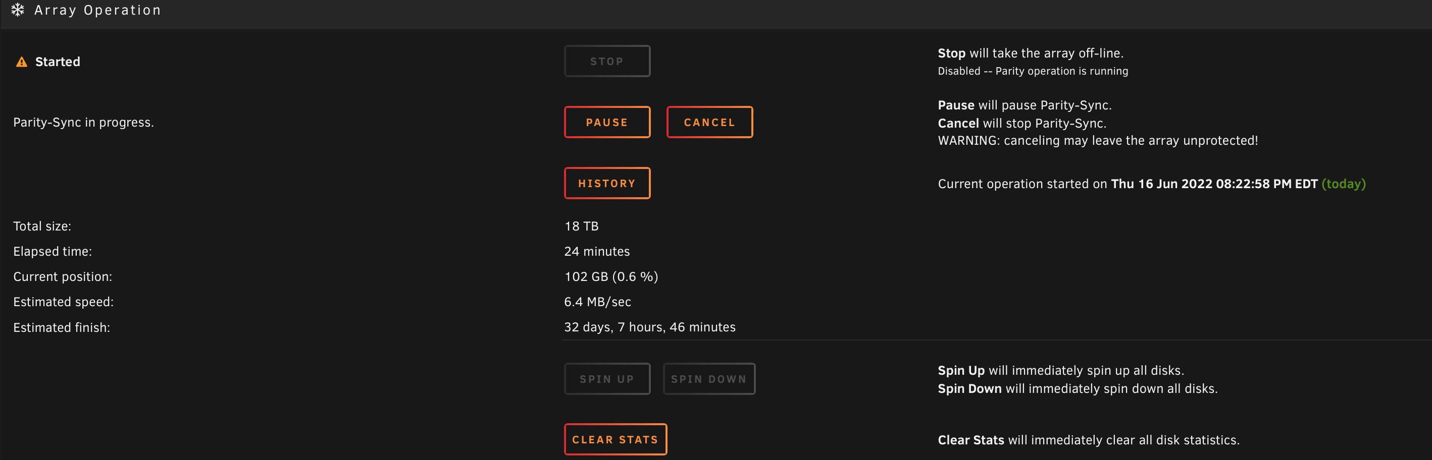

Just replaced my parity disk with a larger one (WD WUH721818ALE6L4 18TB) but the rebuild is going very slowly. I don't remember any being this slow before.

There's some activity going on on disk7, make sure nothing is reading/writing it and see if speed improves.
When I went to bed last night the speed was up near 100MB/s. This morning it's back down below 10MB/s.
Syslog Server was writing to disk7. I've disabled it but not seeing any speed improvements yet.
Something else was also reading from it.
