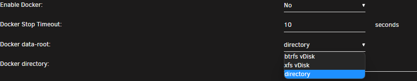

If you've haven't managed to figure out why the image is filling up, I'd switch from using an image to instead use a folder for docker.  More space efficient and you never need to worry about the sizing again

I have not figured it unfortunately, the only big change I've made is updating the OS. Is there any good guide for frp, image --> folder?
