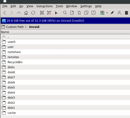

You can probably delete libvirt folder on disk1. Do you have Krusader configured to allow you to see the disks?
I do.
