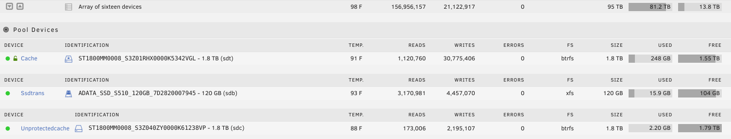

My array has 13.8 TB free and my 'unprotectedcache' for the share has 1.79 TB free:

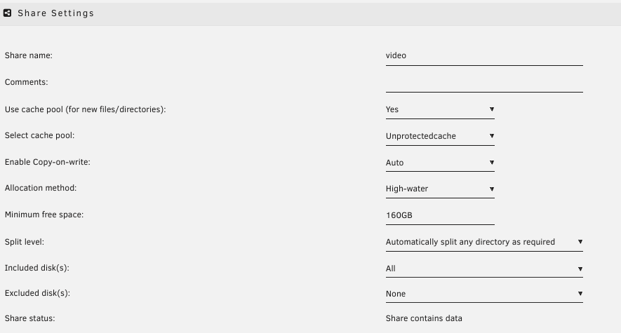

Share is configured with minimum 160GB free:

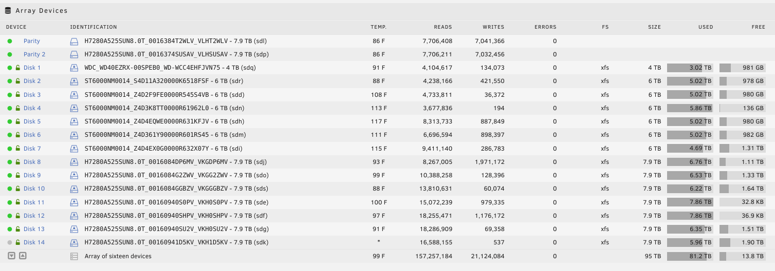

Actual disk utilizations:

Share appears to be correctly configured, I assume a transfer to the share via SMB or locally works correctly? If yes looks like a docker issue, you might try the docker support thread, if there' is one.

What have you got set for the Minimum Free Space for the pools/cache?  I see you have it set for the share, but I could not check your pools since no diagnostics were provided.  If not set correctly it may stop Unraid tidily start bypassing the cache/pool as it gets near full.
I have no minimum space set for the cache drive, and it's got 1.7TB free when trying to perform the copy operation.
I tried changing the allocation strategy on the share to "most free", but it didn't seem to make a difference either.
