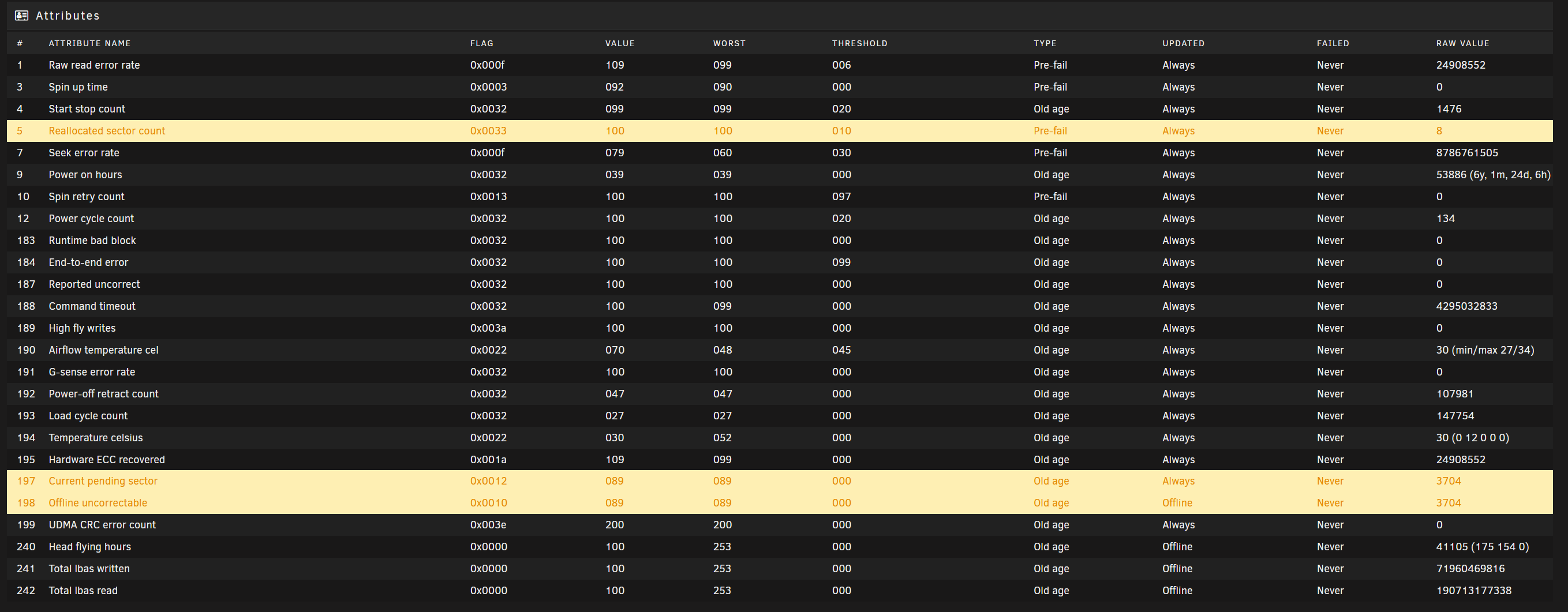

Hello everyone,
I just received a smart health check error on one of my disk
image.thumb.png.321625a590164b01f34e853947950bcb.png<
Does it mean my disk is imminent failure and I must change it asap?
Thank you
Not all SMART errors are equal, but that particular one looks pretty bad. You could run a SMART extended test to get more info, but I would plan on replacing it.

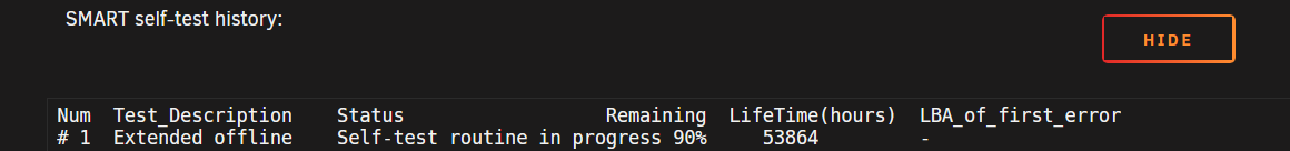

Ok. I've already started the extended test, waiting for the result.
Thanks for the input
do you know how much time it can take for an 8tb hdd? It's been running for the past hour and it's still at 10%
2 hours per TB
HOLY! ok, I'll check in 2 days... Thanks!
With updates at each 10%

smart health is still only at 10% after more then 12 hours.... I guess it will fail

Is that the remaining time for the smart scan?
