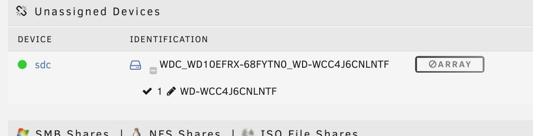

tried that beforehand and didn't work, and now it does? Weird.
Thankfully the files are intact.
sadly, now the parity drive is missing although it was detected by my sata hba controller on boot. Again did the shutdown and cable check, still nothing. Do I try again?
