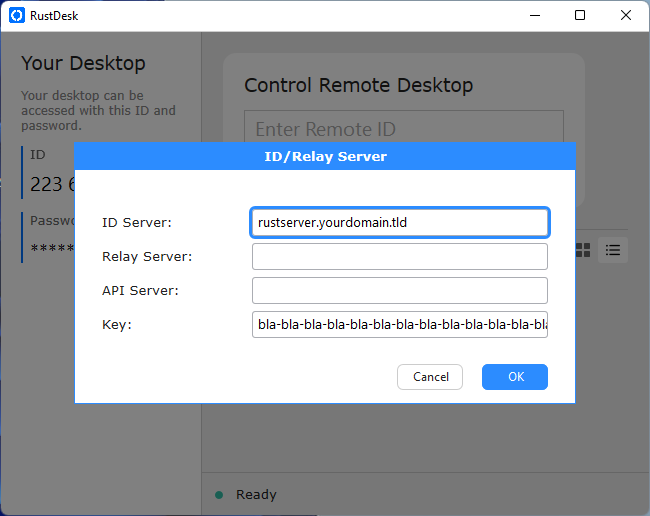

You must set "ID Server:" on the client to your public-ip or hostname. Ports must be opened/forwarded in your firewall.
This is mine on a Windows 11 machine, once you click OK you should see a green button + "Ready" in the status bar.
