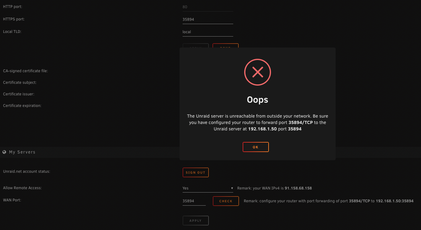

I recently enabled the myservers function at:
https://192-168-1-50.blahblahbigstringhere.myunraid.net:35894/

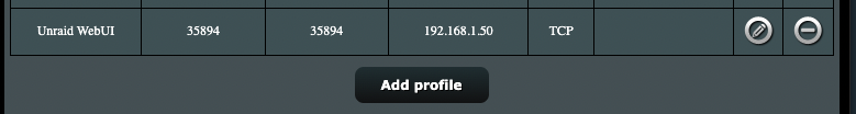

In my router I mapped:
External 35894 to internal 192.168.1.50:35894
I've been waiting a few hours now but the Settings page is just sitting on
DNS Propagation is PENDING
How long does this take? Perhaps a NOTE: could be added here if it takes some days or something to complete. As I would have expected this to come up relatively quickly.

Hmm interestingly:
https://blahblahbigstringhere.unraid.net:35894/
seems to work fine...
Why then is the settings page showing the URL in the top post, which includes the local IP with hyphens and uses "myunraid" instead of just "unraid"?
Edited by plantsandbinary
