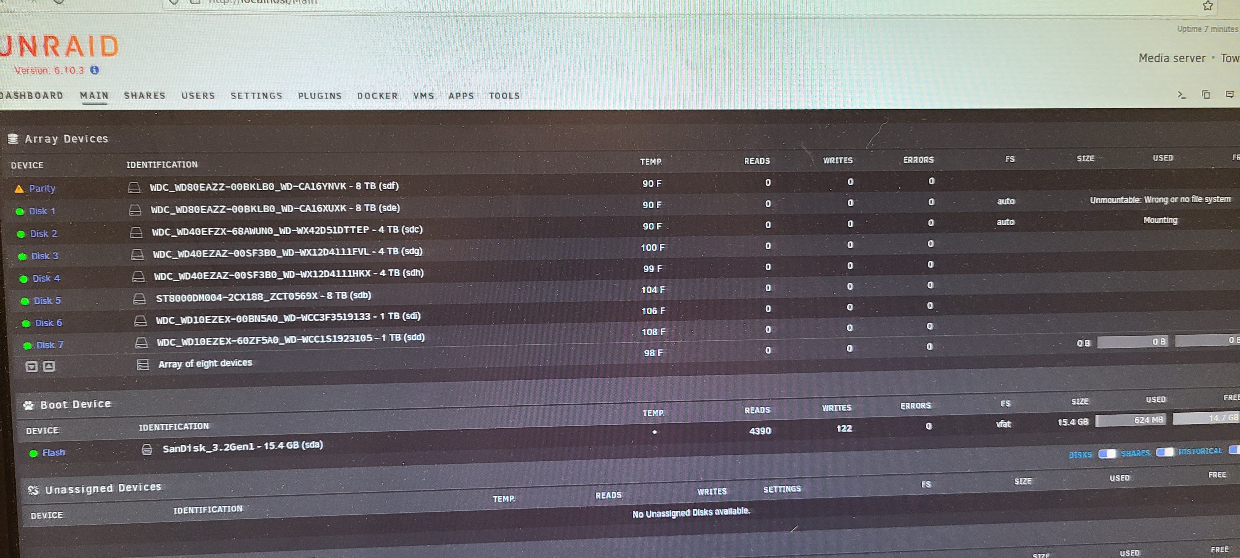

Memtest came back fine, i changed the AMD settings in BIOS to be ahci/sata after that i tried to start the server and run the parity build and everything hung up and my disks 1 and 2 gave me "unmountable - wrong file system" and the other one was just stuck on "mounting" these disks have the right file system on them and are brand new no issues until now
Post new diags.
Wow that turned into a nightmare real quick, the server became unresponsive so i had to reboot, after that i was able to start the array but every read from Disk 2 had an error, boot up showed SMART errors on the drive so i hooked it up to Parted Magic and ran a health test, showed no signs of anything wrong, grabbed a new sata cable because that might be the only thing i hadnt changed out and started the server back up. Now it is building parity but im sure it will error out, i can post new diags but my understanding is after a reboot they are gone? Or is that wrong? Posted them just to be safe

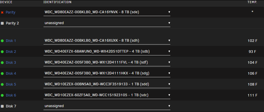

I guess I can let it build parity off the disks one by one and see if I can find the culprit that way because except for 2 of these disks they are all brand new.  And the two disks passed health checks
Edited by dkaholz
Only disks 5, 6 have had extended self tests.
And those weren't recent.
They shouldve been done a few days ago, otherwise every drive is brand new. I rebooted the server because the parity drive wont even let me select it anymore any my other 8TB shows up as having a smart error, im going to return it, somehow that is 2 drives out of the box that are apparently bad....
