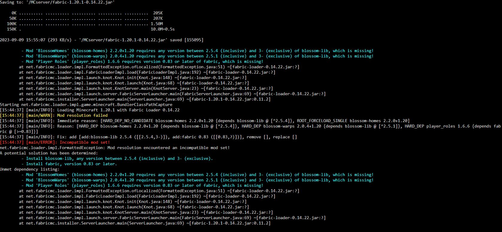

I am unable to install any mods for this fabric loader version.
right in the log it is telling you that you are missing parts that the mods need ether that or you have the wrong mo versions
