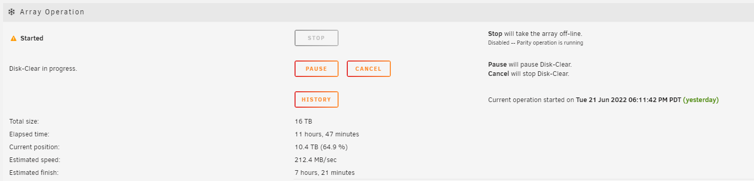

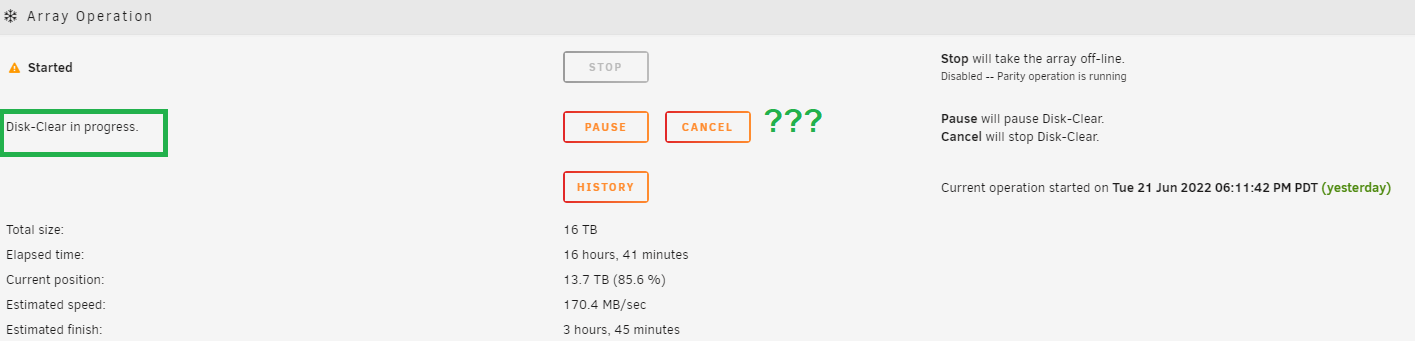

Disk 2 is currently doing the following:  image.thumb.png.8e21b3be00ce5d3674b654e4939763ac.png
Is it okay to power down the server while the above activity is occurring or should I wait until it completes?  Upon power down I'll check all the cables and move the drives to the onboard Intel SATA controller so it gets them off them Marvel SATA controller to hopefully increase stability.  I'll remove the Marvel SATA controller at the same time if it isn't recommended for Unraid.
It's OK to power down but it will start over from the beginning, might as well see if it finishes.
Not entirely clear about this. It should be rebuilding disabled disk1. If it is doing anything with disk2 it would be clearing it.
Post a screenshot of Main - Array Devices and new diagnostics.
It is, it shows that in the screenshot, good catch.

So is disk1 not seen and so not being rebuilt? Or will it just not do rebuild while a clear is happening?
Will be able to rebuild disk1 once the clearing is done, I assume disk2 is really a new disk, because it's getting wiped, and if disk2 was supposed to be used as disk1 he should cancel the clear now and after that will be able to use that disk to rebuild disk1, if the clear finishes can't so easily remove the disk from the array, especially with aa disabled disk.

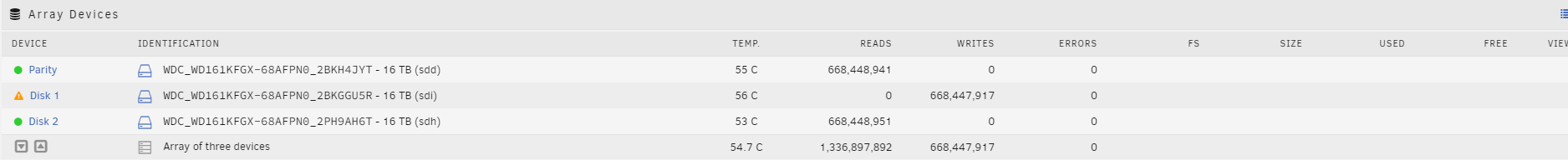

Hi All, thank you for your continued analysis.  Here is an image of the Array:
I've also attached the latest diagnostics

Let the clear finish then rebuild disk1.
Clear finished, powered down the server.  Replaced the SATA controller, the 16TB was connected to the Marvel SATA controller so for the moment it is now connected to the new SATA controller.  Powered up the server and followed the steps as per the manual:

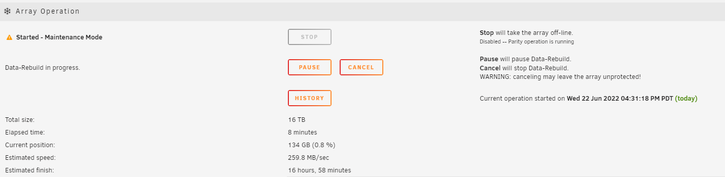

Started the area in maintenance mode and it did present the Sync button.  It appears a sync "Data-Rebuild" is now in progress.
So far it all appears to be okay but I've attached a latest diagnostics log incase you have an opportunity to take a look and see if there are any concerns.  I hope, so far so good.  Thanks for your help!

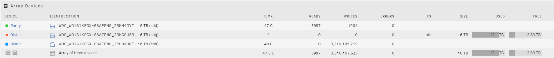

What do you mean no drives are mounted?  This is what I see in the Array Devices:
When a drive is mounted, all of those columns at the end (FS, Size, Used, Free, View) have something in them.
And your diagnostics shows no disks mounted, that is why I said
