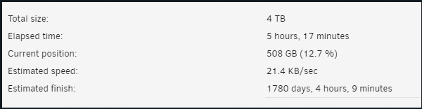

I let it run for a bit longer, figuring maybe its a parity thing, but rebuild drive speed drops from 80mb/ps to the kbs.....
Alright, this isn't right. something else must be wrong. At this moment i also noticed that data that was on 1 disk (my collection of movies i gathered over the years) was no longer showing.

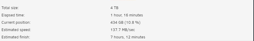

Re-starting the parity build, by swapping the new disks per slot and formatting them. After about 2 hours, i reach the 500GB mark where previously all the errors started appearing. No errors this time. The parity rebuild continues, all seems fine.

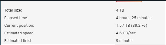

After about 5 hours, something happens. The one data disk that wasn't malfunctioning earlier, now all a sudden has errors and is being emulated.
The parity build process changes in speed, from 80mb/ps on average, to 1,2gb/ps, 2.3gb/ps, 4.6gb/ps and even topping out around 8gb/ps.
Now we all know, sata drives can be fast. But no way spinning disks on Sata are THIS fast.

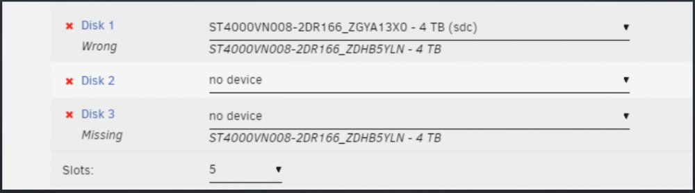

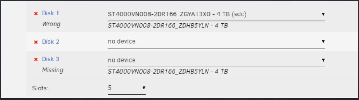

Now, unraid wants the same disk on position 1 and 3? Daf...q?
When trying to force the correct disk, it gives me the 'wrong' message.

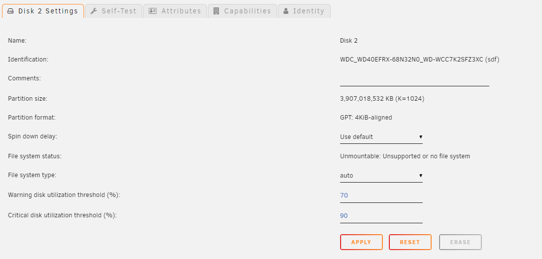

Aye, thats what i thought. But the disks were unmountable (forgot to mention, sorry, been a hectic day), thus i had to format them :(
Would there have been another option when they became unmountable because of a missing file system?
Yes!    It is covered here in the online documentations accessible via the ‘Manual’ link at the bottom of the GUI.

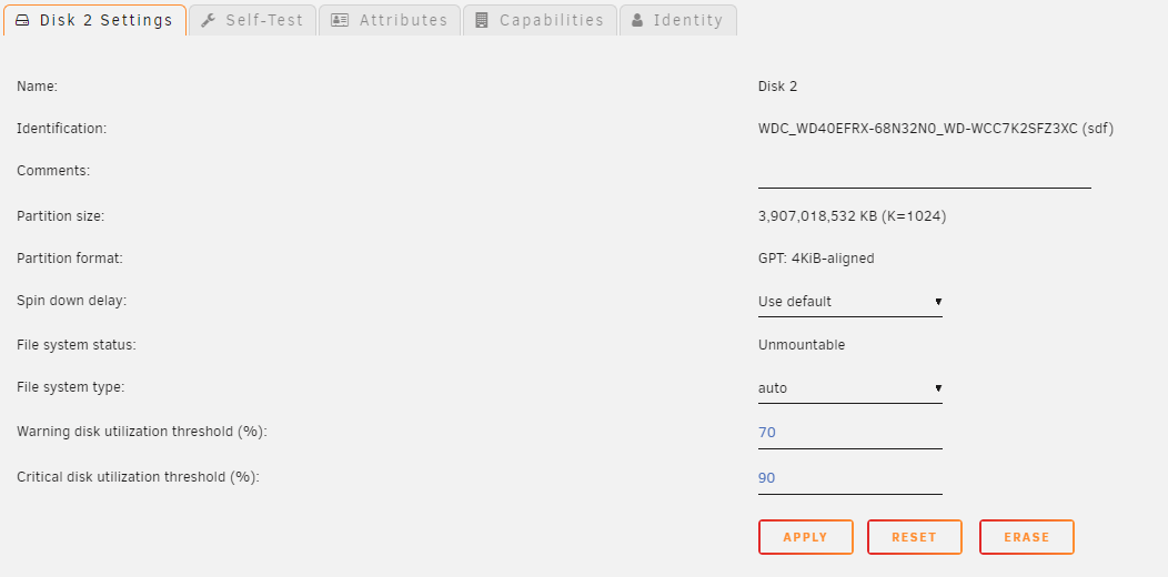

so, i'm trying to follow the guide @itimpi but i run into an issue at step 4. i do not have the 'check filesystem status' button? (i know the entire array was done in XFS, so following that thread)
And taking the array out of maintenance mode. i get the following
Edited by Caennanu
FYI this will happen if Unraid is beyond the array redundancy, e..g, if you get errors on another disk with two parity drives but have already two disabled disks Unraid has no way of continuing the rebuild, so to not corrupt the disk (if it's a previous disk that is being rebuilt on top) it just skips ahead while there are multiple disk errors, hence the speed, it's just skipping, not actually writing anything.
Alright that makes sence.

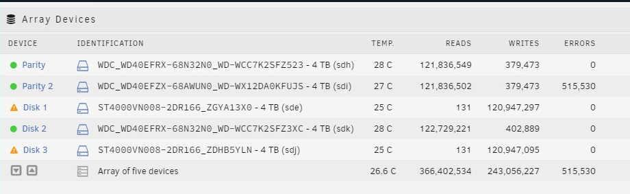

Disk2 was added as a new disk to the array and it was cleared, that writes zeros to the disk, overwriting any data.
