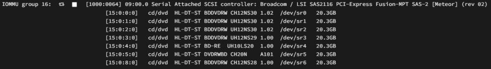

LSI just detect the Bluray, no matter disc insert or not.
02:00.0 RAID bus controller [0104]: Broadcom / LSI SAS2008 PCI-Express Fusion-MPT SAS-2 [Falcon] [1000:0072] (rev 03)
	Subsystem: Fujitsu Technology Solutions HBA Ctrl SAS 6G 0/1 [D2607] [1734:1177]
	Kernel driver in use: mpt3sas
	Kernel modules: mpt3sas
01:00.0 Serial Attached SCSI controller [0107]: Broadcom / LSI SAS2008 PCI-Express Fusion-MPT SAS-2 [Falcon] [1000:0072] (rev 03)
	Subsystem: Dell 6Gbps SAS HBA Adapter [1028:1f1c]
