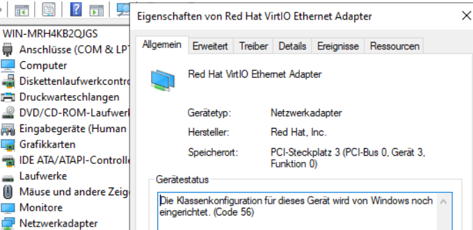

Hello there,
i just installed a windows Server 2019 version as VM on my Unraid Server.
So far so good but with installed network drivers i cannot see the adapter in the network settings.
In the device manager i can see the network devices but flagged with the Error 56 as seen in the attachement.
I tried different versions of windows Server but no luck here.
Is there any solution out there?
In the far past so 2 years ago i could install windows Server flawlessly but now im on a up to date unraid version and it didnt seem to work anymore.
Thanks a lot in adevance.

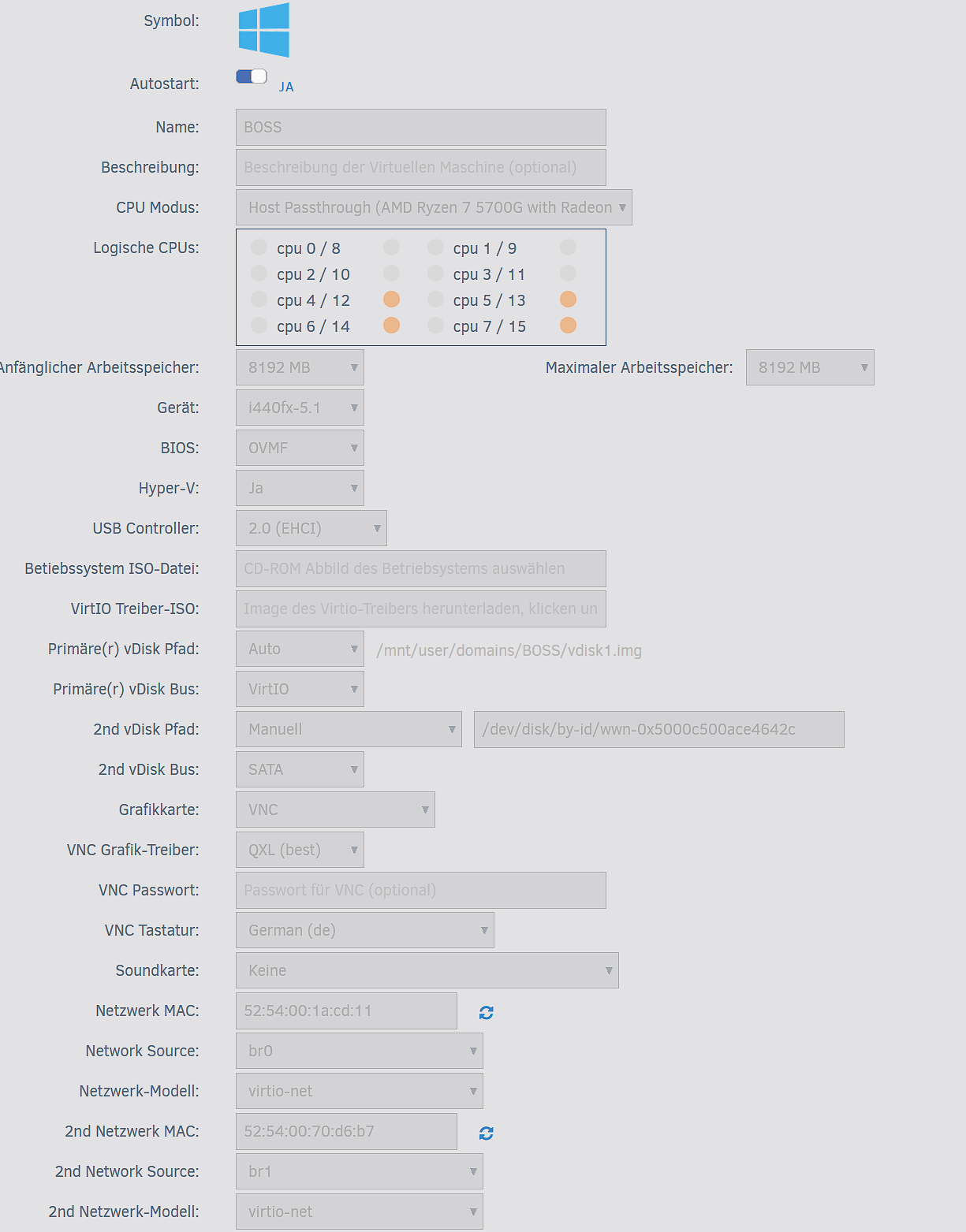

hmm, I guess, your vm settings are not really "good". Compare to mine here, this vm uses 2 red hat network cards on Win 2019
Sometimes you need to use a special BIOS type and Device combination to get the drivers working. Try these (but the combination depends on your real hardware, so this AMD example may no work on Intel machines, I dont know)

no need to reinstall. just stop the vm, change some setting, start it again and look if it working now.
But your error looks like it is biting itself in the tail. It needs an update, but it cant update because the card is not working.
I would try some old and slow card emulation (not Red Hat virtio) just to get maybe a 100mbit/s virtual card. Then update with this, reboot and switch back to to Red Hat.
Your Guest OS is missing some basic features that prevents ANY driver to work.
Maybe your installation image is wrong/bad/corrupted ???
Reinstall the nic drivers from the new virtio red hat iso file. You can download if off their site. Probably the driver you are using is too old.

Very strange, just yesterday installed Win Server 2019 and it installed the driver without any issues.
It depends on the source where one downloads the virtio iso.
Fedora source, which is that integrated into unraid, provides signed drivers, other sources may not have the drivers signed.
