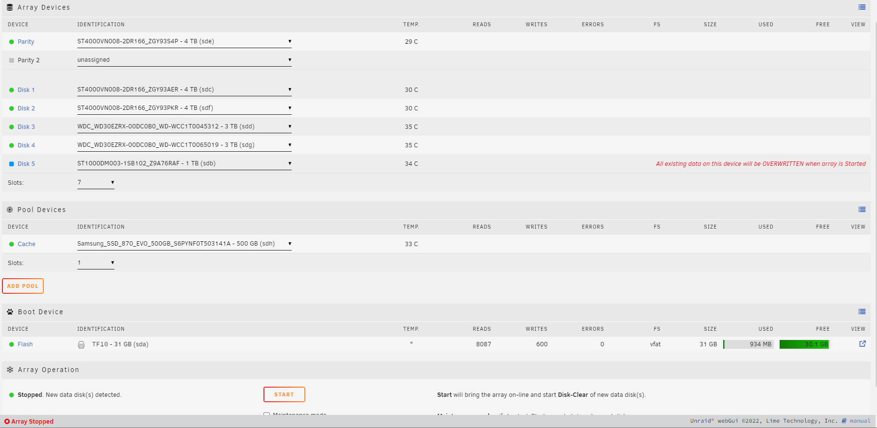

June 26, 20224 yr Hello guys, recently I wanted to move my VMs to a SSD. For this reason, I bought a 500 GB SATA SSD on top of my already running 1 TB NVMe Cache. Today, I shut off the server and connected the new SSD. Since I want to run my VMs rather on the NVMe than on the SATA, I removed the NVMe from the cache pool and assigned it to the array. It said, that "All existing data on this device will be OVERWRITTEN when array is Started". Then, I assigned the new 500 GB SSD to the cache. After starting the array, there was a job "Disk Clear" running and I noticed that some of my Docker containers terminated. This "Disk Clear" deleted some of the files in "/mnt/user/appdata/". I immediately stopped the "Disk Clear" and stopped the array. What did I do wrong? Overwriting the cache shouldn't be a problem, right? Sadly, I do not have a backup of all data (about 30% is backed up). Can I restore this data, that was deleted? I still do not quite understand, why it was deleted in the first place. tower-diagnostics-20220626-1201.zip
June 26, 20224 yr Community Expert 33 minutes ago, manrw said: I removed the NVMe from the cache pool and assigned it to the array. It said, that "All existing data on this device will be OVERWRITTEN when array is Started". Was there any data on that NVMe device? To maintain parity valid any device added to the array will be cleared, hence the "all data will be lost" warning, and since NVMe devices are fast just letting the clear run for a few seconds will make any data recovery attempt very difficult.
June 26, 20224 yr Author 14 minutes ago, JorgeB said: Was there any data on that NVMe device? To maintain parity valid any device added to the array will be cleared, hence the "all data will be lost" warning, and since NVMe devices are fast just letting the clear run for a few seconds will make any data recovery attempt very difficult. Obviously, there must have been. After I canceled the job, I checked what data was deleted. The job said, that progress was about 2.3% of 1 TB. Most Docker container files were deleted, but most bigger and less frequently used files, like Videos and Series, have survived. I do not know exactly, how Unraid deals with caching - maybe frequently used files were moved to the cache - and I deleted them while moving the disk to the array? Is there a possibility to copy all remaining files in a secure mode, where no data will be written to the array - So I can download my gameserver maps? Edited June 26, 20224 yr by manrw

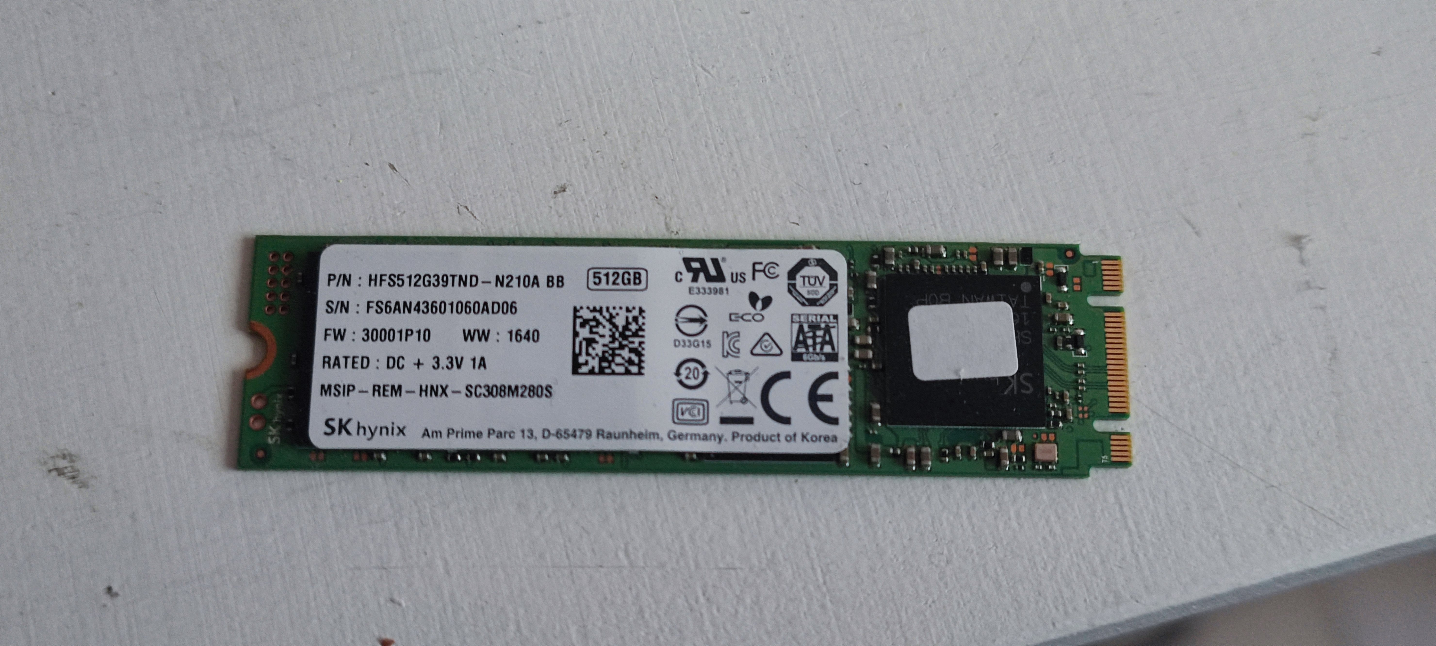

June 26, 20224 yr Author Sorry, this is completely my fault. I just shut it down again and opened it to see what the drive exactly is - and there is a lot to process for me. First off, you're correct. The 1 TB is not an SSD; in fact, it is my old HDD which I assigned for cache for some reason (doesn't make sense at all). I completely forgot about this drive... So I did not move the cache SSD, but my old 1 TB HDD which ran months as the cache. I am terrified that I did not notice this earlier. The disk, that was originally meant to be the cache, sat in the M.2 Slot. I removed it to inspect it, and it seems to have a capacity of 512 GB. Additionally, I booted Unraid after the removal to see what disk will disappear - none did. Either it's dead or something else is wrong with it. But that doesn't matter for now - It looks like we need to recover the data from this 1 TB HDD, which I apparently set as cache. Edited June 26, 20224 yr by manrw
June 26, 20224 yr Author 1 minute ago, manrw said: Image of the M.2 Drive: I suspect, that I accidentally set the 1 TB as cache, because it was the lowest capacity disk at the time (Which would make sense for SSDs). Obviously, I should have checked if this was the correct drive (it was not).

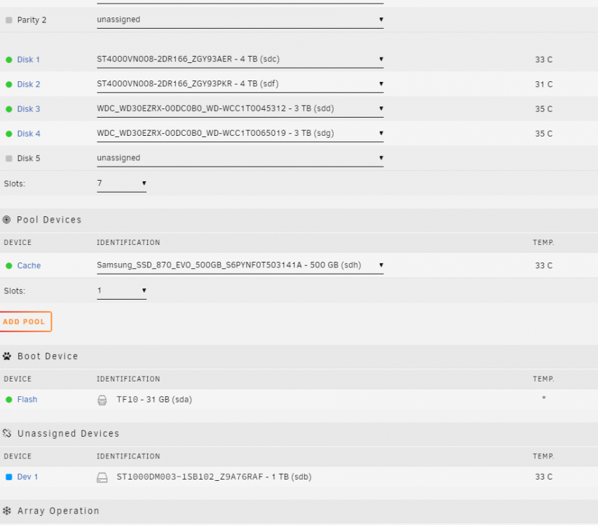

June 26, 20224 yr Community Expert Unassign disk5 from the array, start the array, stop the array, create a new pool or use the UD plugin to work with the old cache, do you know what filesystem it was? The primary superblock will be destroyed, but it might be possible to recover a backup superblock, alternatively use a file recovery util, like UFS explorer.
June 26, 20224 yr Author 10 minutes ago, JorgeB said: Unassign disk5 from the array, start the array, stop the array, create a new pool or use the UD plugin to work with the old cache, do you know what filesystem it was? The primary superblock will be destroyed, but it might be possible to recover a backup superblock, alternatively use a file recovery util, like UFS explorer. I unassigned disk 5 and started the array. I'll quickly download 35GB of the most important remaining data and will stop it when I'm done. Can you assist me later?

June 26, 20224 yr Community Expert Forgot to mention, that m.2 device is SATA, not NVMe, so it will likely share a standard SATA port, check board manual.
June 26, 20224 yr Author 1 minute ago, JorgeB said: Forgot to mention, that m.2 device is SATA, not NVMe, so it will likely share a standard SATA port, check board manual. Yes, I noticed that too! This is quite unusual, right? It is an M.2 drive from my previous pre-built OEM PC (it was not a great machine).
June 26, 20224 yr Community Expert 6 minutes ago, manrw said: This is quite unusual, right? Not really, both types are pretty common.

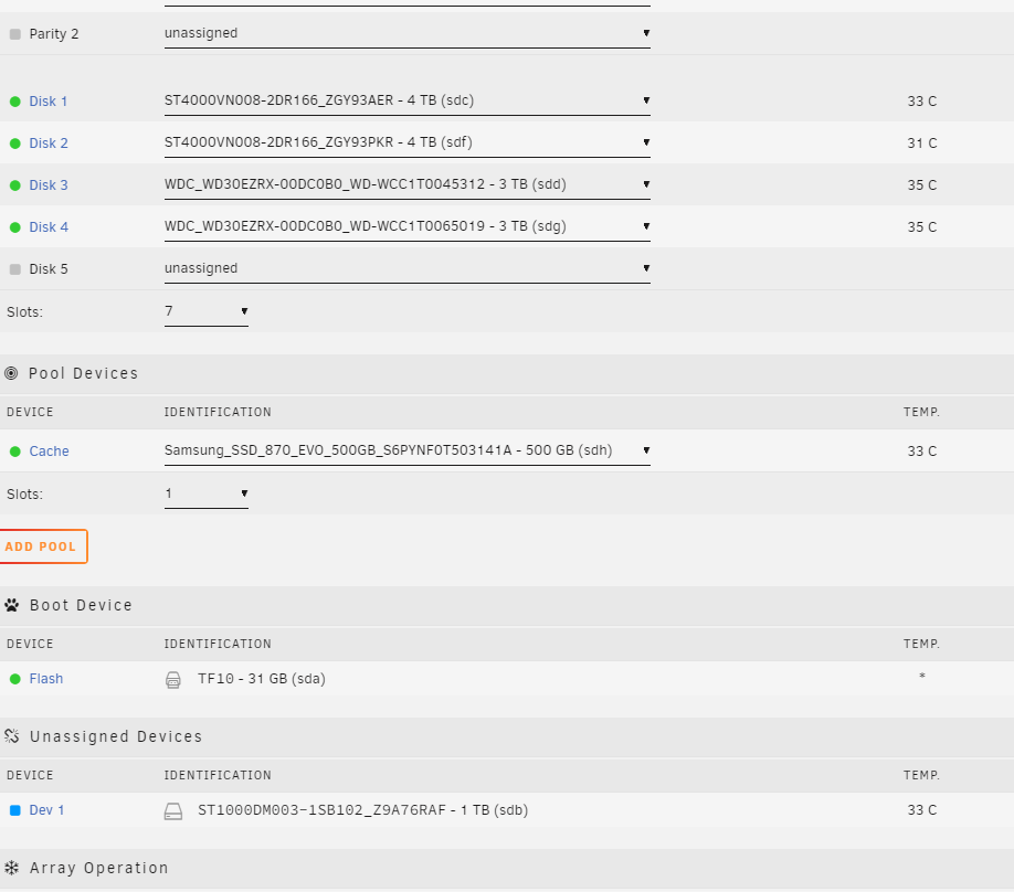

June 26, 20224 yr Author 2 hours ago, JorgeB said: Unassign disk5 from the array, start the array, stop the array, create a new pool or use the UD plugin to work with the old cache, do you know what filesystem it was? The primary superblock will be destroyed, but it might be possible to recover a backup superblock, alternatively use a file recovery util, like UFS explorer. I downloaded almost 100 GB of important data. I have stopped the array. The Disk 5 is unmounted. Let me know what I should do now Edited June 26, 20224 yr by manrw
