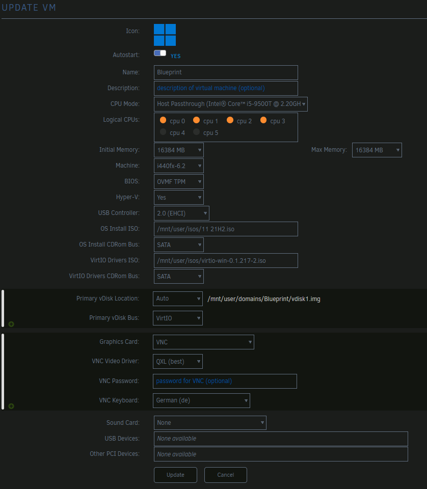

Hi all, I created Windows 11 VMs several times yesterday and noticed that the VMs are missing the NIC after creation. Do you know the problem?

There is also no NIC in the XML view
VM config is not showing the Network section, below the sound card, do you have any network bridges created?

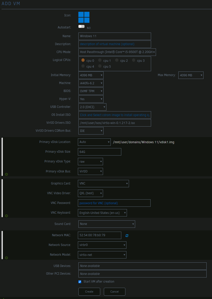

Have those configured
It wasn't showing in the first screenshot, also note that you have to bridge the NIC(s), e.g., br0,  to have Internet access on the VM.

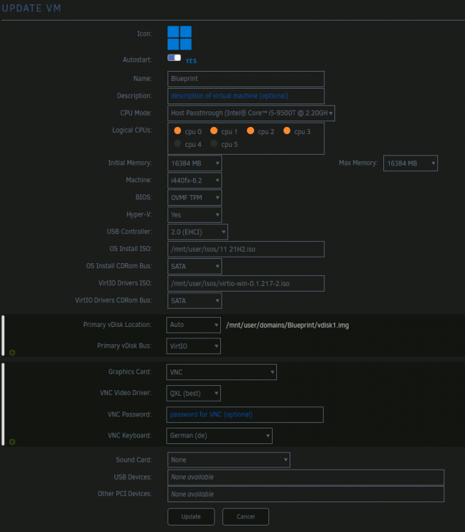

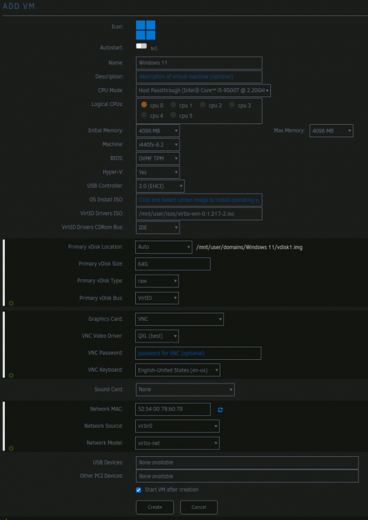

During the creation of the VM the NIC can be seen. However, the NIC disappears as soon as the VM is created
Enable bridge in network settings and then use br0 as the VM NIC.
Bridging is already enabled

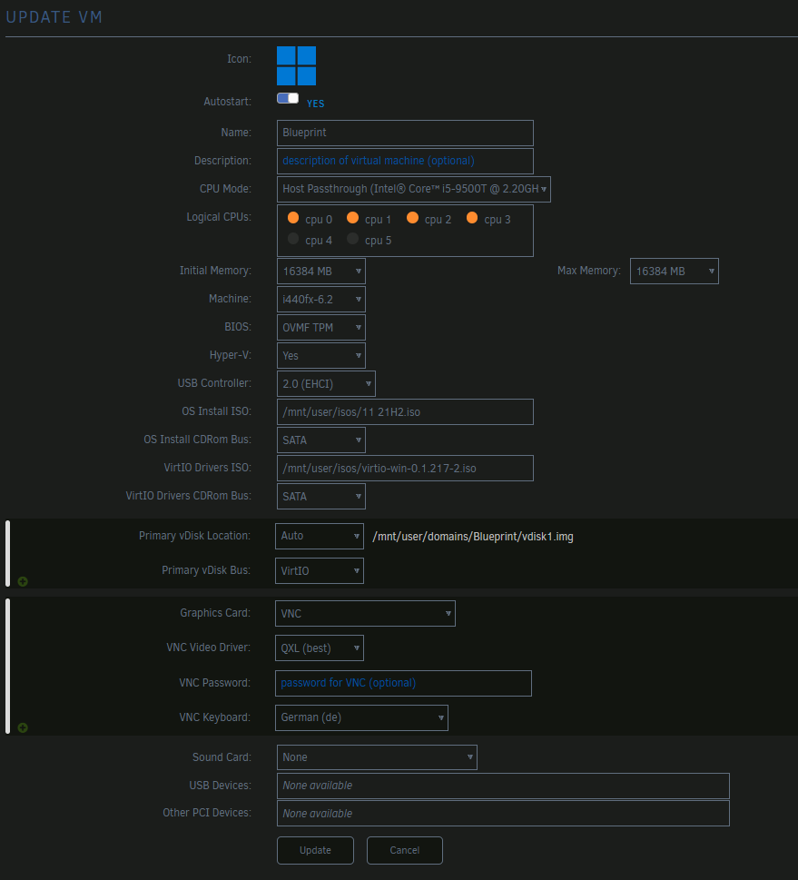

Then it should be showing here as an option.
I've disaabled and enabled bridging and now it works
