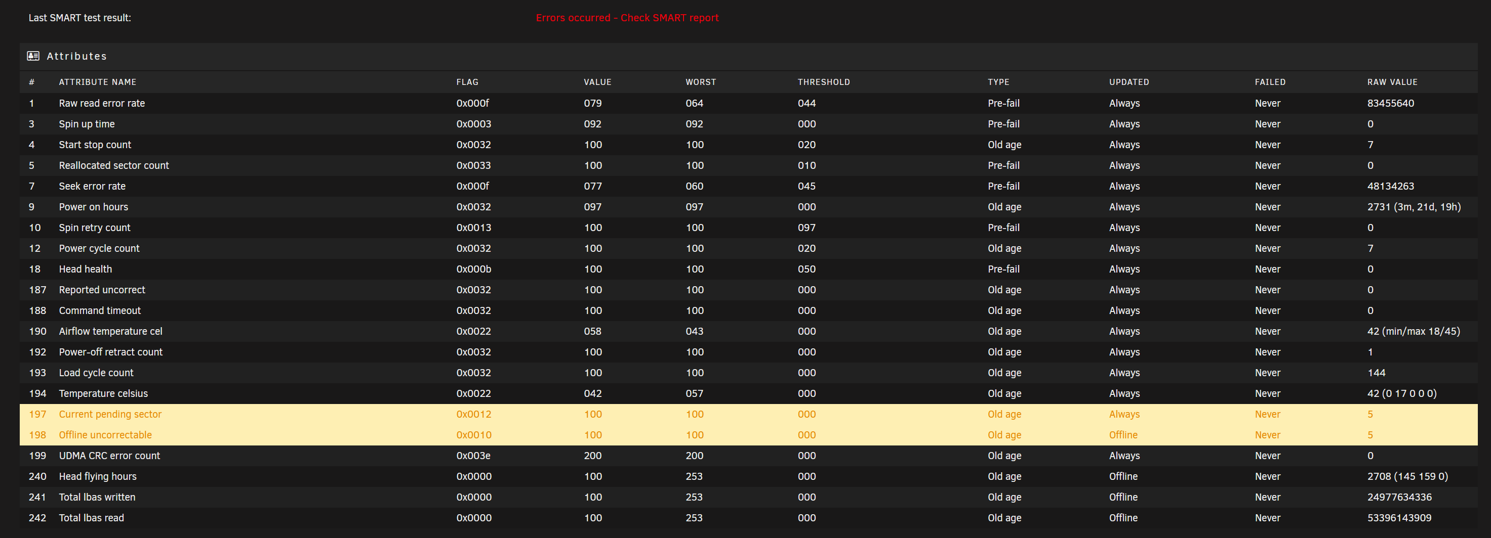

I keep getting SMART errors on my new server..   Are they cause for concern or is it the way Unraid reports Seagate Smart as seen in other posts.
I've added the SMART report for Clarity
Many thanks

Usually they are a case for concern, run an extended SMART test.
That was from the extended Smart test
SMART Extended Self-test Log Version: 1 (1 sectors)
Num  Test_Description    Status                  Remaining  LifeTime(hours)  LBA_of_first_error
# 1  Extended offline    Completed: read failure       90%      2731         1469660400
Replace
56 minutes ago, trurl said:
Replace
Yep, sorry, like you didn't mention running a test I didn't check, if a SMART test fails disk need to be replaced.
