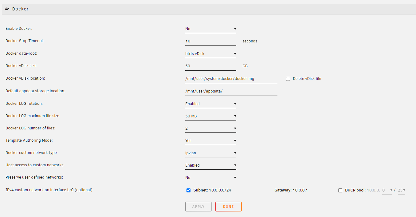

I changed from having a docker VLAN to combat the macvlan docker issue, and just used the new ipvlan issue to prevent crashing.

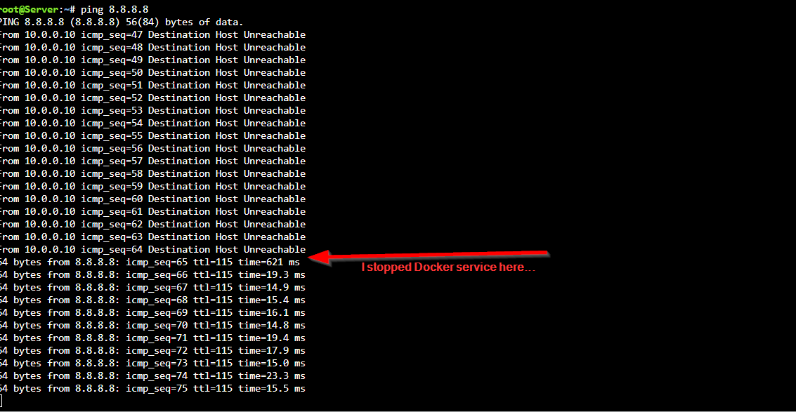

I am unable to ping known-good addreses, such as 8.8.8.8 or 9.9.9.9 I just get
From 10.0.0.10 icmp_seq=1 Destination Host Unreachable

During a ping test I stopped docker so I could check on some network configs to see if making any changes would resolve the issue, but it looks like just stopping the docker service itself corrected the issue.
EDIT: Here are my docker settings. Nothing unusual here that would cause this, and again it only seems to happen when I run a CA appdata backup where it stops all containers, backs them up, and then starts them again.

Swapped back to macvlan mode w/ a dedicated docker vlan for few containers that need static IPs.
so far issue has not resurfaced.
