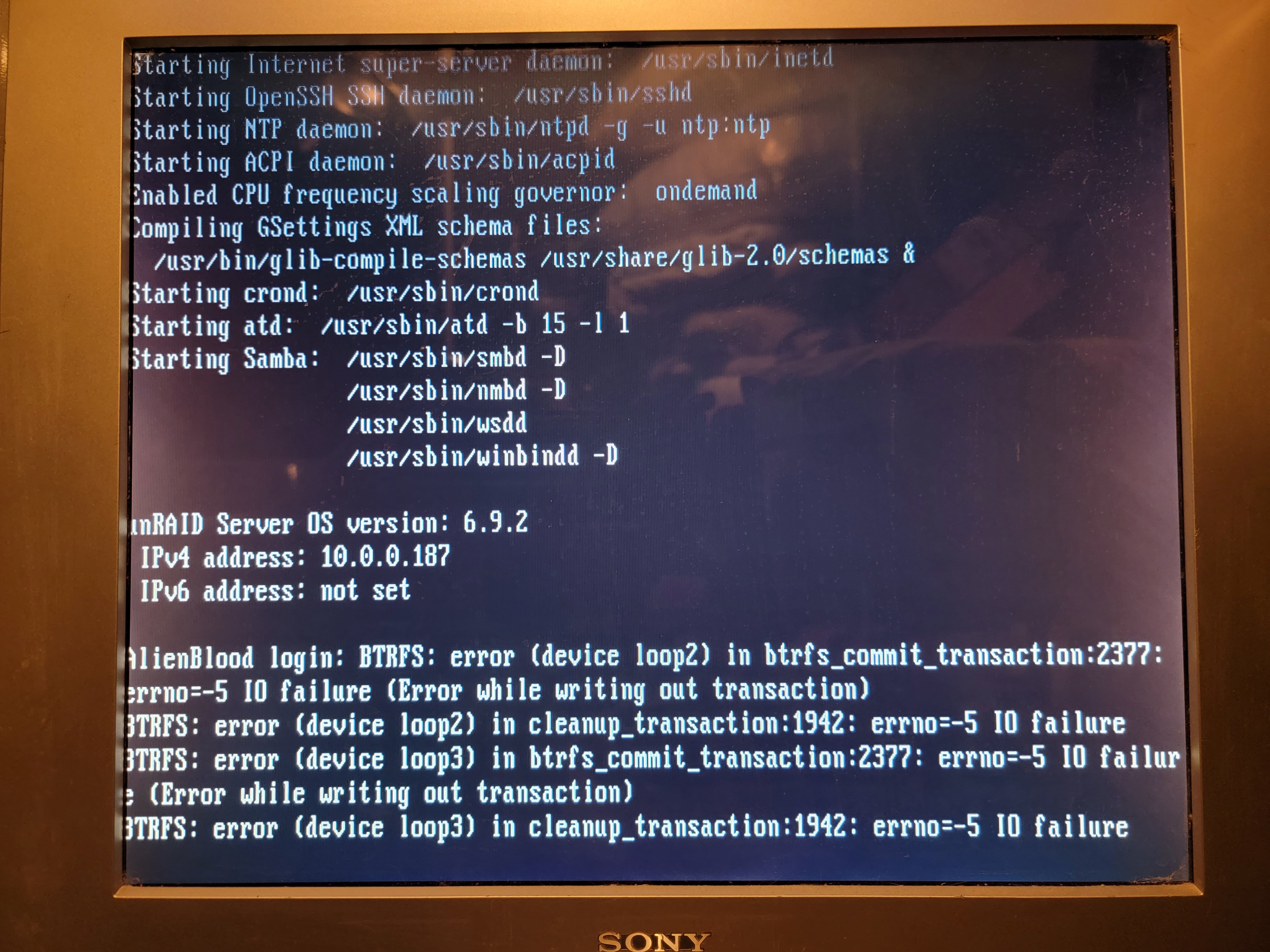

BTRFS: error (device loop3) in cleanup_transaction:1942: errno=-5 IO failure
I restarted my server earlier because I noticed it had been a while. It won't boot back up now.
Attaching a photo of screen.
Solved by trurl
Server appears to have started based on that screenshot, errors are likely a corrupt docker image, see if you can get the diagnostics using the console.
Okay, so I got it all started up and I deleted my Docker image. I've started the process of rebuilding it, but then I saw it was throwing the error of a disk missing which is one that I had fiddled around with and took out, but never removed from my array.
