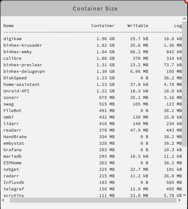

Go to Docker, click Container Size at bottom, post screenshot
Note that scrutiny is listed twice so I knew I didn't miss any lines.
I was pretty sure that my docker file was 30GB, and my memory didn't fail me!
If UNRAID says the containers only take 20.2GB, why is it reporting that I'm at 100% img file use when the image file is 30GB?

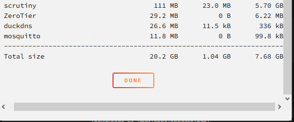

3 minutes ago, FreeMan said:
only take 20.2GB
You also have to add in the other 2 column totals. Looks like scrutiny logs are pretty large, see if you can do anything about that.
Since you have so many containers it wouldn't be unreasonable to increase docker.img allocation, but growth needs to be dealt with.
derp! That makes complete sense.
I see that now. I glossed over that one.
I'll see what I can do to trim those logs, and I may go ahead and up the img size, too.

Problem solved!
There was some sort of issue starting the docker and it was spamming the log with its startup info. Heading off to the LS.IO support thread, I discovered that as of June, 2022, the docker has been deprecated!
Since I hardly ever used it. I've stopped the docker and deleted the config.
I'm now at 23GB out of 30GB used, and should be good to go for quite a while.
