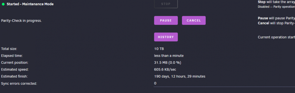

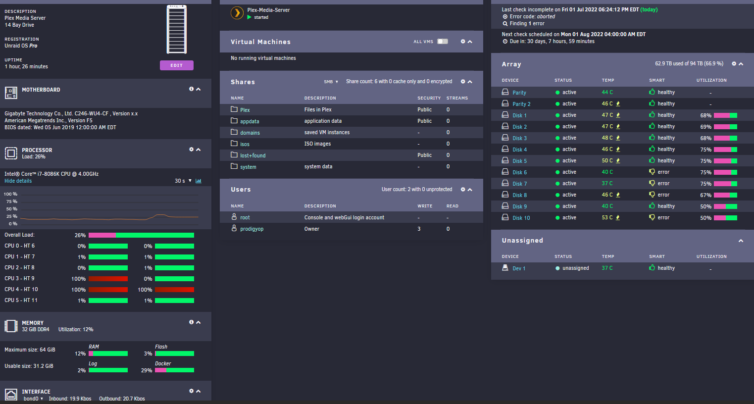

July 2, 20224 yr Hello, Its been quite some time since i posted and I thank the previous moderators for the help of the old case Seems that the Issue has come back without me changing any cables or anything, Parity disk are taking almost a whole 2 months to go through the scan and finish the parity checks. I want to replace two drives but this parity check prior to that is taking quite some time, I also wish to swap out the motherboard and change the cpu to see if that will improve things. I also noticed that there has been a huge change to my speed of transferring files, and it would sometimes just completely shut my plex out or freeze. Not sure whats going on. Also the disk that say error are working fine and the ones that are saying healthy are having issues Disk 2 and 10 are definitely having issues and I am planning on changing them soon. I want to make sure before swapping disk I have to complete the parity check? and then switch the disk? So pretty much 3 questions 1. Parity is taking close to 90 days to finish 2. Nothing was changed from the last time just updated here and there via docker so why is the parity taking long 3. How to properly change drives and what methods should i take? Also recommendations if i were to change the motherboard,cpu and drives would it be a huge problem? I
July 2, 20224 yr Community Expert From your sceenshot I would guess that you have a thermal problem. Also some of your disks are in error state (check the details, maybe accept them if the error source is harmless/fixed). Parity Check is the worst operation UNRAID can do to your disks. It is almost the only situation in real life where all drives are working together permanently. If they are packed tightly together like in a hot swap bay they heat up their neighbors too. UNRAID is clever, if it sees this potential risk of overheating, it pauses Parity Check for a while in the hope that the drives cool down again. Thats why it takes ages to finish. See if you can lower room temperature, add fans to the drive or find any other means of cooling them down. To see if my guess is correct you may test it before (AT YOUR OWN RISK! BE CAREFULL!!!) by raising the warning / overtemp temperatures in the drive setting. The UNRAID defaults are rather conservative, many drives can take higher temps (look into the data sheets). For a monitored test, raise the temps, start a parity check and watch it going. You can see the current speed in the START tab of the gui (and the temps too). If they go up too high, STOP THE CHECK instantly. But the speed until then should be rather high and fairly constant. If this is true think about FANS or air conditions or something. If not, sorry, you have different problem and should post the diagnostics here.

July 3, 20224 yr Community Expert Constant ATA errors on parity plus disks 4 and 8, check/replace cables, also note that Marvell controllers are not recommended.
