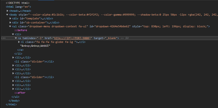

July 2, 20224 yr Author Hmm, if I inspect the actual link itself is it supposed to be literally the [IP]:[PORT] syntax?

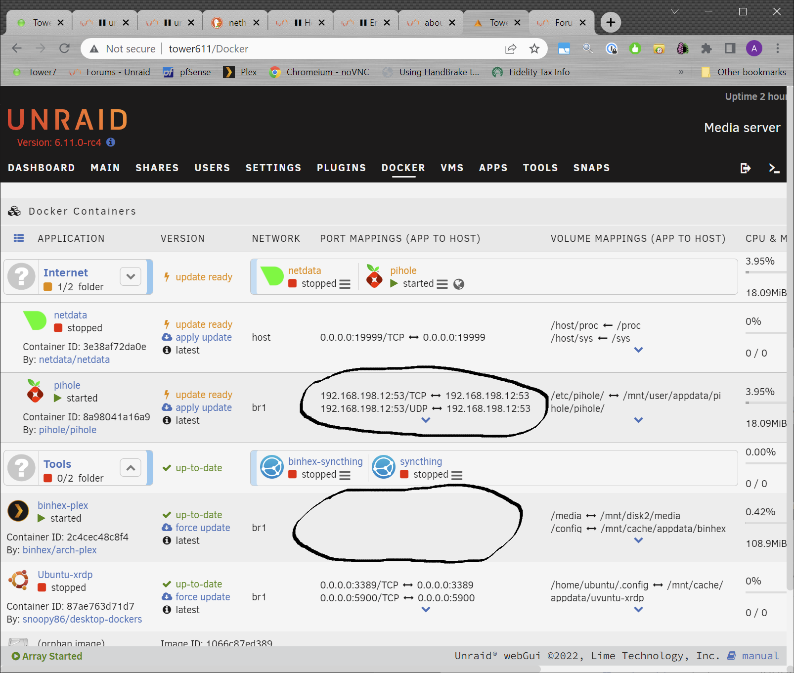

August 31, 20224 yr In the image below, both the successful pihole docker, and the about:blank#blocked binhex-plex docker are running on the same custom network, and have fixed ip addresses.

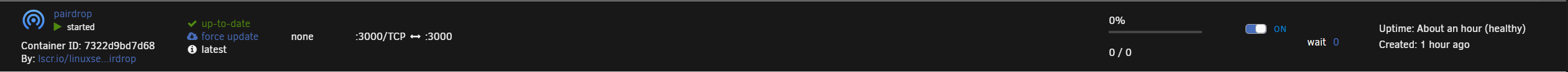

February 10, 20242 yr Finally got it figured out, going over Network Access again, I saw a little note saying network must be on "eth0"; lght bulb went off. I had taken apart my build again to add some fans and put it all back together & I hooked up my lan cable to the wrong port, its always the small things. Tim N
