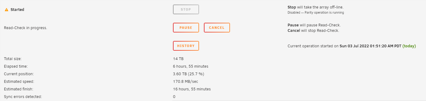

July 3, 20224 yr Author Thanks guys. I started a READ CHECK last night. Should I stop it and do the extended test?
July 3, 20224 yr Community Expert 18 minutes ago, taflix said: stop it and do the extended test? yes, you will have to disable spindown on the disk to get extended test to complete
July 4, 20224 yr Author 23 hours ago, trurl said: yes, you will have to disable spindown on the disk to get extended test to complete Okay, the READ CHECK was 25.7% done when I stopped it and it showed no errors. I started the extended self test, it probabl won't be done until tomorrow. It's at 50% since I started it 10 hrs ago. Happy 4th of July! 🧨 Edited July 4, 20224 yr by taflix

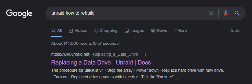

July 5, 20224 yr Author 11 hours ago, trurl said: That looks fine. Thank you. I've never rebuilt before. Is this the process? https://wiki.unraid.net/Replacing_a_Data_Drive Since the drive is fine and I'm not replacing the drive, what would the process be? Edited July 5, 20224 yr by taflix
July 5, 20224 yr 13 minutes ago, taflix said: Since the drive is fine and I'm not replacing the drive, what would the process be? Once you start the array with the disk unassigned, you can stop the array and assign the same disk back to the slot and let it rebuild. You just have to make Unraid see the drive as a replacement.

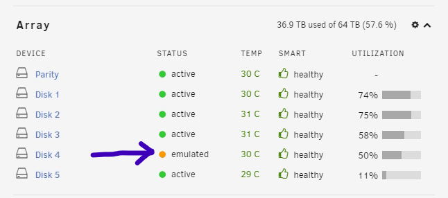

July 5, 20224 yr Community Expert Solution Your earlier diagnostics showed disabled/emulated disk4 mounted with more than 6TB of contents. You can examine the emulated contents if you want. The emulated contents is exactly what will be rebuilt. Assuming that is still the case, you can rebuild the disk to itself. Or you can rebuild to a spare if you have one and keep the original as is in case there are problems with rebuild. But should be OK to rebuild on top. Looks like you let google find an old wiki link. The current documentation is linked at the top and bottom of the forum, and in the manual link at lower right in your Unraid webUI. https://wiki.unraid.net/Manual/Storage_Management#Rebuilding_a_drive_onto_itself

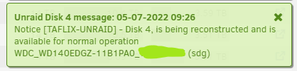

July 5, 20224 yr Author 2 hours ago, trurl said: Your earlier diagnostics showed disabled/emulated disk4 mounted with more than 6TB of contents. You can examine the emulated contents if you want. The emulated contents is exactly what will be rebuilt. Assuming that is still the case, you can rebuild the disk to itself. Or you can rebuild to a spare if you have one and keep the original as is in case there are problems with rebuild. But should be OK to rebuild on top. Looks like you let google find an old wiki link. The current documentation is linked at the top and bottom of the forum, and in the manual link at lower right in your Unraid webUI. https://wiki.unraid.net/Manual/Storage_Management#Rebuilding_a_drive_onto_itself Thanks sir! It is showing this: I'm not familiar with the concept of "emulated"? And those instructions are much better! The disk is now being reconstructed: Edited July 5, 20224 yr by taflix
July 5, 20224 yr Community Expert 13 minutes ago, taflix said: I'm not familiar with the concept of "emulated"? When a write fails to a disk in the array, the disk is disabled and emulated from the parity calculation. After it is disabled the physical disk is not used again until rebuilt. Reads of the disk are emulated by reading all other disks and getting its data from the parity calculation. Writes of the disk are emulated by updating parity as if the disk had been written. That initial failed write is emulated and any subsequent writes are emulated. Since the physical disk is no longer in sync with the array it is "kicked out". That initial failed write and any subsequent writes can be recovered by rebuilding since the data can be recovered by reading the emulated disk. And the emulated disk is exactly what will be rebuilt. While a disk is being emulated (and even while it is rebuilding), you can still access the emulated data (and even write new data), provided the emulated disk is mountable. That is why we asked you to check the contents of the emulated disk since that is what is being rebuilt whether it is mountable or not. Since your screenshot and earlier diagnostics showed the disk had contents (and so was mounted) everything should come out OK.
July 5, 20224 yr Community Expert If a disk is unmountable it either has not been formatted yet and so has no filesystem to mount, or it has a corrupted filesystem that can't be mounted and needs repair. This is true whether the disk is "active" or emulated as shown in your screenshot. If an active disk is unmountable, the filesystem is repaired, and if an emulated disk is unmountable, you can repair the emulated filesystem before rebuilding (recommended) or after rebuild. Note that rebuild will not fix the corrupt filesystem, it will rebuild exactly what the emulated disk has even if the emulated disk has a corrupt filesystem.

July 5, 20224 yr Community Expert 3 hours ago, taflix said: Thank you. I've never rebuilt before. Is this the process? https://wiki.unraid.net/Replacing_a_Data_Drive Since the drive is fine and I'm not replacing the drive, what would the process be? There is a lot of out-of-date information in the wiki (although it is largely correct). You should if possible always use the the official online documentation accessible via the ‘Manual’ link at the bottom of the GUI. The relevant part is this
