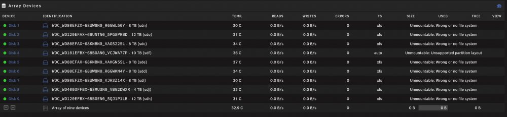

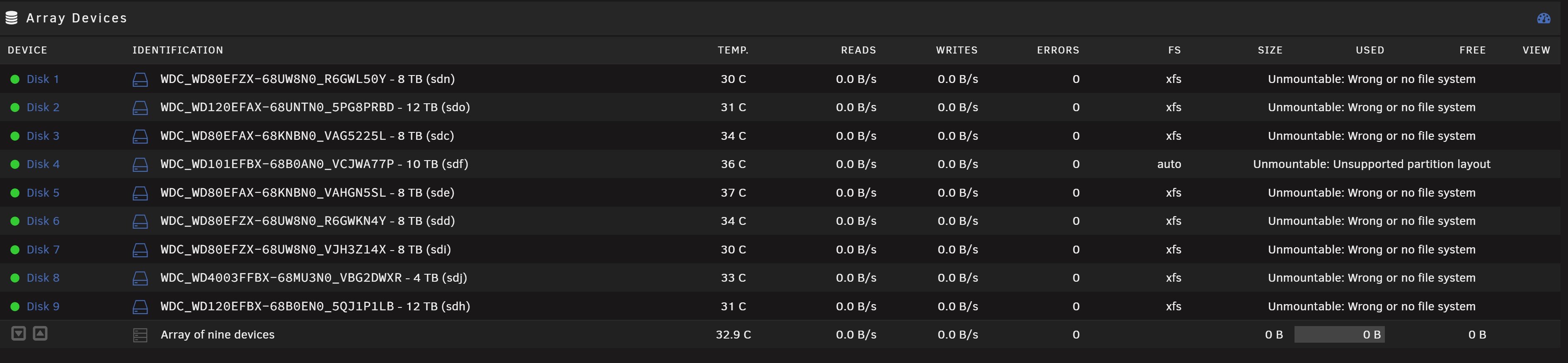

Immediately saw this:

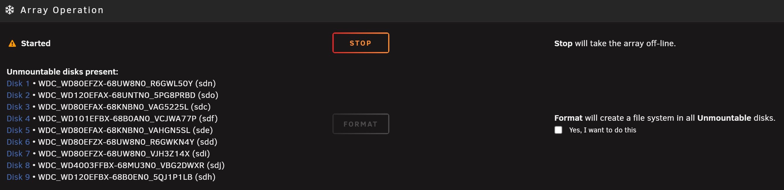

I scrolled down to then find unraid wanting to format ALL of my data drives:
The disk I added is Disk 4. It was precleared and I even verified that the preclear signature was there using the Preclear plugin before adding the disk to my array since some time had passed and I couldn't remember if I precleared that specific disk.

I freaked out and immediately stopped the array. I never clicked on the checkbox to format the drives.
After stopping the array and trying to unassign the disk I just added, Disk 4, unraid showed an error stating that Disk 4 was missing and the button to Start the array was grayed out because of 'Too many wrong/or missing disks'.

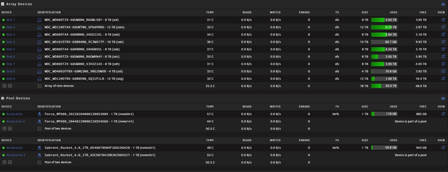

After restarting my server, unraid correctly showed only Disk 4 as unmountable and gave me the option to Format only that disk.
I formatted the disk and it appears there was no data corruption on the other disks.
