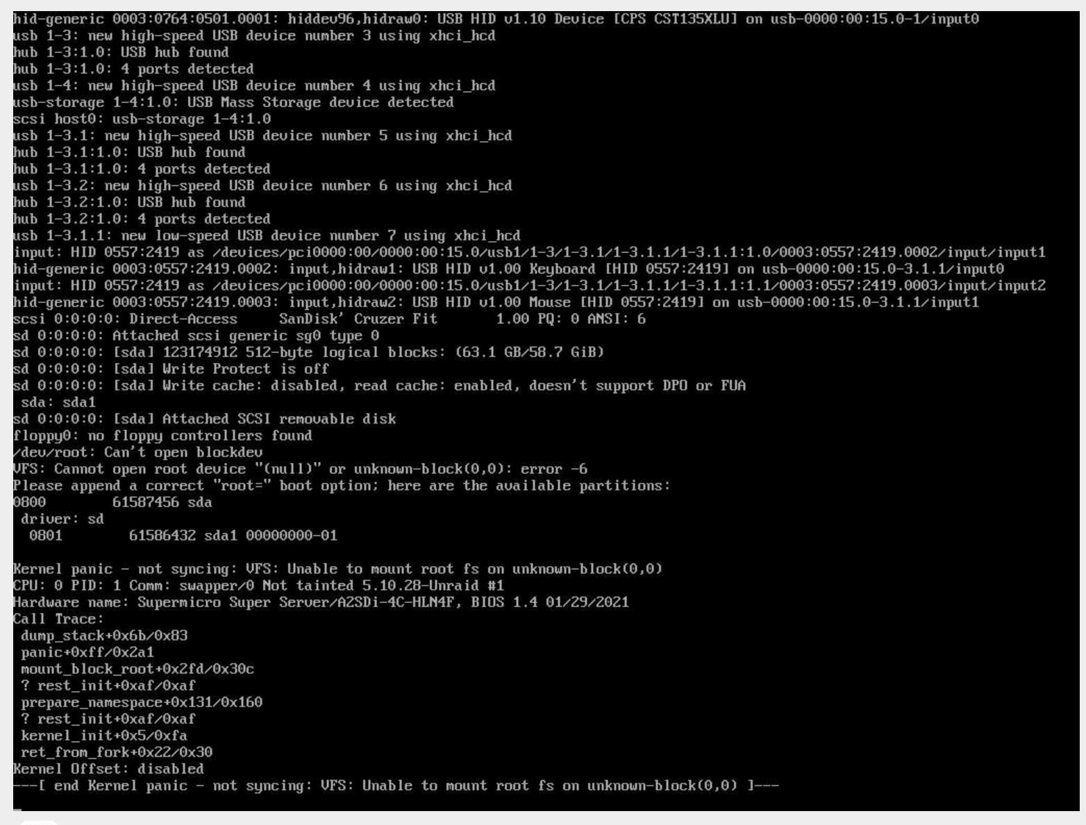

I did a normal power down on this UnRaid box and when booting back I get this?  It won;t boot at all. I can see this in the IPMI interface. Any ideas? Corrupted USB boot drive? /dev/sda?  How do I recover from this?

That's usually a flash drive problem, backup current one and recreate it manually or using the USB tool.
Thanks Jorge. Well, how do you backup the current USB if is not booting ?  Use another linux system perhaps?  I don't want to blow the config from the original USB, correct?  What do I restore from the backed up USB drive?  Never went through this process before.
And I just realized, to make matters more difficult the boot USB drive is on the motherboard so I need to take this sucker apart :( Any specific file I could copy over from a healthy boot USB drive and get this going?
You can use a Windows PC, just copy all the contents, though what really matters is the config folder.
  • DivideBy0 changed the title to (SOLVED) UnRaid 6.9.2 won't boot - what's next?
Turned out to be a bad / busted / failed USB drive :(
