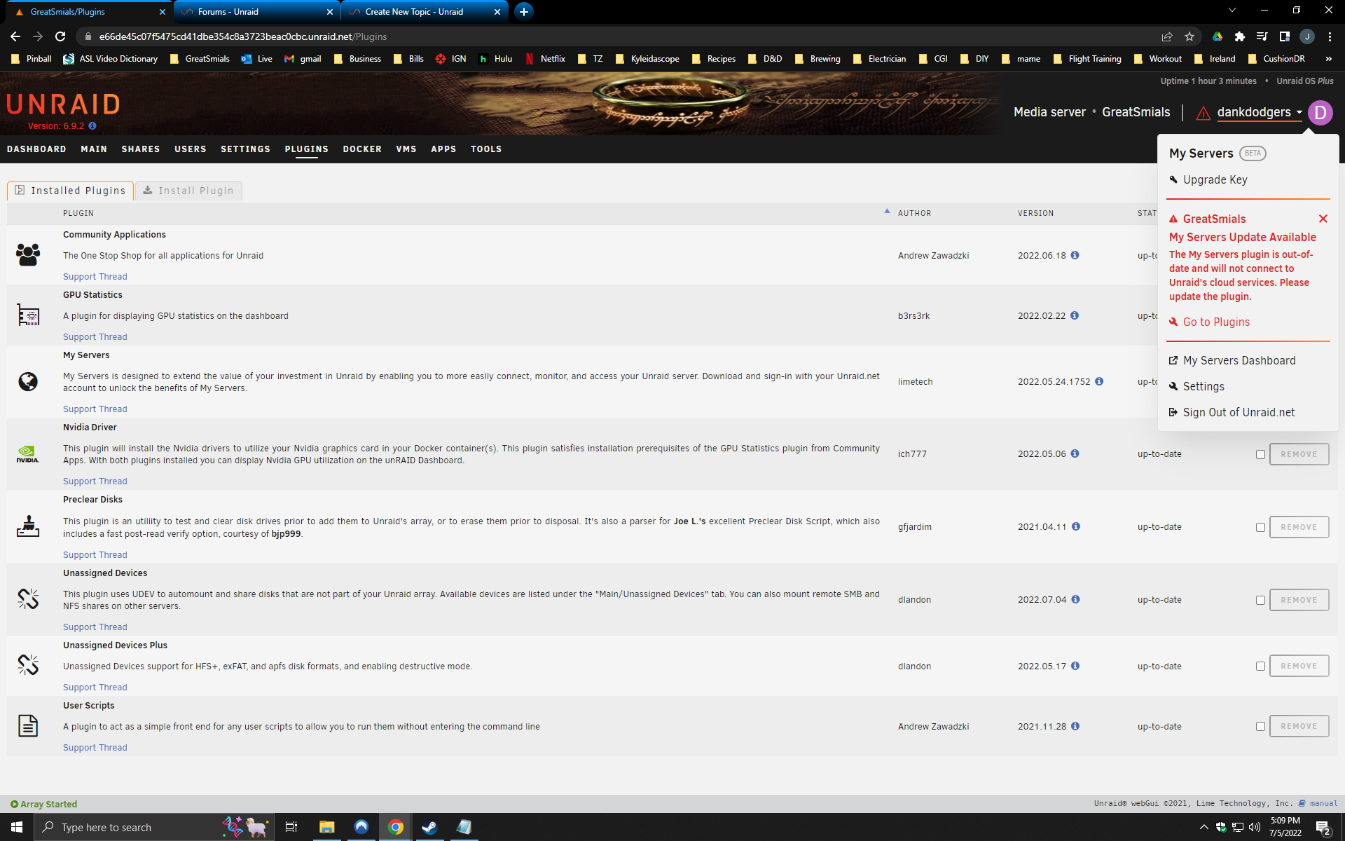

July 5, 20224 yr Starting a few weeks ago (or at least thats when I noticed it) I get a message saying My Servers needs to be updated. It will no longer let me access my server online now. I've gone to the plugins tab multiple times and tried to update. It always tells me it's up to date! I've restarted the server, tried unistalling and reinstalling, gone into every setting I can find, deleted my flash backup, logged out and back in... and nothing!!! Message is still there. I'm kinda at a loss guys. Anybody else run into this?
